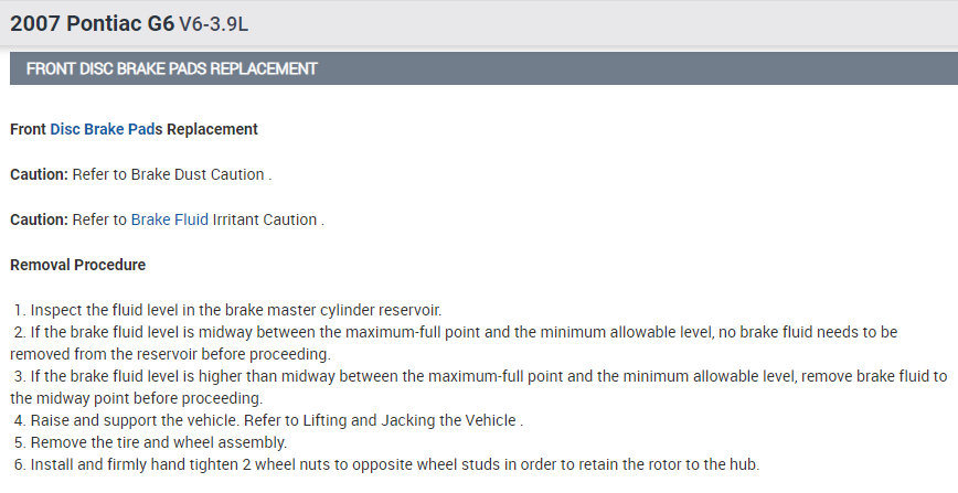

Should I get more than 32K miles on the front brake pads and do they wear out fairly evenly? I had to replace them and was told it was normal. I think something else has caused this I have never had to replace brakes before replacing the tires.
Jul 16, 2009 at 9:00 AM
DANNY L
  • 5,648 POSTS
Hello, I'm Danny.

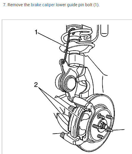

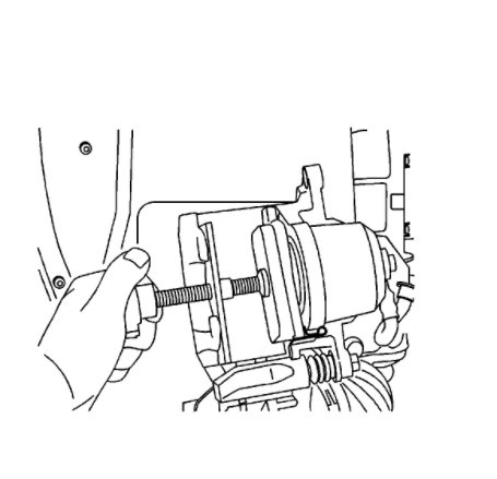

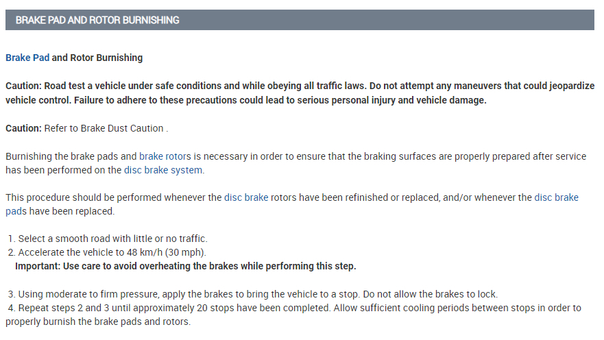

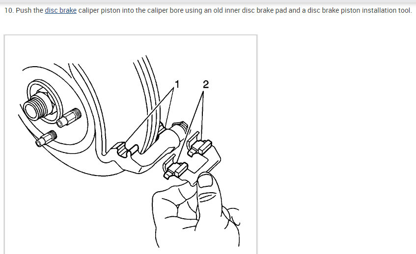

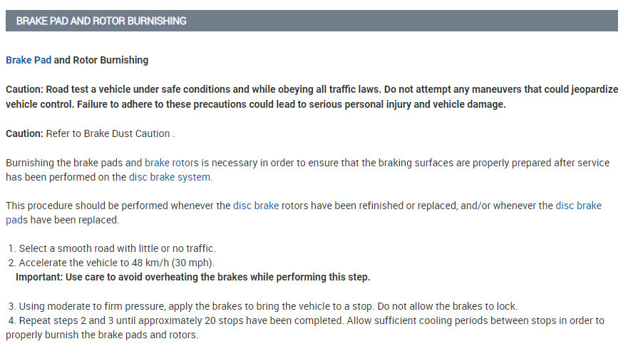

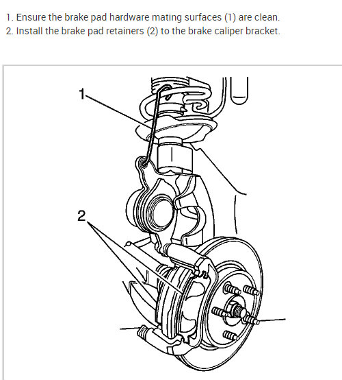

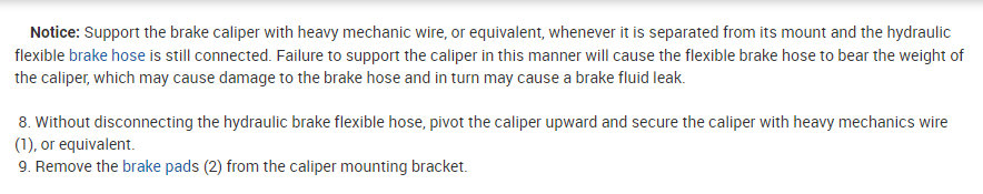

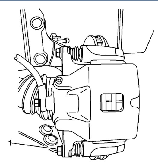

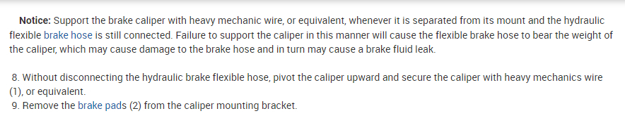

Depending on how extreme the brakes are used 32,000 miles for brake replacement is normal. Front brakes never really make it longer the 40,000 miles without replacement. Here is a tutorial showing front brake pad replacement:

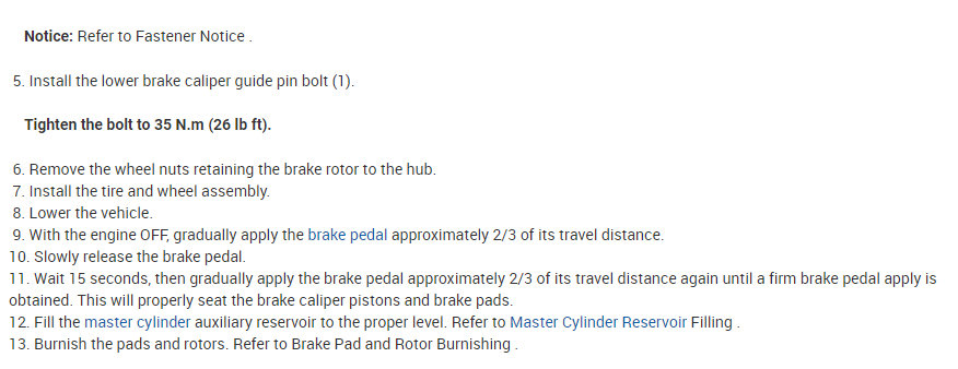

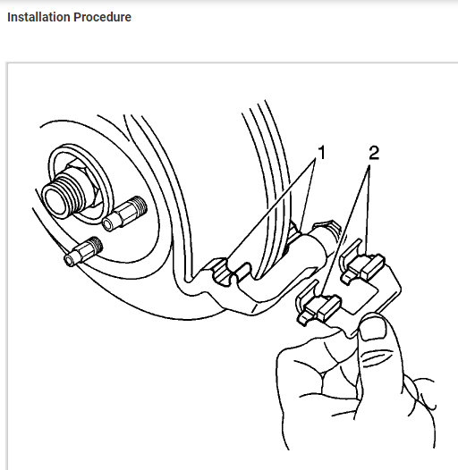

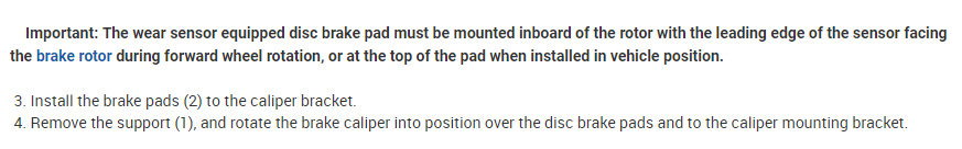

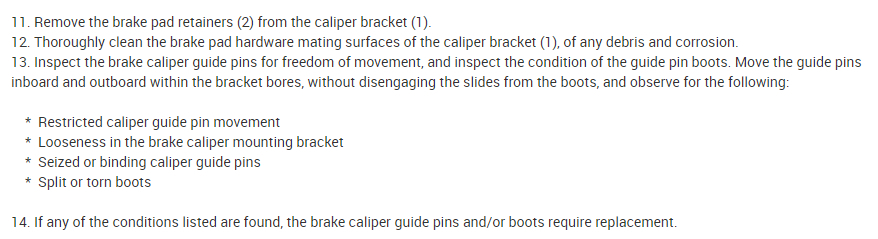

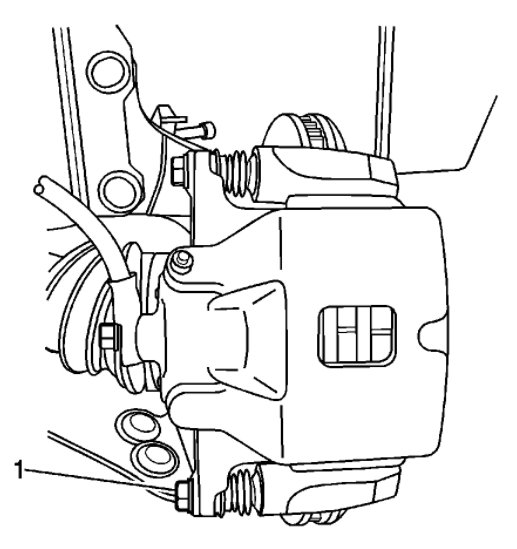

I've attached picture steps below for replacement of the front brake pads including the burnishment procedure on your vehicle. Hope this helps and thanks for using 2CarPros.
