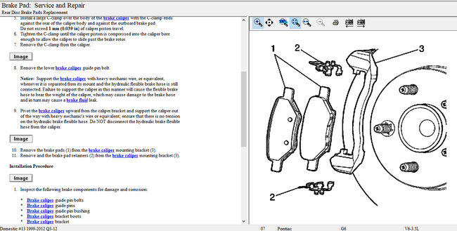

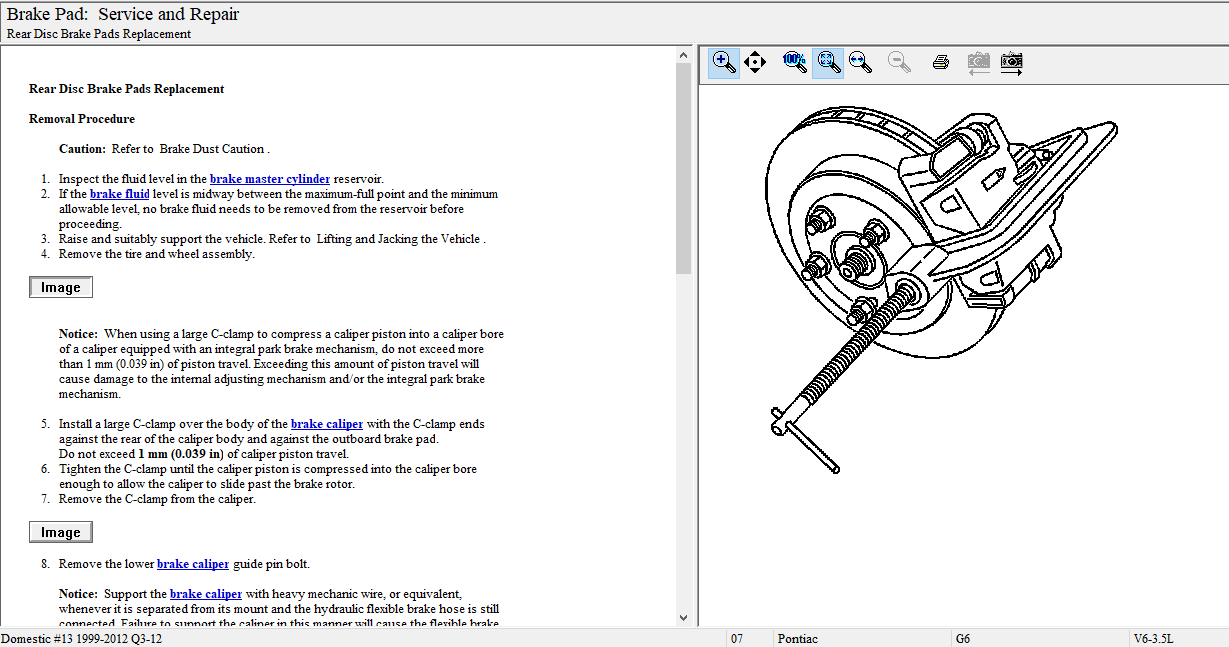

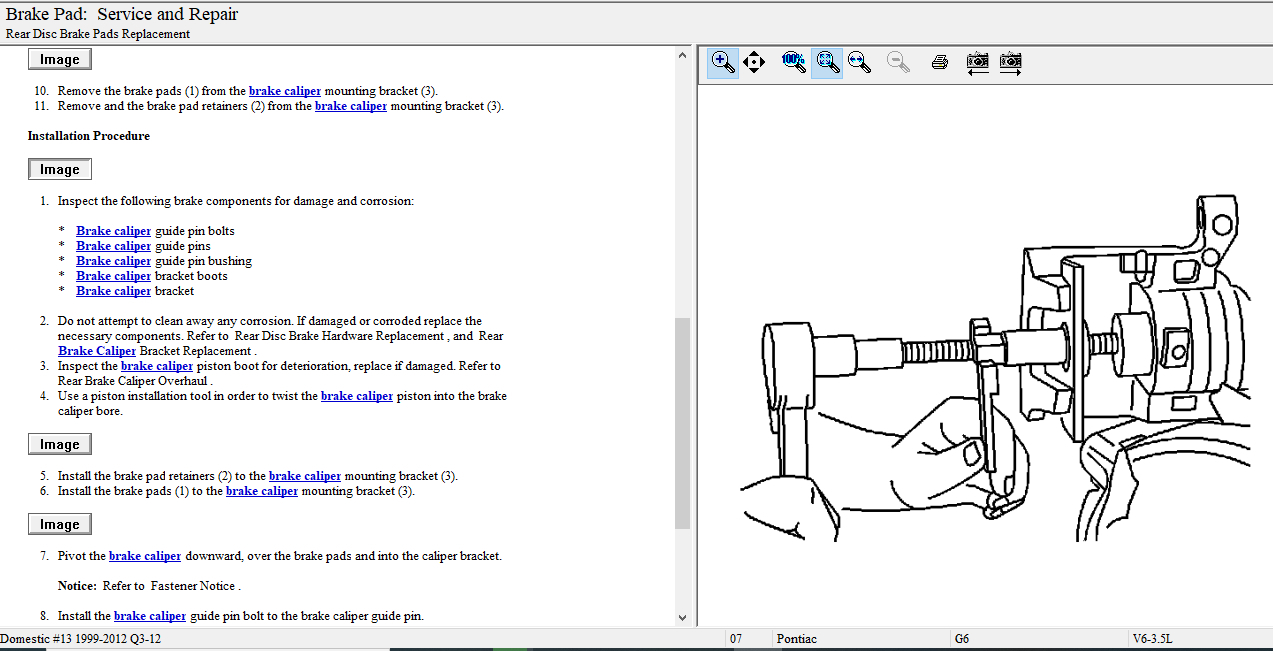

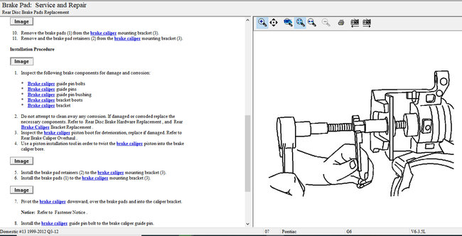

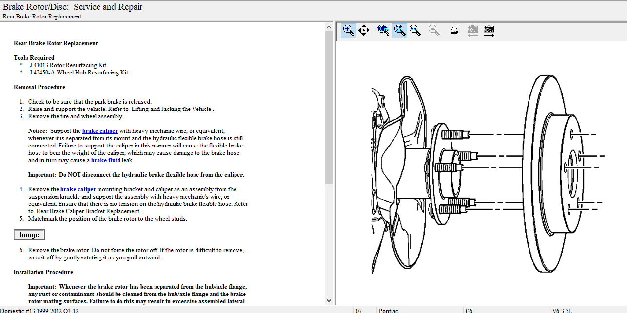

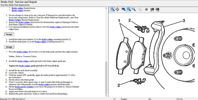

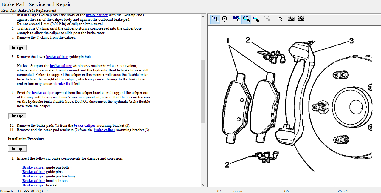

The calibrator will not go far enogh in for me to put the new ones on.
Saturday, November 7th, 2009 AT 5:33 PM
SEVAG P
MECHANIC
405 POSTS

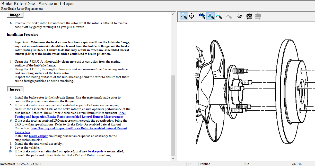

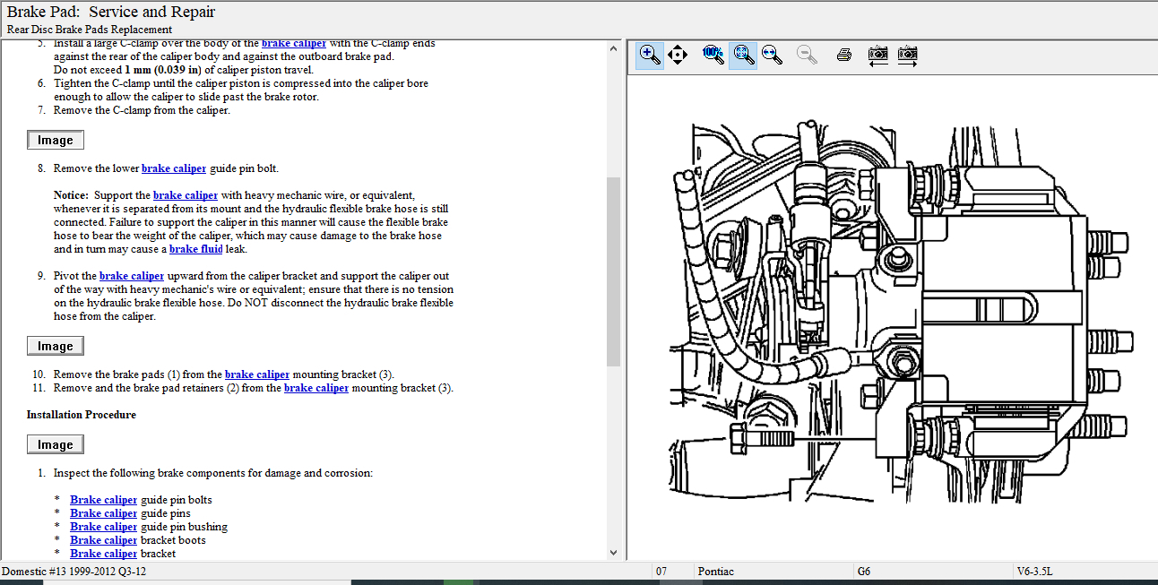

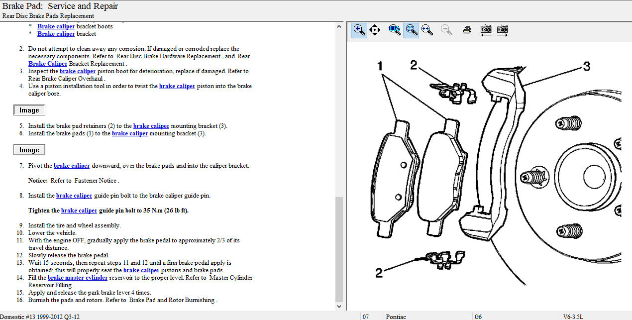

Hello.
you can use C clamp to compress caliper piston.
check our link below how to replace rear brake pads and discs.
https://www.2carpros.com/articles/how-to-replace-rear-brake-pads-and-rotors
Check the diagrams below procedure specific to your vehicle for brake pads and discs replacement.
hope these help.
