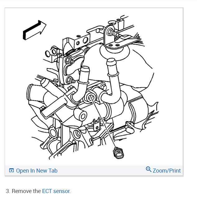

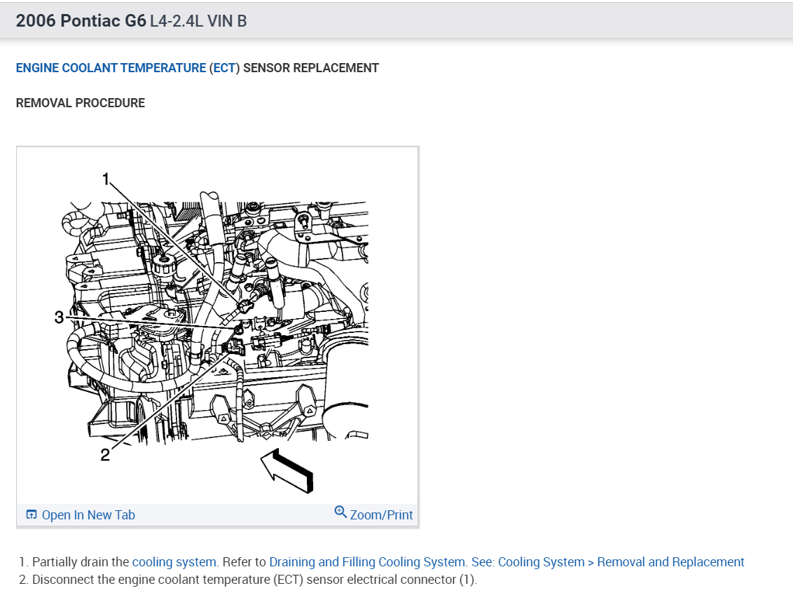

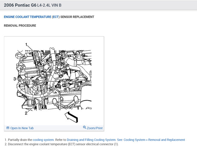

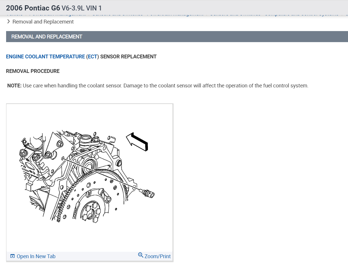

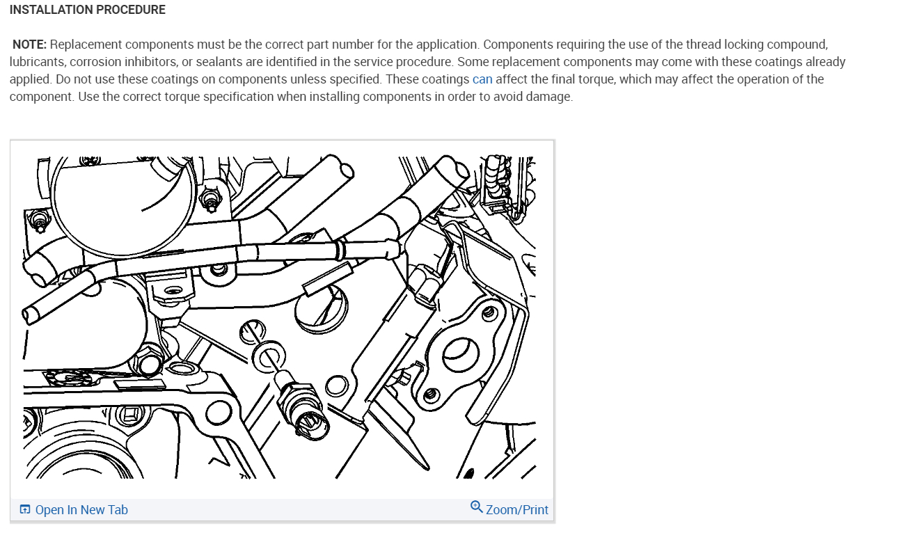

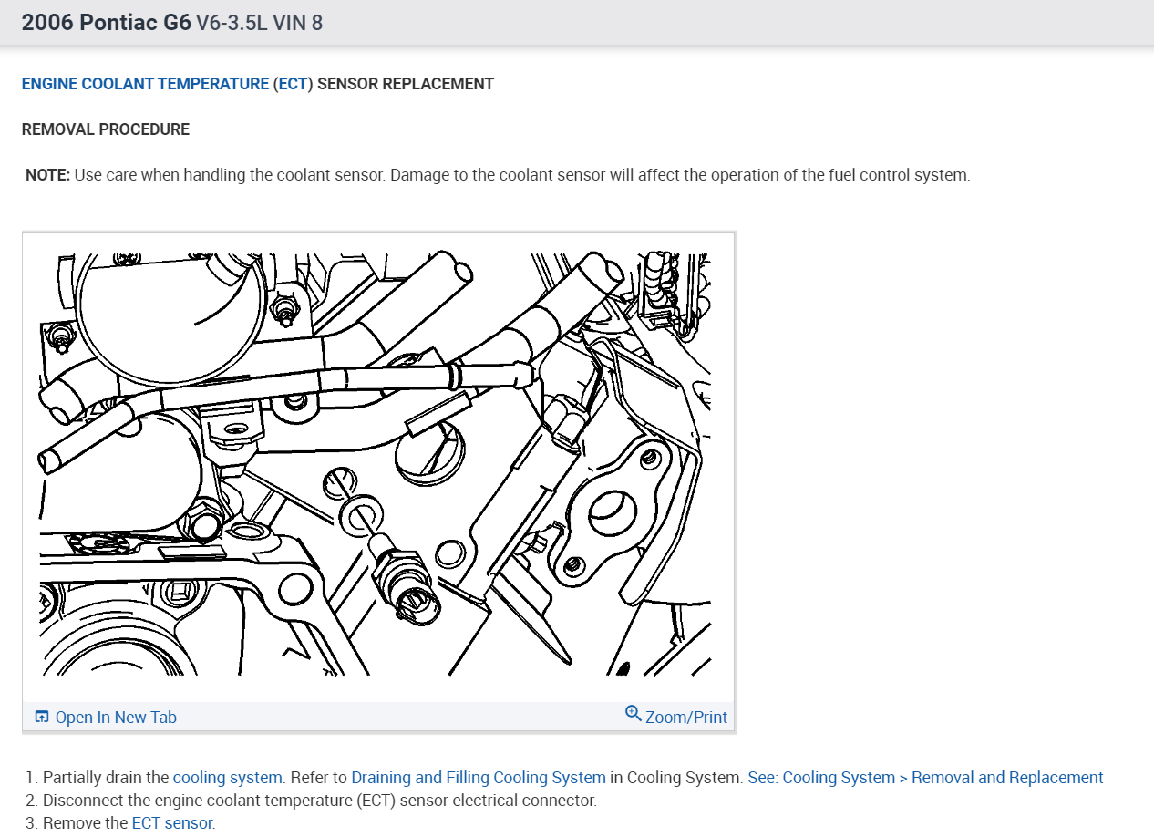

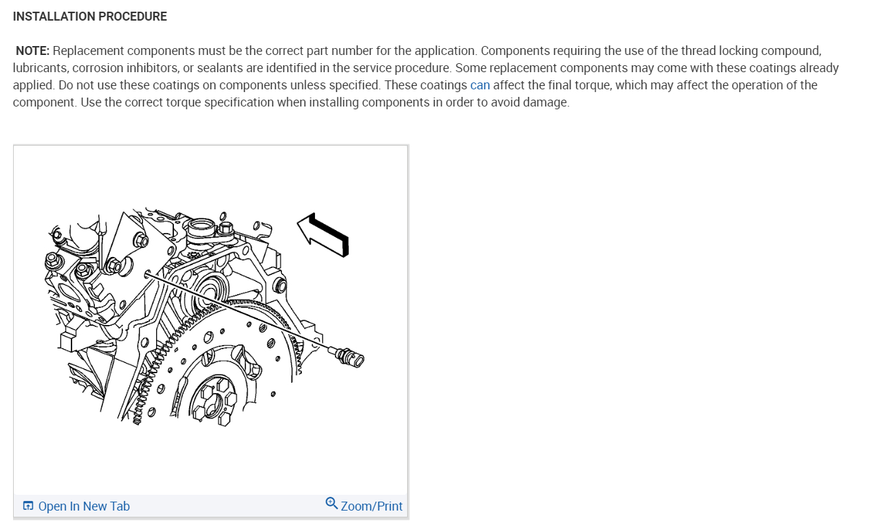

Where is the coolant temperature sensor located on the 2006 Pontiac G6?
Dec 12, 2009 at 1:10 PM
  • 110,194 POSTS
This car came with three different engines so there are three different locations, here are all three to avoid confusion. Check out the images (Below). Please let us know if you need anything else to get the problem fixed.
