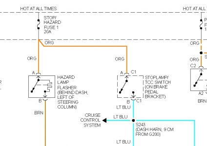

My batttery was dead so I got a jump. The battery was dead for a while. Now my brake lights don't work. My dash is out and the brake lights(running lights) don't work when the lights are on. Hazards don't work either but when I turn the blinkers on they work. I loked at the fuses and they look ok unless I didn't check the right one. Could it be a bad wire or transistor?
