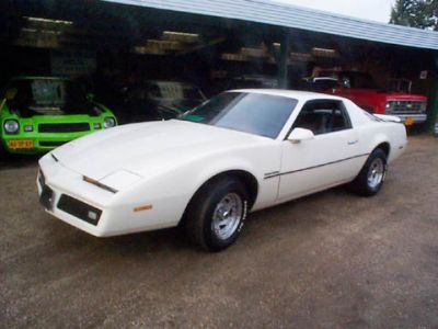

1983 Pontiac Firebird 6 cyl Two Wheel Drive Automatic
When i turn on the egnision de brakelights work but when i have started the car the dont work any more
http://www.2carpros.com/forum/automotive_pictures/424492_firebird2083gr_1.jpg

Welcome, nice looking ride. I'd have to check the wiring circuit. Orange wire at brake switch is hot all the time, protected by stop/haz fuse 20 amp. The white wire from brake switch goes hot when you step on the brake. From the brake switch that circuit goes to the turn switch. Did you check voltage and ground at the rear?
