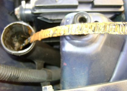

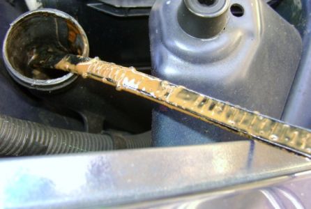

Ok..check it out. I just went to go take my wife to work and noticed it stalling now when I take turns. I turned out of my parking lot and it bogged down, went straight down the road, no prob. Turn into her place and it bogged and stalled. Started right back up. Turned out of her parking lot, it bogged. Went straight, no prob. Turned back into my parking lot, bogged then stalled. Does that mean anything different now. Also check out these photos of the engine coolant dip-stick. This can't be good.
https://images.2carpros.com/forum/automotive_pictures/420988_DSC00624_1.jpg
https://images.2carpros.com/forum/automotive_pictures/420988_DSC00625_1.jpg
https://images.2carpros.com/forum/automotive_pictures/420988_DSC00623_2.jpg
Oct 24, 2009 at 9:23 AM
RACEFAN966
  • 5,029 POSTS

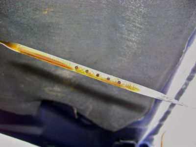

Check the oil too. This looks like there is oil in the antifreeze and I am hoping that there is no antifreeze in the oil. Include a pic of the engine oil dip stick too please. Thanks.
Oct 26, 2009 at 2:19 PM
REISSGANG
  • 12 POSTS
Noprob..will take the pic tomorrow, but I just checked the oil and it is clean, unless you can see something that I don't know to look for. I'm starting to think it's the fuel pump. When I changed the fuel filter, I didn't depressurize the line. The gas in the line just dripped out. Shouldn't there have been pressure in it?

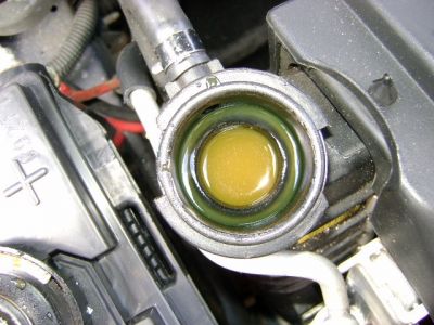

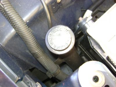

Yes it should have had some pressure so I would agree with the fuel pump suspitions. Now as for the engine coolant did you mix red with green antifreeze? If so then you you will need to clean and drain and refill I would use green antifreeze once it is flushed. Now I would also like to know if this is an auto or stick? If auto check transmission fluid too. If the oil doesn't look like chocolate milk then no worries there.

I never did anything with the coolamt/antifreeze. When I pulled that di[stick, that was the first I ever looked at it. I took a pic of my oil dipstick and the radiator without the cap on so you can see. The transmission fluid is nice and pink/red. No probs there. Let me know if ya think I sould still flush the radiator. But I thin k the stalling is definitley the fuel pump. I take it you agree?

Ok I would say everything looks good except the antifreeze. I would flush it and change it, it looks like it needs it as it looks like someone has mixed antifreeze colors and I would use the green. This isn't related to you running problem I still think that fuel pressure needs to be checked as I am leaning toward the fuel pump on that problem. On the transmisson fluid is that more orange then pink? Hard to tell in the pic. If it is more orange then it is due to be changed too. Let me know how it goes with the fuel pressure check.
