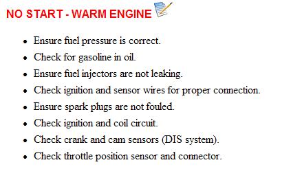

Test and inspect following components/systems:
https://www.2carpros.com/forum/automotive_pictures/261618_Noname_415.jpg
Post results and I will follow up.

RIVELLATION
  • 12 POSTS
The fuel pressure is ok
The oil change was made 2 weeks ago
I did not check the injector
The ignition wire are connected perfectly
The spark plugs are brand new
The rest seems fine I notice that it is only happening when after a long drive. Maybe the problem is relate with the radiator.
