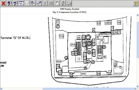

Got an 89 firebird formula. The fan doesnt come on and after 30 min she is over heating. I replaced the fan motor today and it still doesnt kick on.
Can you tell me what other components should I test in my troubleshooting this. Fuse, relay, can you describe where they are located

Check and test the cooling fan relay, see item no.8 coolant temperature sending unit/gauge at N5
