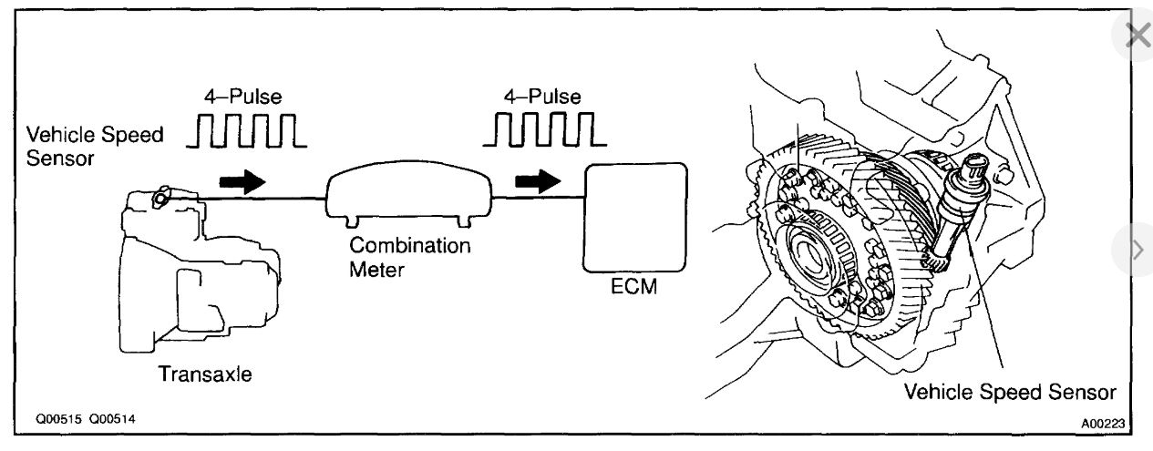

Good afternoon,
The sensor is on the transmission by the outlet of the axles from the transmission.
I attached a picture and description of the code for you.
CIRCUIT DESCRIPTION
The vehicle speed sensor outputs a 4-pulse signal for every revolution of the rotor shaft, which is rotated by the transmission output shaft via the driven gear. After this signal is converted into a more precise rectangular waveform by the waveform shaping circuit inside the combination meter, it is then transmitted to the ECM. The ECM determines the vehicle speed based on the frequency of these pulse signals.

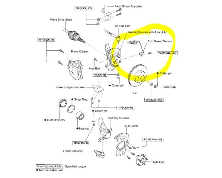

Only other picture I can find.
Hope this helps.
