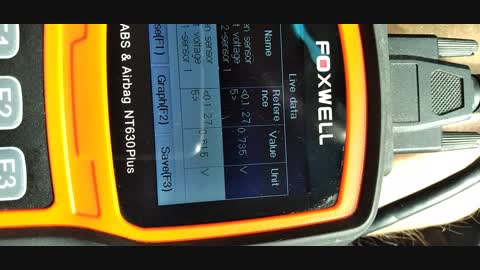

Can you show me the graphs for the 2 front Oxygen sensor graphed voltages only, not the fuel trims, so oxygen sensor Bank 1 Sensor 1 voltage, and oxygen sensor Bank 2 Sensor 1 voltage after warming up when you notice this drop to 0 volts. And on the graph show the point at where they drop and go to from 0.8volts to 0volts. I know your scan tool may read Oxygen sensor STFT %, but I need to see the voltage readings. And in a separate picture the live engine data after warming up at idle. I can't tell what's happening unless I can see what the ECM is seeing.

This is after warmup o2 sensors are at operating temperature. Could the vapor canister purge valve give me this problem only thing I haven't messed with, that is past the MAF.

That scan data is extremely slow, those Oxygen sensors are fluctuating much faster than what you are seeing on that screen. Yes, the purge valve can cause a lean condition, if its sticking open, once it's purged all the vapors out of the canister it will be pulling straight oxygen threw the canister vent valve which is normally open. If the canister failed and the charcoal pieces broke apart, they get stuck in the purge valve and keep it open. Try unhooking one of the lines to it and blocking it off. There seems to be sections of the oxygen sensors that are hanging both rich and lean, the upper one on the screen was much slower. But cylinder misfires can cause that as well. When a cylinder misfires, raw fuel and oxygen go down the exhaust, and since an oxygen sensor can only read oxygen, it can send the system rich, just increasing the issue.
If you don't find any more vacuum leaks, then start thinking about clogged injectors, fuel filter, weak fuel pump, bad fuel pressure regulator. All those faults will cause the ECM to enrich the mixture due to a lack of fuel. Your fuel trim numbers are very high, pretty much at the max level.

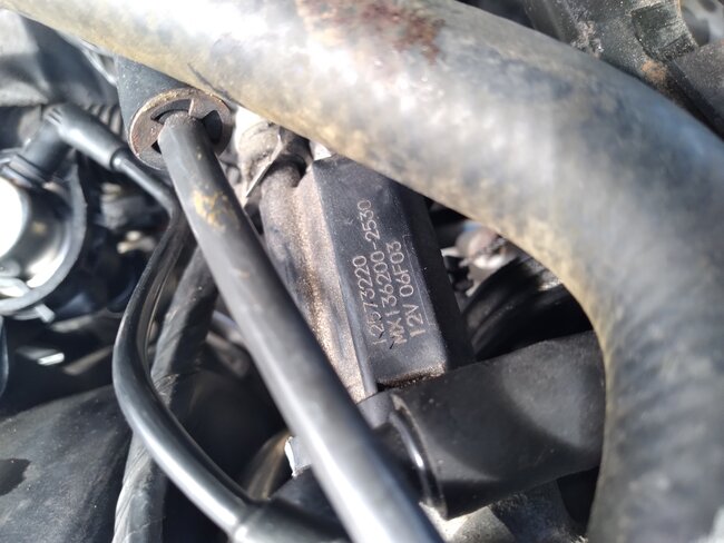

The fuel tank was almost empty, filled up last night for laughs and giggles plugged in scanner. Stft dropped to low teens to below 10 will try isolating vacuum on cannister purge today and see what happens. It's plugged directly into intake.
Thursday, June 22nd, 2023 AT 4:37 AM
RHIGGI
  • 18 POSTS
Yea, cannister purge solenoid is bad, got less than 10 on both banks after hose disconnect and blocked even - #s on stft after warmup. Ordered replacement. Again, thank you for your patience and help, do you take donations? Worth it to me I will tell anyone how great you have been.

I'm so glad you found the fault, was the purge valve stuck open? You should tap the Purge valve in the ground and see if any charcoal pieces come out, if anything falls out of the valve that means the Canister is most likely at fault, and the charcoal inside has broken up and traveled into the purge valve preventing it from closing all the way. The same thing will happen to the new purge valve if the charcoal canister has failed. The reason they go bad is because of over filling the gas tank, The fill handles at the gas station are design to click off when the tank is at the correct fill level, Some people will pull the handle out a little further to try to get more gas in the tank, but this is what causes gas to get into the canister and ruin the charcoal, So just be aware of that.

I don't think my solenoid has charcoal in just a valve and it is stuck open haven't replaced yet. Local auto parts want $50.00. Online it's $18.00 get tomorrow. Yes, send link. I have been working on my own cars for 55 years. I know about not overfilling gas tank. I was lucky finding this car 1st owner bought in 2005 Chicago for $50,000 and retired to Fla they were millionaires and I bought from estate for $2,000.00 with 40,000 miles.

Okay, sorry for the wait. I had to get the link for donations to the site. And about the purge valve, I don't know if it's the same type of design, but I had a case here where the owner of the vehicle put the purge valve on backwards, I guess the vapor line coming in and going out to the intake were exactly the same, and he had them hooked up backwards, that was a fun week. Apparently, the valve will open on its own by manifold vacuum if hooked up backwards. The ECM was setting circuit codes because on its self-tests it wasn't seeing any voltage on the control wire at idle because the valve was already open. I couldn't believe it, that it was a Chevy Aveo, I know you've worked on vehicles a long time, but I thought it was an interesting story since you happen to be changing that valve.
