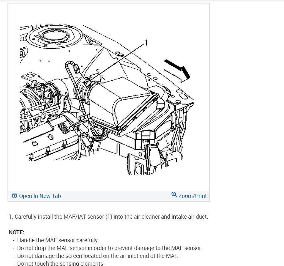

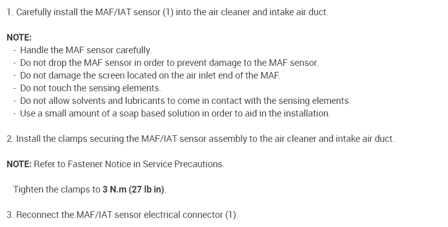

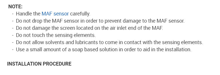

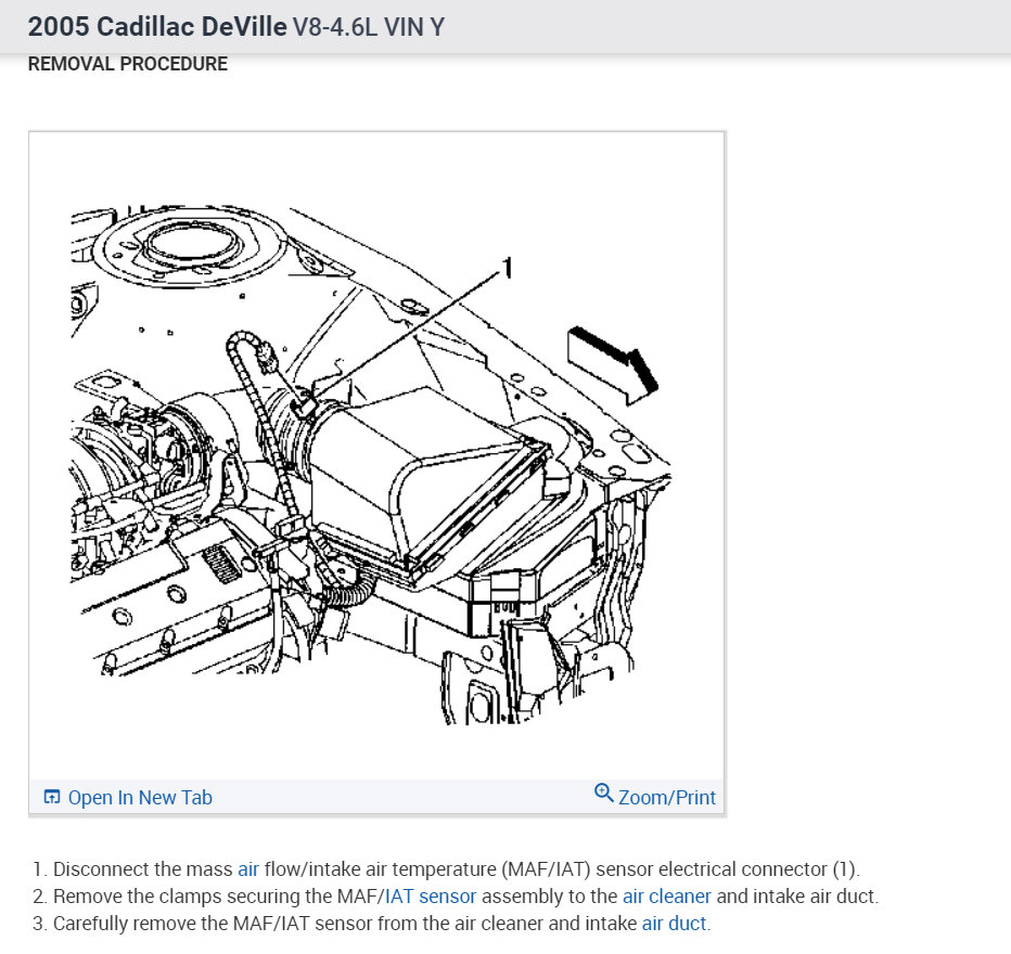

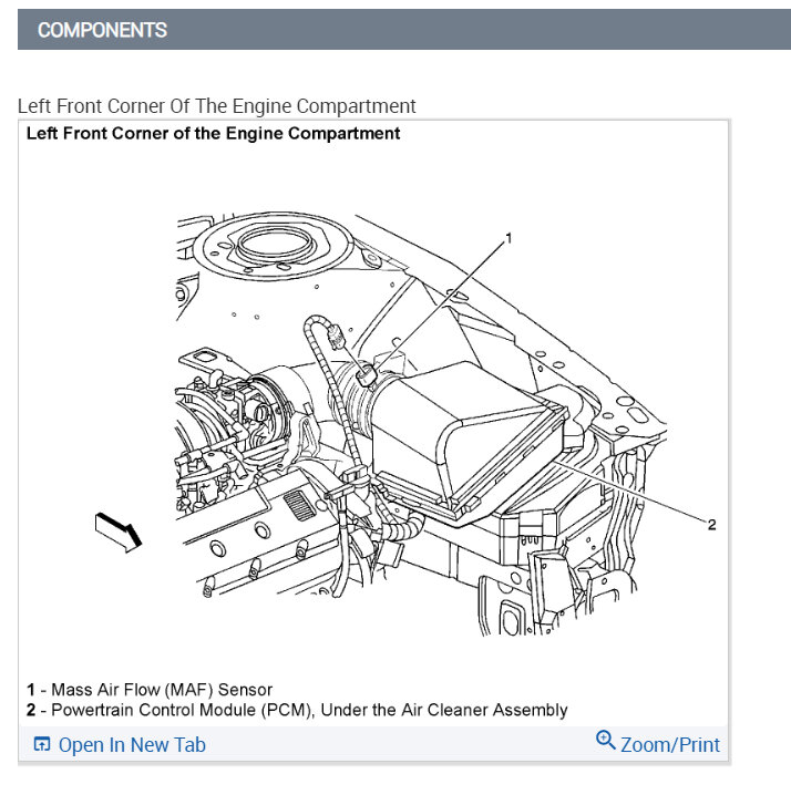

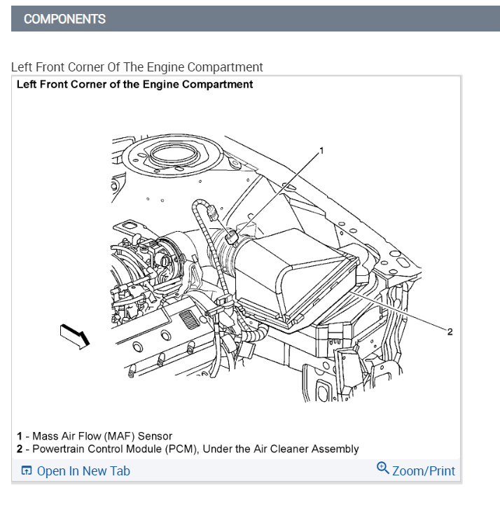

It sounds like the MAF sensor is not working correctly or there is a leak after the MAF sensor so please check the air intake tube/boot.
This guide can help:
Here is the location of the MAF sensor so you can change it out. Check out the images (below). Please let us know what happens.

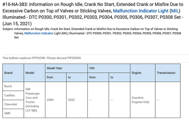

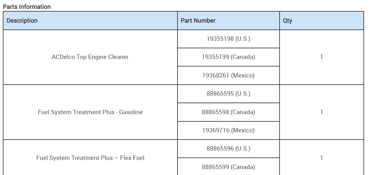

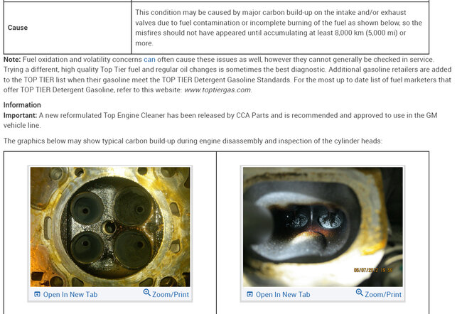

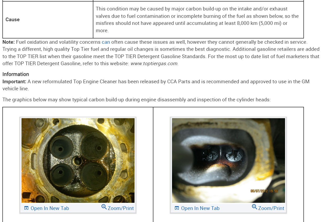

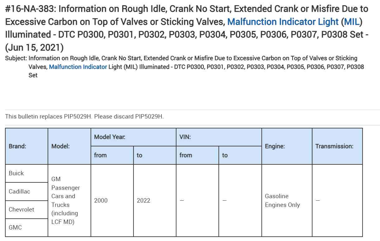

Okay, let us know if that clears up the random misfire code. There are some issues with carbon build up on intake valves for these engines as well, there is a Technical Service Bulletin on it. If its still setting the code you can try some of the ACDelco Top Engine Cleaner (3rd diagram). That GM recommends for carbon issues. Adding some fuel system cleaner can help as well.

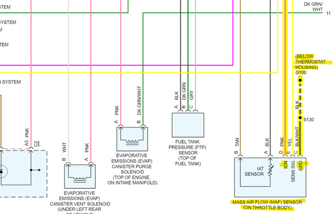

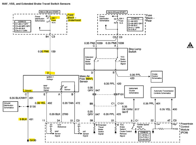

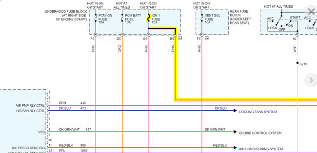

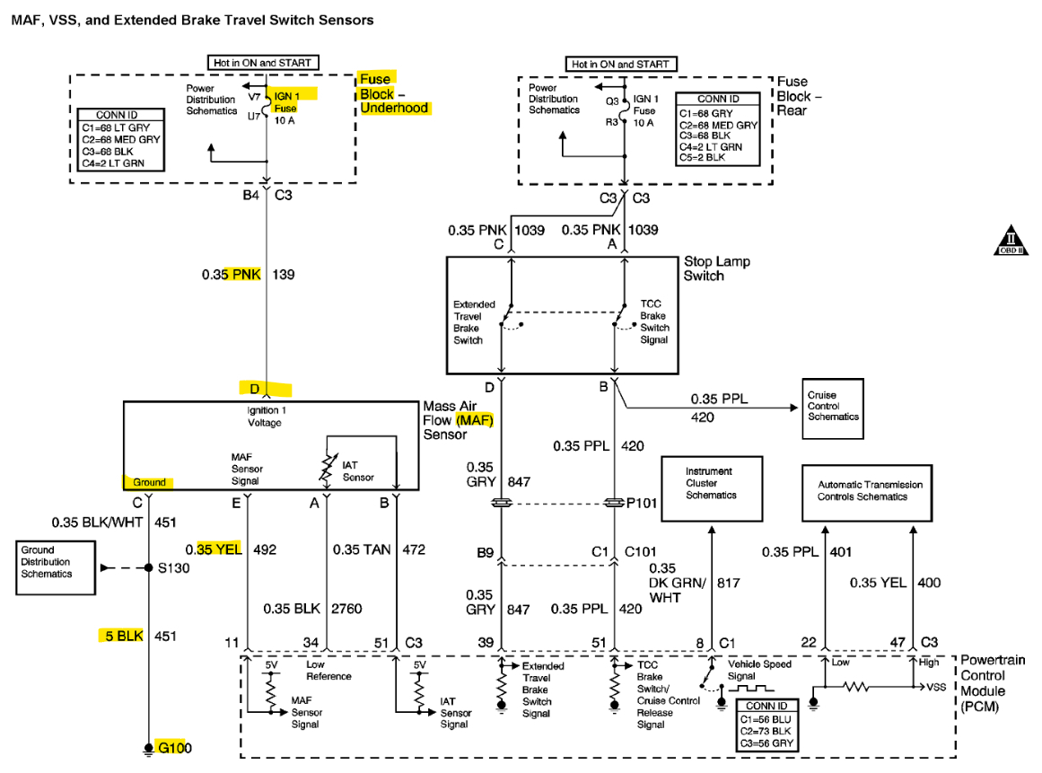

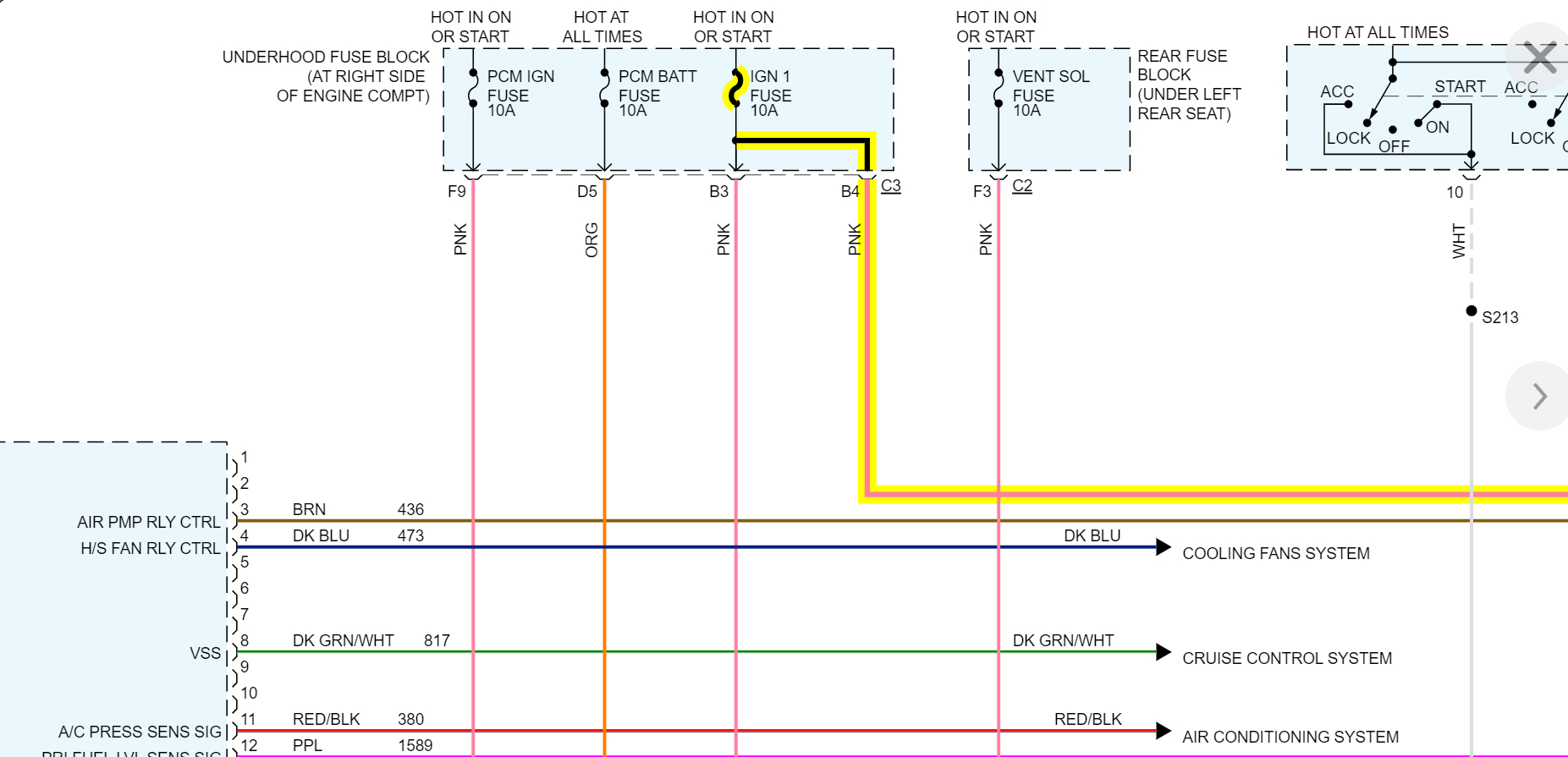

Is that the MAF voltage reading? or the g/s (grams per second)? If that's the voltage reading, you should check for possible bad ground to the sensor, or lack of power feed.
Here's the MAF wiring diagrams if you want to check the voltage feed and Ground. There should be 12v on the pink wire with the Key On.

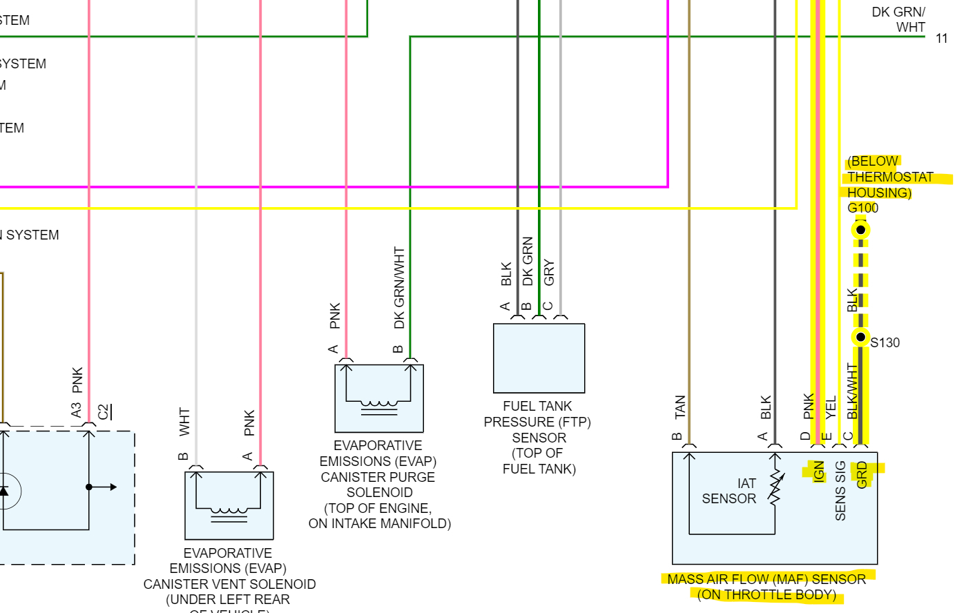

Here's what to do first: verify good power and ground to sensor, with key on engine off. I will look up what kind of signal the ECM is looking for really quick, some MAFs signal with frequency. The frequency will increase as air flow increases. It's better to do some testing, even with a multimeter before replacing any more parts. You can do a fuel pressure test if you want to, but the MAF reading is definitely off. You can do the power and ground check with the sensor unplugged at just Key On. and check it using the sensors ground and then battery negative. A bad ECM ground can affect a sensor as well. I'll look up the testing for the MAF signal for you
Is it not setting any codes at all?
And does your scan tool have any options to look at the I/M readiness monitors?
I also see that this vehicle has a secondary air injection system. Sometimes when the air diverter valve doesn't switch over (or off) and air is continually pumped into the exhaust when it shouldn't be, the oxygen sensors will see that as a seriously lean condition and fuel trims will rise. But the vehicle should be able to sit and idle for a few minutes and then be driven at part throttle up to 45mph for at least 3 minutes to run its active tests and then the IM readiness monitor for the AIR system should read yes/ or ok.
Okay, the operation of the MAF goes as follows. The Pink wire should be 12volts, the Black/White wire is Ground. and the Signal wire is the yellow wire, the yellow wire should read 5 volts and will output a 0v to 5volt square wave signal, that signal will increase in Frequency when air flow increases and should read about 2000Hz at idle. This is the type of sensor I would check with an oscilloscope, but if your scan tool reads live engine data PIDs there will be a reading for the MAF signal.

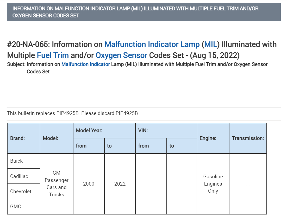

The PCM needs to relearn the new MAF as well, so that's something to take into account, but the lean codes are pointing to a large intake vacuum leak.

I forgot to say I did check MAF current and I have ground and correct current on 12v and 5v.The stft does get close to ten but not under. The 02 voltage seem to wave up and down at all rpm but within range .1to .9 . when I but 2 graph up o2and stft when o2 is up ,ft is down, the graph point at each other and away .

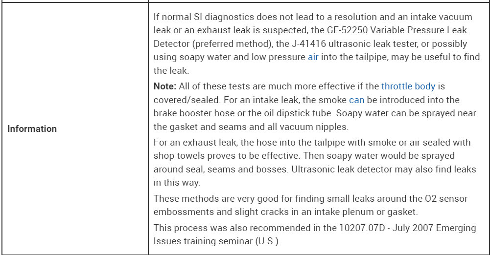

No, those are normal oxygen sensor voltage readings, what is your MAF reading at idle? Also clamp off the block off the brake booster hose completely, so the booster is out of the equation and see what the fuel trims do. The reason the fuel trims changed after warming up is because when the vehicle is in Open Loop during its warmup to operating temperature, the ECM doesn't use the Oxygen sensor data to calculate its fuel strategy. Once the engine goes into Closed Loop operation, it then uses the Oxygen sensor data and it's still seeing a lean exhaust and adjusting for it. Start to block off some hoses that go to the intake manifold one at a time and see which one causes the short term to come down. Now if your Long term fuel trims are high, for example lets say Long Term is at 20%, and you find a vacuum leak, block it off, now since the Long Term is at 20% (and Long Term is more of a learned value), you will see your short term go to -20%. To correct for the already learned value of the Long Term, when you add 20% and -20% you get 0%. Does that make sense? Once the problem is corrected, the Long Term will eventually learn the correct Fuel trims, and everything will even out.
So, block off the booster hose, unplug the Purge valve and block it off. Any vacuum lines one by one until you find the issue. Or do a smoke test on the booster and intake manifold. There's still a leak somewhere. Can you graph both front oxygen sensors for me after it has warmed up so I can see the waveform?

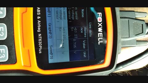

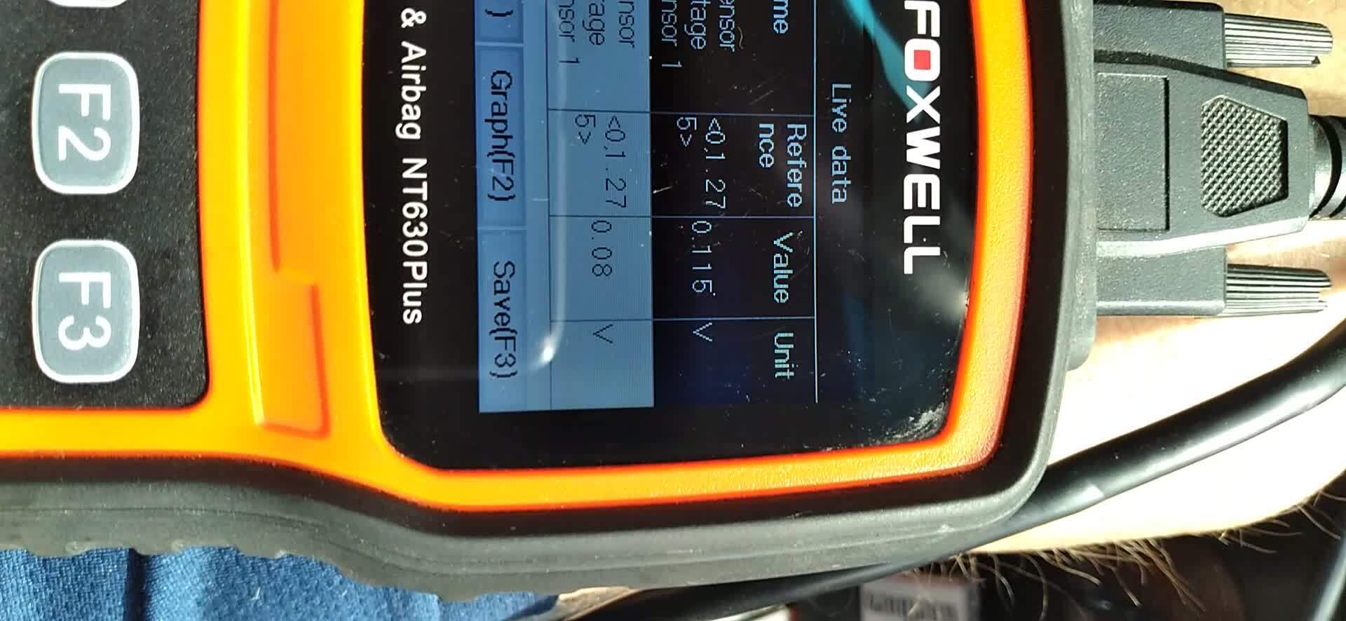

Can you show me the graphs for the 2 front Oxygen sensor graphed voltages only, not the fuel trims, so oxygen sensor Bank 1 Sensor 1 voltage, and oxygen sensor Bank 2 Sensor 1 voltage after warming up when you notice this drop to 0 volts. And on the graph show the point at where they drop and go to from 0.8volts to 0volts. I know your scan tool may read Oxygen sensor STFT %, but I need to see the voltage readings. And in a separate picture the live engine data after warming up at idle. I can't tell what's happening unless I can see what the ECM is seeing.
Jun 21, 2023 at 2:41 AM

This is after warmup o2 sensors are at operating temperature. Could the vapor canister purge valve give me this problem only thing I haven't messed with, that is past the MAF.

That scan data is extremely slow, those Oxygen sensors are fluctuating much faster than what you are seeing on that screen. Yes, the purge valve can cause a lean condition, if its sticking open, once it's purged all the vapors out of the canister it will be pulling straight oxygen threw the canister vent valve which is normally open. If the canister failed and the charcoal pieces broke apart, they get stuck in the purge valve and keep it open. Try unhooking one of the lines to it and blocking it off. There seems to be sections of the oxygen sensors that are hanging both rich and lean, the upper one on the screen was much slower. But cylinder misfires can cause that as well. When a cylinder misfires, raw fuel and oxygen go down the exhaust, and since an oxygen sensor can only read oxygen, it can send the system rich, just increasing the issue.

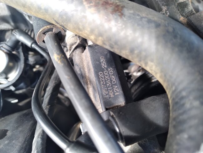

Yea, cannister purge solenoid is bad, got less than 10 on both banks after hose disconnect and blocked even - #s on stft after warmup. Ordered replacement. Again, thank you for your patience and help, do you take donations? Worth it to me I will tell anyone how great you have been.
Jun 22, 2023 at 12:07 AM
AL514
  • 5,639 POSTS
I'm so glad you found the fault, was the purge valve stuck open? You should tap the Purge valve in the ground and see if any charcoal pieces come out, if anything falls out of the valve that means the Canister is most likely at fault, and the charcoal inside has broken up and traveled into the purge valve preventing it from closing all the way. The same thing will happen to the new purge valve if the charcoal canister has failed. The reason they go bad is because of over filling the gas tank, The fill handles at the gas station are design to click off when the tank is at the correct fill level, Some people will pull the handle out a little further to try to get more gas in the tank, but this is what causes gas to get into the canister and ruin the charcoal, So just be aware of that.

I don't think my solenoid has charcoal in just a valve and it is stuck open haven't replaced yet. Local auto parts want $50.00. Online it's $18.00 get tomorrow. Yes, send link. I have been working on my own cars for 55 years. I know about not overfilling gas tank. I was lucky finding this car 1st owner bought in 2005 Chicago for $50,000 and retired to Fla they were millionaires and I bought from estate for $2,000.00 with 40,000 miles.
