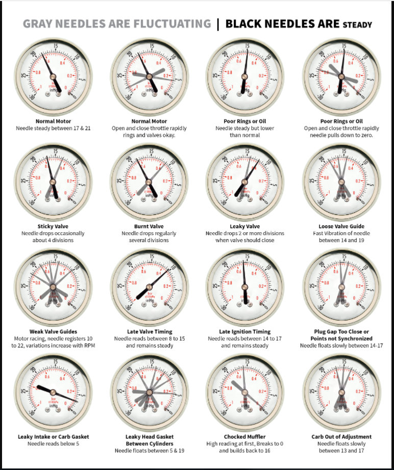

If the compression is ok, let's hook a vacuum gauge to the engine and see if the gauge is steady. This will tell us if there is an intake valve floating only while running.
Let's start with this and go from there. Thanks

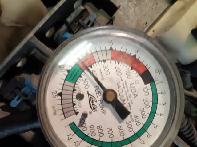

i have already checked vacuum and on the gauge it points to late timing around 14 on the gauge.I will check the compression to make sure the compression on the cylinders is good. also i have no fuel injectors,it is a CDI fuel system.

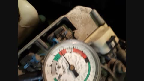

Sorry. That does say 1996 in the heading.
Can you get a recording of the vacuum gauge hooked up so we can see what it is doing because I was expecting that to be the issue.

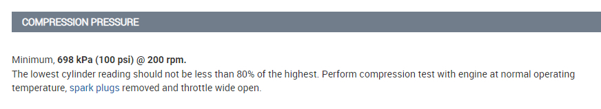

I attached your compression spec below for when you check it.

Don't know why it doesn't drop after I leave off throttle.

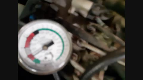

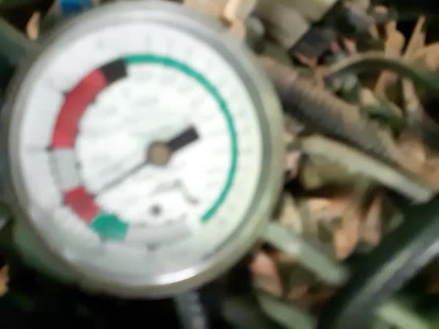

Sorry had gauge hooked up wrong. this is correct hook up:
Jan 8, 2021 at 3:31 AM
That is most likely a valve issue. Either a sticking intake valve, loose guide, leaking intake valve or possibly a ring issue.
However, the unsteady reving is an intake valve as well. I suspect you have a leaking valve so I would do a compression check next to find what cylinder it is.
If the timing is off as you said earlier then that could be the cause of the leaking valves if they are opening too soon but I would still do a compression check just to be sure.
Jan 9, 2021 at 8:26 AM

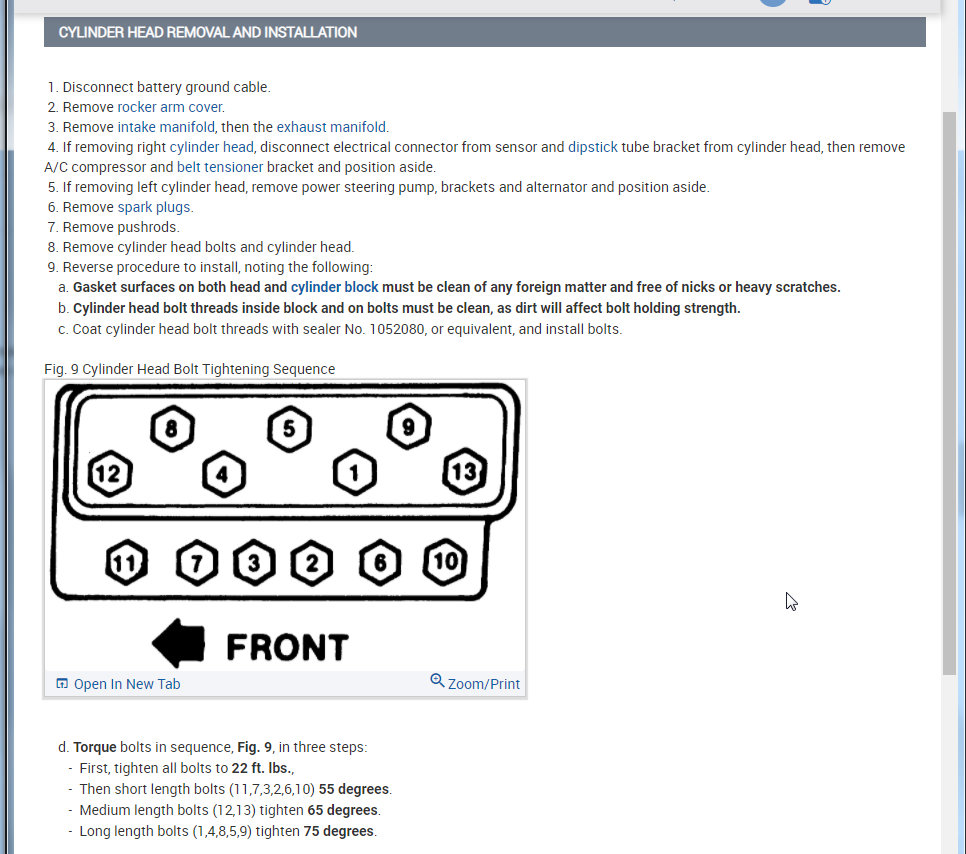

You nailed it. The intake valve is not sealing so it is either the valve is burnt, rocker/spring failure, or the cam lobe/lifter is wiped out. So we need to start with removing the valve cover and check the spring and rocker arm. Then we need to dig further depending on this. I attached the process for the head if that is what needs to come off.
