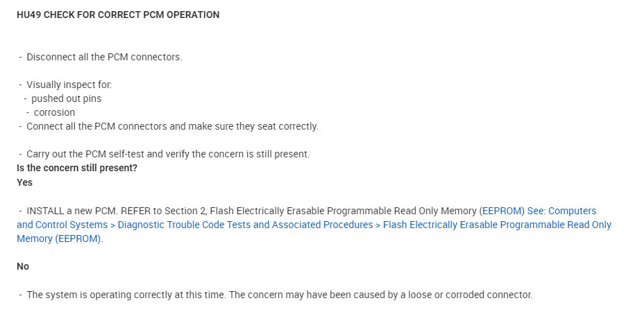

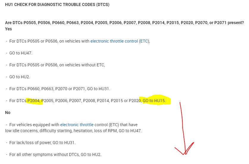

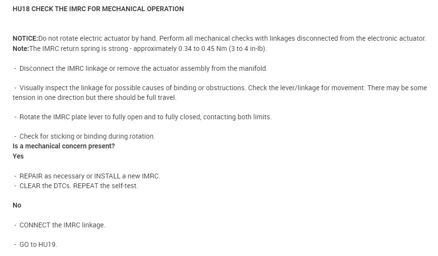

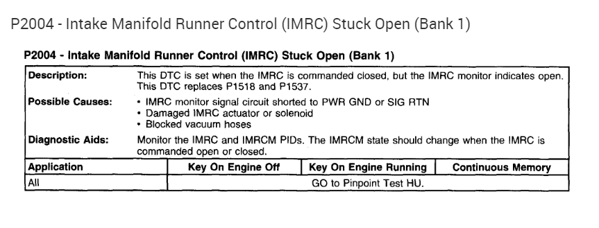

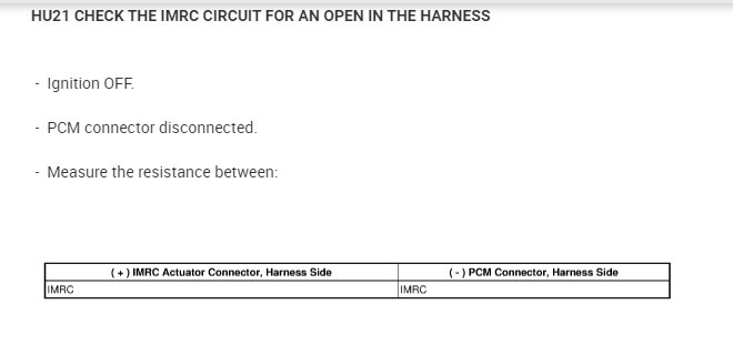

The P2004 is indicating the intake runner control is stuck in the open position when it is commanded to close on bank 1. (See pic 1 below)

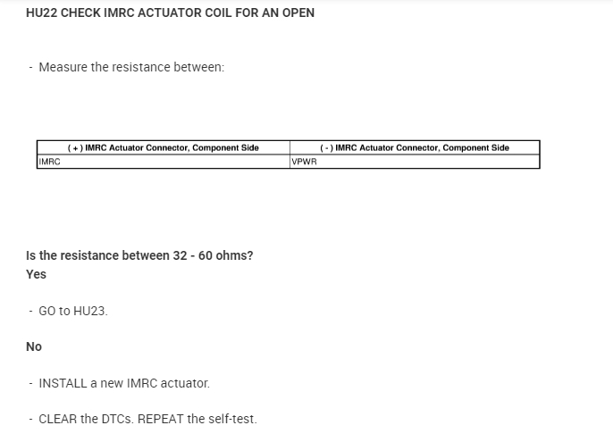

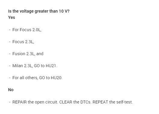

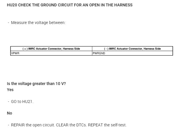

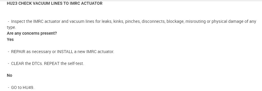

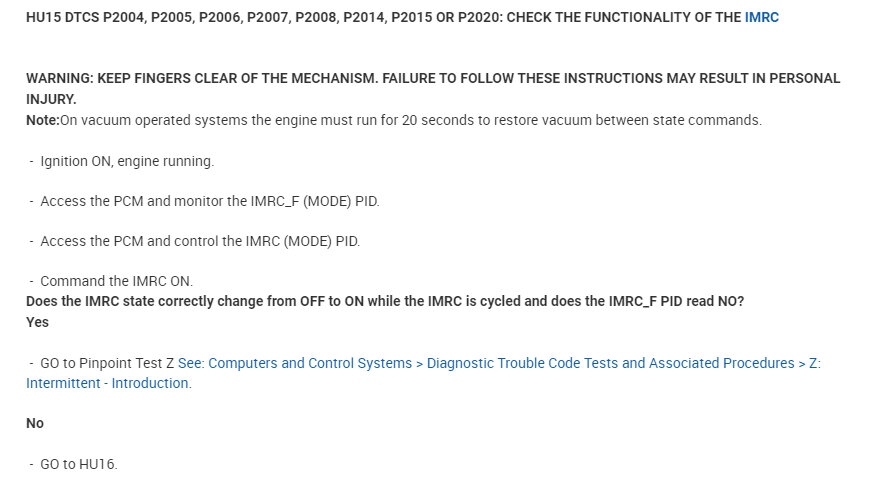

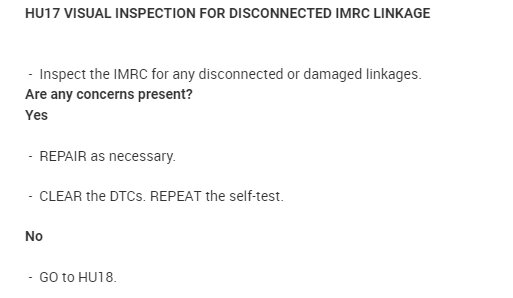

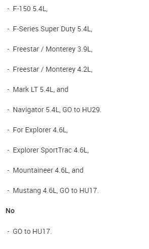

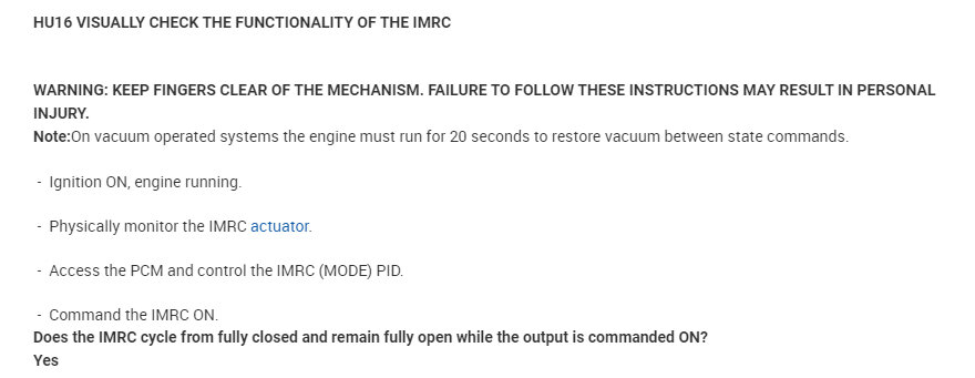

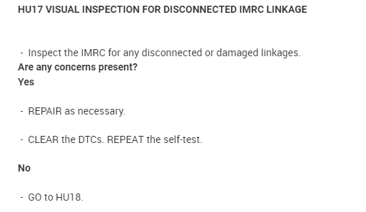

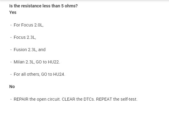

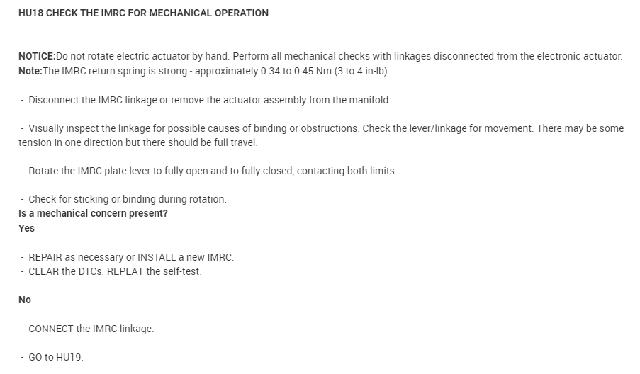

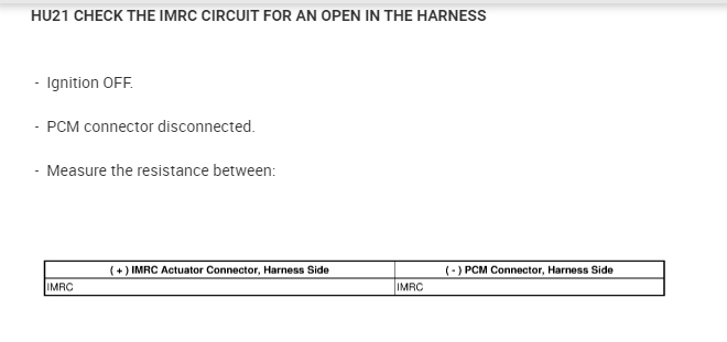

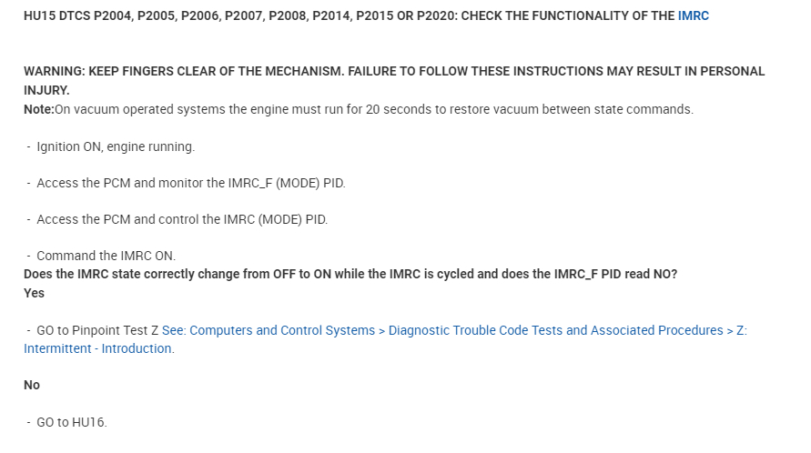

The tests related to the P2004 are listed starting with picture 2 below. Note that the tests are for multiple intake system concerns. You will notice that I jump several of the tests because they are not relevant.

Also, take a look at the diagnostics I attached and let me know if you are comfortable performing them. Remember, chances are when you purchased the new/used engine, the intake and runner were on it. If they were used, there was likely a problem prior to you getting it.

I think I found out the problem. This wasn't something I wanted to tackle and I'm glad I didn't because I'm sure my shop was really frustrated. There was another f150 in their parking lot they were working on. He thought the IMRC valve was bad after replacing that, the PCM and checking the wiring and sure enough it was. It was an aftermarket one and i bought one from the dealership today 4x as expensive at four hundred dollars but that should do it. After looking at the runner valve on the other f150 that had a working IMRC valve, he noticed that that part shouldn't move manually with the lever arms and that the lever arms didn't go out far enough. I finally feel confident that this should be resolved after going down there and looking at it so it should be ready to pass smog tomorrow and get it tagged.
