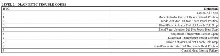

Plymouth Grand Voyager, 1998, 71K, 3.3L: I recently had my car alarm disabled because it was draining my new battery. Now the small indicator lights on the climate buttons are flashing and my mechanic does not know how to reset them. AC still operates, but I can't toggle the rear defroster on and off, for example.
How do I reset these to eliminate the annoying flashing lights?

by it blinking at you its giving a code if you can get the code we can tell whats wrong
https://images.2carpros.com/forum/automotive_pictures/99387_ply_1.jpg
