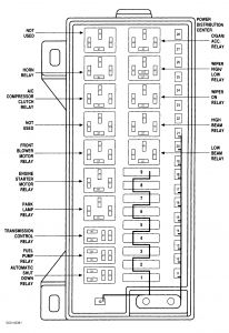

The wind shield wipers intermittently come on when the vehicle is started. Sometimes will stay on until the engine is shut off, otherwise, will operate for a minute or so and then shut off.

replace/check connections on wiper relays in underhood fuse/relay junction box (near battery)
https://images.2carpros.com/forum/automotive_pictures/266999_wiper_1.jpg
