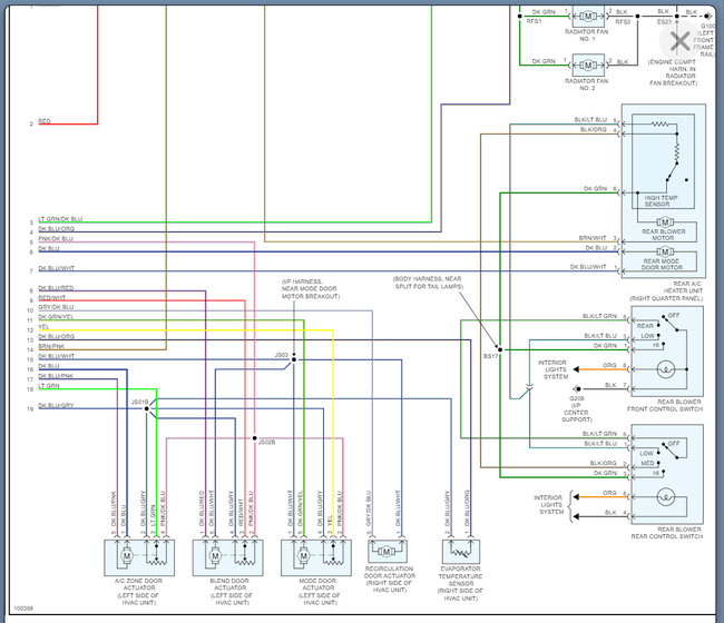

Rear wiper / int. Rear wiper, air cond. And recirculate air lights all flash. Temp selector and airflow selector do not function. Fan blows, but only cold air. "Airflow direction door" under right side of dash continually "thumps".

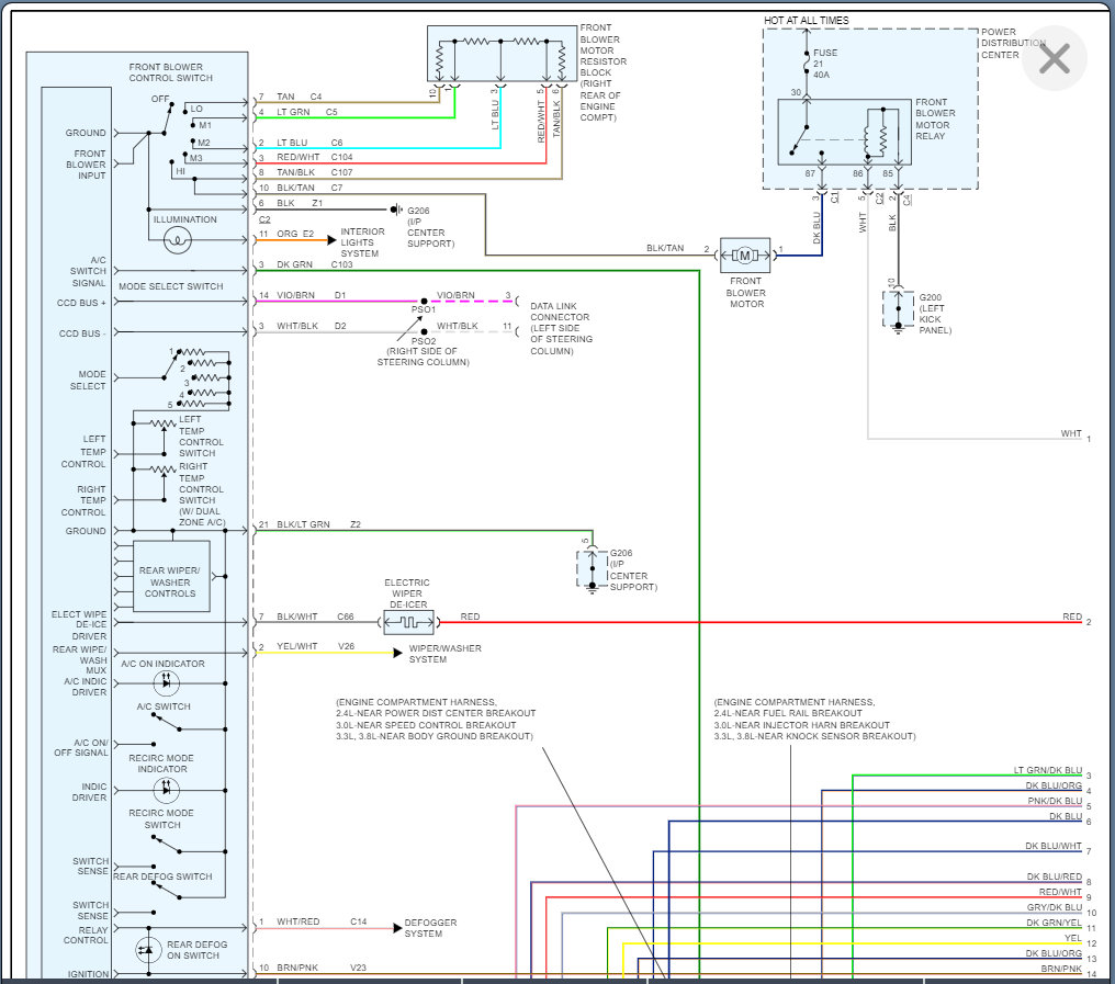

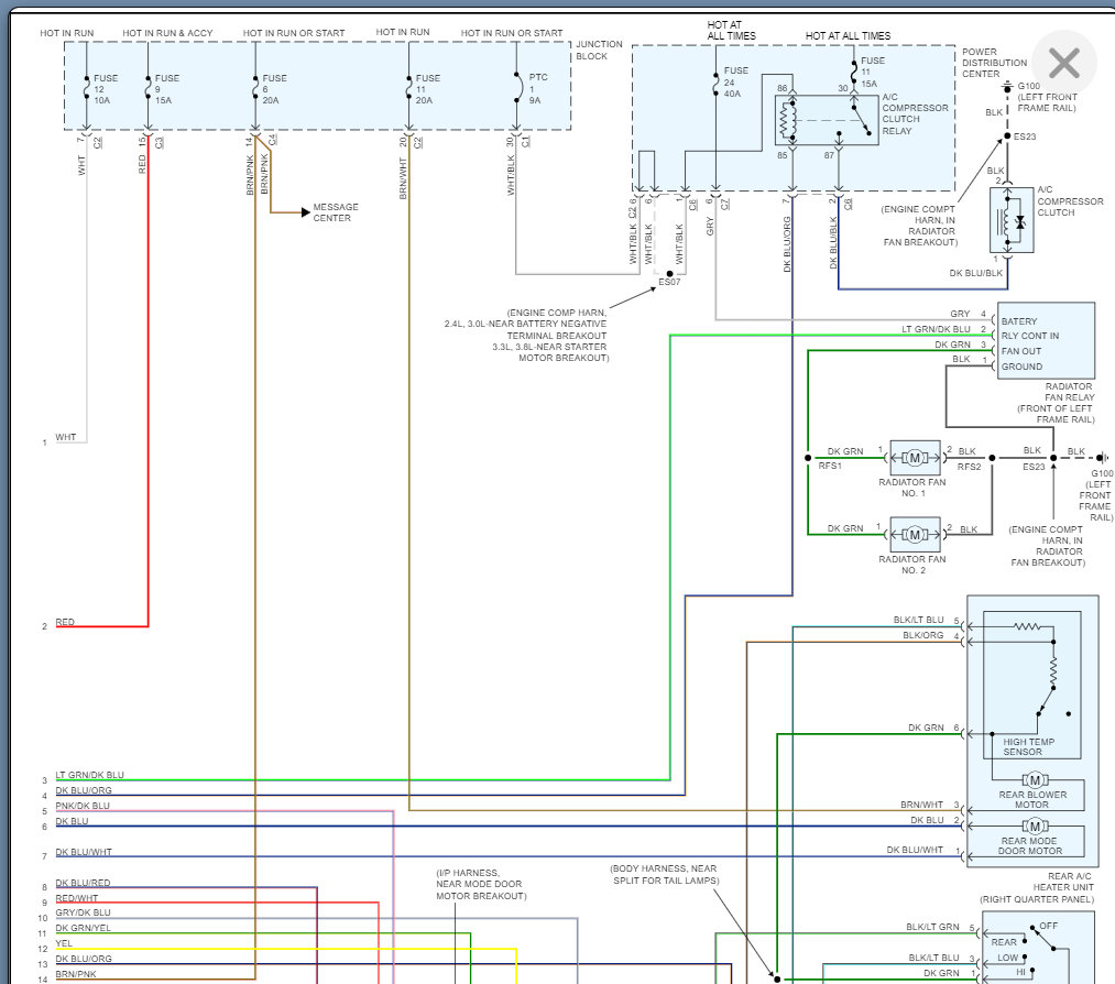

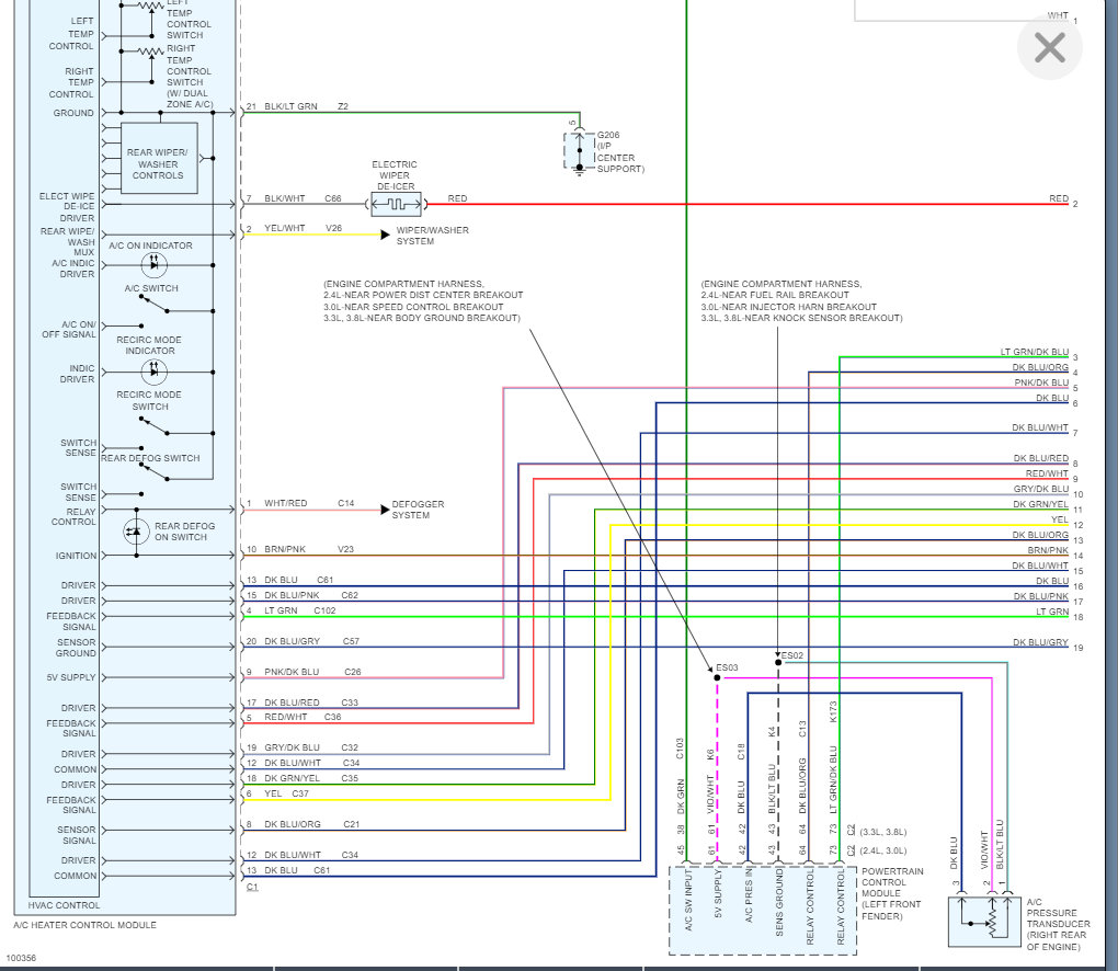

This sounds like you have an issue with the control module or possibly an air door. However, we need to start with the basics and this guide will help get us started.
https://youtu.be/SNRb6pSwYuU
What I would suggest is starting with checking voltage coming from the control module going to the air doors as you are changing them. If the voltage is not changing, then the module is the issue.
More than likely the driver in the module has failed and is not commanding the doors or the circuit board has otherwise failed.
I am attaching the wiring diagram below for your review but if it were me, I would suggest just replacing the module as I have seen this a number of times.
Let me know what questions you have or how this turns out. Thanks

MISTRD
I have heat!
Replaced the module ($65.00) and all is good.
Thanks again for the help. :)
