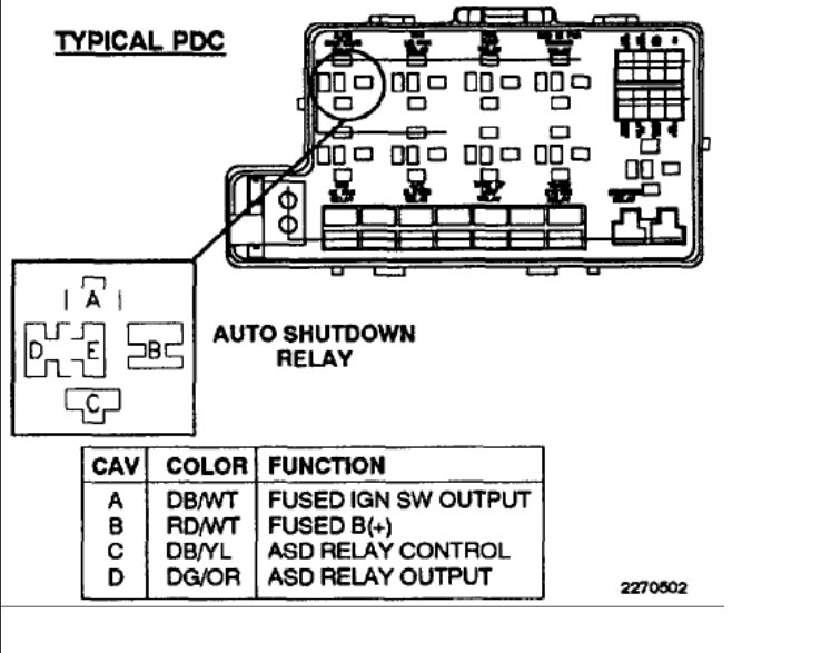

Won't start. No spark.

Van hesitated once in a while and even died a couple times, but always started right back up. 2 weeks ago, it died and will not start. I have checked all fuses under dash and hood, checked for spark and replaced the coil. However, there is no power going to the coil. What would be my next step in trying to figure out the problem?

It sounds like you need to replace the ASD relay which is a common failure in these vans.
Here is a guide to help you test the relay once you find it.
Here is the relay location.

You guys are geniuses. That d id it I didn't even test the relay I just ordered a new one and like a boss the car started! Thanks again I will be back.
