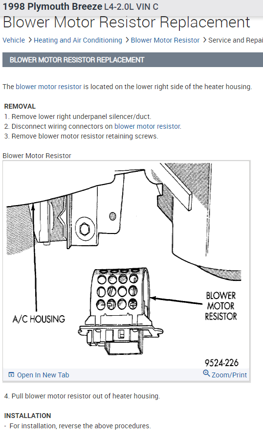

How can I fix the blower levels? It only works on the highest level.
Nov 24, 2008 at 5:18 AM
SQM
  • 6,383 POSTS
It sounds like you could have a faulty blower motor resistor. That's why it is blowing only in one setting.
The blower motor resistor is located on the lower passenger side dash (see diagram below).
It is a very straightforward replacement process.
Here is a helpful article:
https://www.2carpros.com/articles/blower-fan-motor-works-on-high-speed-only

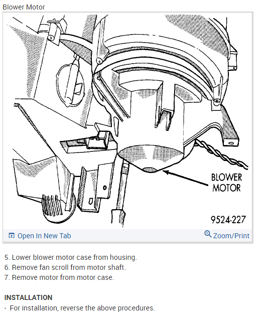

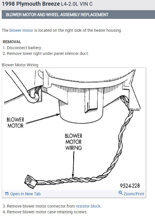

I have attached the diagrams for the blower motor as well as the resistor.
