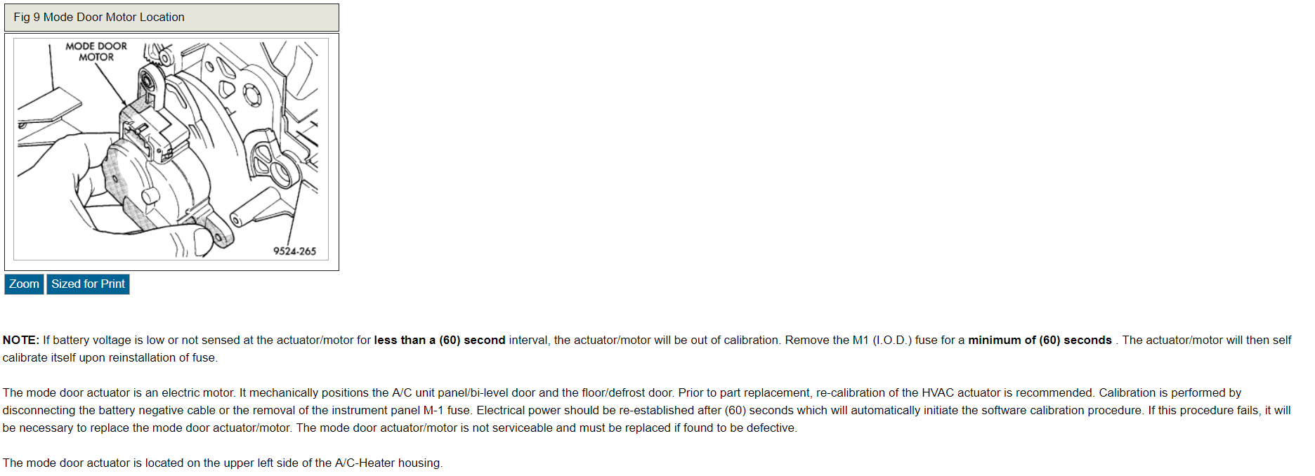

My question is my air is blowing out from the defrost and not from the main vents.

It sounds like the mode actuator is not working here is a guide to help you see what you are in for when doing the job.
Here is the location for your car. Check out the diagrams (Below). Please let us know if you need anything else to get the problem fixed.
Cheers
