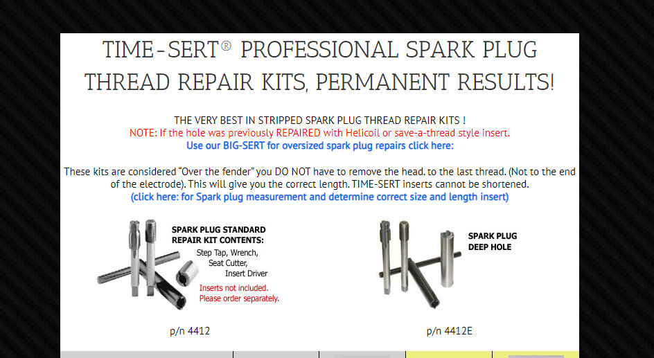

how would i go about fixing that with out removing the head. could i use a helo cord for the repair
Feb 2, 2009 at 4:46 PM
You can try this but it is not likely to hold for a long period of time. So you will need to keep an eye on performance issues as it may start leaking compression.
Here is a guide that will help with drilling and tapping new threads.
https://www.youtube.com/watch?v=YDt5OUIZTs0&t=288s
Again this is not the best repair an in fact there are better options out there. I have had great success with something called a Time Sert.
I have not used them for spark plugs but they make kits just for this.
Basically this is where you drill out the treads and then install a plug that will have new threads and it is stronger then a coil.
I attached a picture below to give you an idea what they are.
If it were me, I would go this route rather then a coil.
Let us know if you have other questions. Thanks
