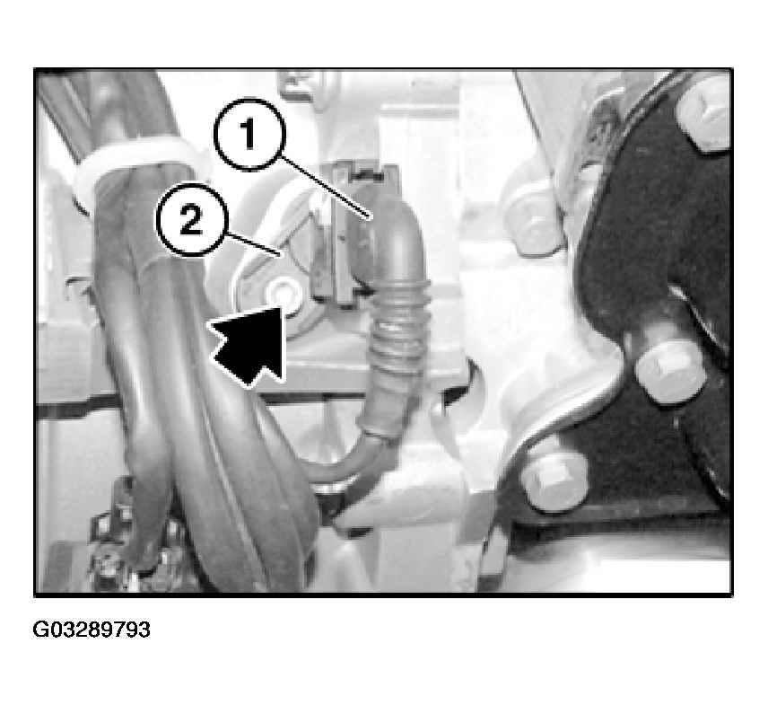

I have short question, new plugs and coils. Will a battery maybe going bad cause the spark plugs and coils not to fire? Car model above is a 745i.

If the battery is strong enough to crank the engine, it should not have an affect. If you are not getting spark, I would suggest checking the crank sensor. If you have a scanner which reads live data, check to see if there is a signal coming from the sensor. The sensor is located on the bottom right of the transmission bell housing. I have attached a picture for you to see its location.

I had already replace the crank shaft sensor that was not the problem. I notice when I open the car door the inside lights do not come on, but when I hook the charger on the battery about ten to fifteen minutes then I open the door the inside lights come on. I also replace the Integrated supply module. I thank you.

If the lights only work after the charger has been on it, remove the battery and have it load tested. It sounds like it is bad. Most parts stores will test it for you free of charge. Here is a link that describes how to do it if you would rather do it yourself:
Let me know what you find. Keep in mind, if the battery does not have enough power to turn on the interior lights, it cannot start the engine.
