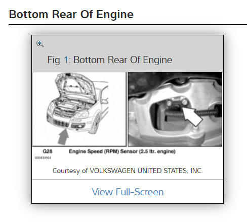

Engine is a 2.5. When car is in park the rpm rises and falls with put me pushing gas. I check code and it has error codes p0480 and p0322.

The first code has to do with the cooling fans and wont be a performance issue code but the other one yes, P0322 does
This generic powertrain/engine diagnostic trouble code typically applies to all spark ignition engines, including but not limited to certain Audi, Mazda, Mercedes and VW vehicles. The Crankshaft Position Sensor (CKP) provides crankshaft position or crankshaft timing to the Powertrain Control Module or PCM. This information is typically used for engine rpm
The camshaft position sensor (CMP) provides the PCM with the exact location of the camshaft, camshaft timing or distributor timing. Anytime the voltage drops below a set level in either of these two circuits, the PCM will set code P0322. This code is considered to be an electrical circuit fault only.
Symptoms of a P0322 engine code may include: Malfunction Indicator Light On Engine cranks but will not start Misfire, Hesitation, Stumble, Lack of Power
These two sensors should be checked out and check the wires leading to them to make sure there OK and not loose or compromised in any way.
