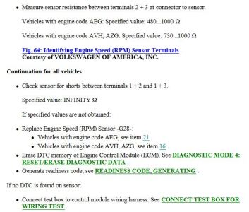

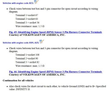

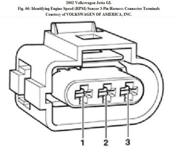

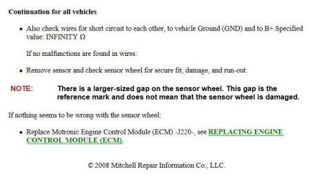

My daughter's VW died. The car won't start. I have some knowledge of car repair and I went to look at it. I scanned for a code it came up PO321 ignition/distributor.
The code doesn't tell me a whole lot. Does that mean it needs a new distributor or could it be something else?

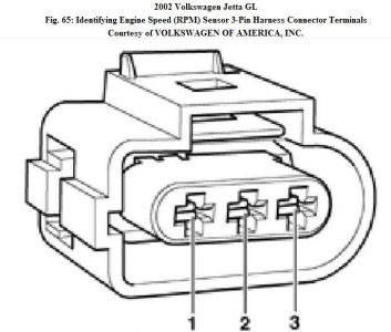

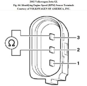

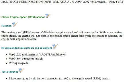

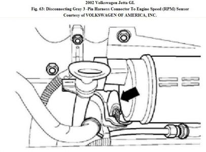

Hi Joe, Is this a 1.9 L or 2.0 L engine? Here are the diagnostic procedures for the 2.0 L, hope it is the correct one.
https://images.2carpros.com/forum/automotive_pictures/192750_DTDP0321_02Jetta20L_1.jpg
https://images.2carpros.com/forum/automotive_pictures/192750_DTDP0321_02Jetta20L02_1.jpg
https://images.2carpros.com/forum/automotive_pictures/192750_DTDP0321_02Jetta20L03_1.jpg
https://images.2carpros.com/forum/automotive_pictures/192750_DTDP0321_02Jetta20L04_1.jpg
https://images.2carpros.com/forum/automotive_pictures/192750_DTDP0321_02Jetta20LFig63_1.jpg
https://images.2carpros.com/forum/automotive_pictures/192750_DTDP0321_02Jetta20LFig64_1.jpg
https://images.2carpros.com/forum/automotive_pictures/192750_DTDP0321_02Jetta20LFig65_1.jpg
https://images.2carpros.com/forum/automotive_pictures/192750_DTDP0321_02Jetta20LFig66_1.jpg
