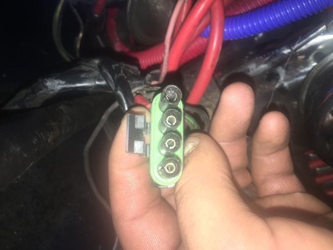

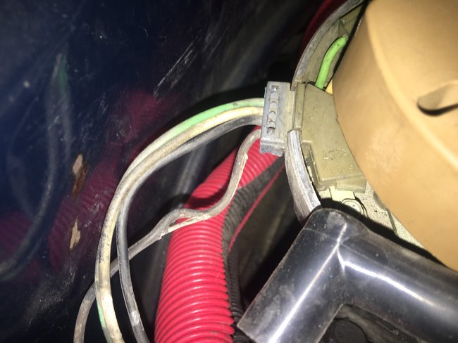

I got 8.71 k on the high end and.6 on the low end. I did notice one of the wires on the back of the distributor look like it had burned though its insulation.

Ok I got 810 on the actual pick up coil I'm going to see if I can get a decent picture of the wire the is fried the connect to it or so I believe it's right underneath the rotor so I'm not going to remove that unless I have to

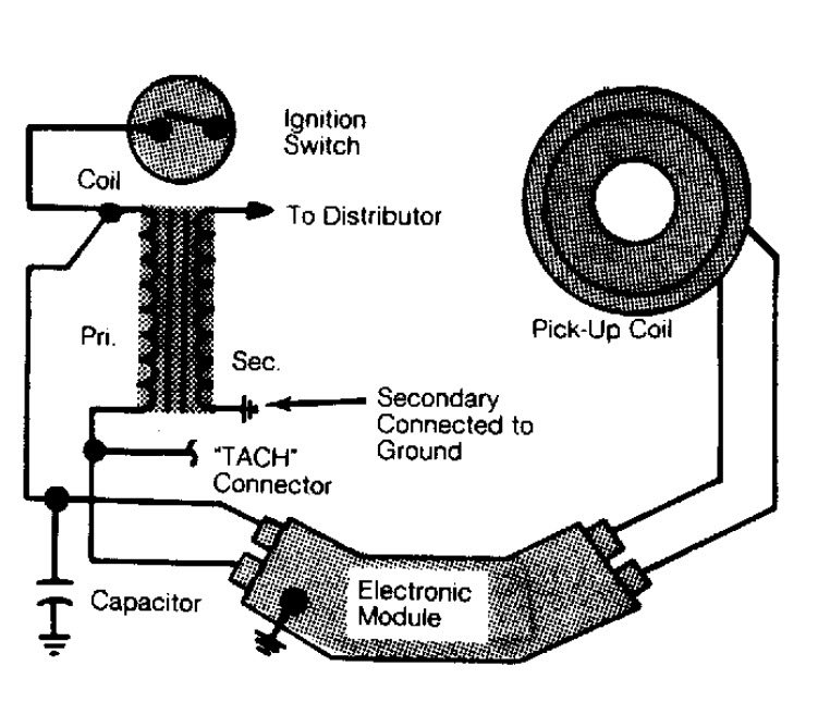

If the wire is fried fix it. You should have two wires form pickup coil. If one of the wires go to the module then that is probably bad as well. The starter disengagement is either a bad solenoid or it is not set up correctly meaning shims and that is normally to close to flywheel. There should have been instructions with starter when it was replaced. See pic for dist setup

Yeah that's what I figured on the starter or the bendex either way it's under warranty. For the distributor I was looking at just replacing the entire thing but when I look at what's on the market they do not have this part that comes out of the back which leads to a wiring harness at the fire wall I'm awful with electrical but have been looking at diagrams for 2 days now would you have any idea what the connector could be referred to that connects to the opposite side of the module. I found a replacement connector for the harness but not for the distributor. Thank you for taking the time out to assist me with this I have somewhere to start at least. I truly appreciate it!

So what I found out was that the wire that had been fried belong to the ESC(electric spark control) unit which I didn't know I had. So instead of replacing the wire I found after reading for a while that to bypass this system or test you can jump the green to the black which is a ground so I just grounded the green wire to the distributor where the black had been.
http://www.73-87.com/7387garage/drivetrain/escrepl.htm
That is a link that shows two ways to remove and or bypass the ESC. Which solved everything but the starter issue and that will be swapped this weekend. Thank you Hmac300 for your time and saving me some money I didn't need to spend.
