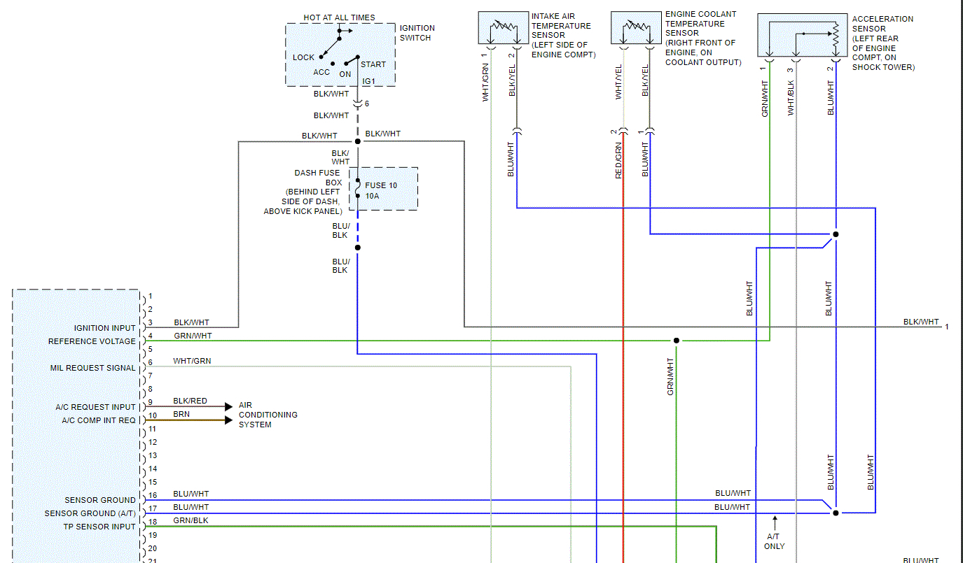

Pinouts of the computer
PACIFICISLANDER
  • 1996 HYUNDAI ACCENT
  • 4 CYL
  • 2WD
  • 70,000 MILES

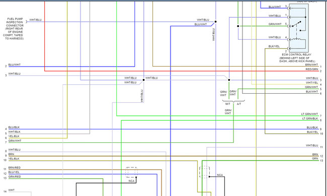

No spark.
Monday, March 23rd, 2020 AT 9:30 PM
8 Replies
  • 109,885 POSTS

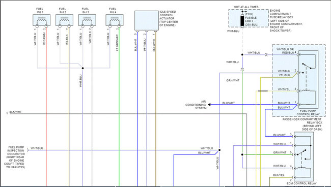

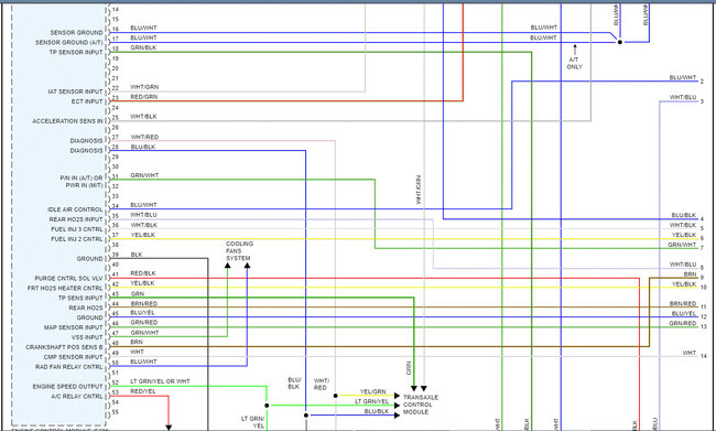

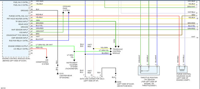

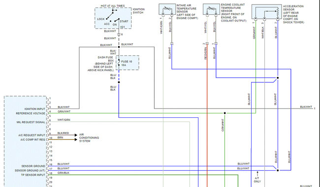

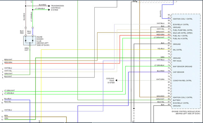

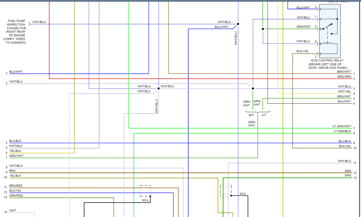

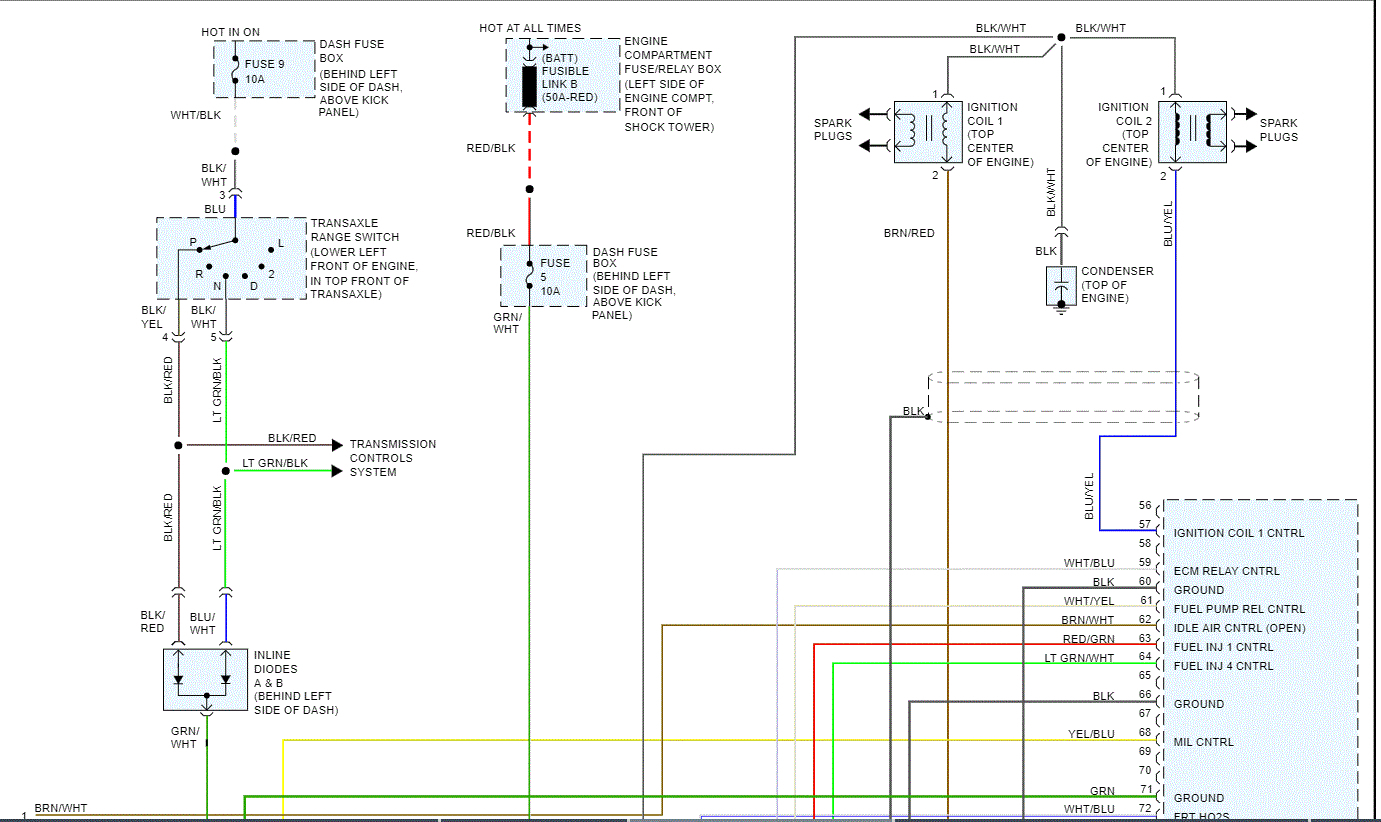

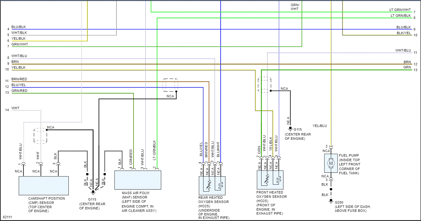

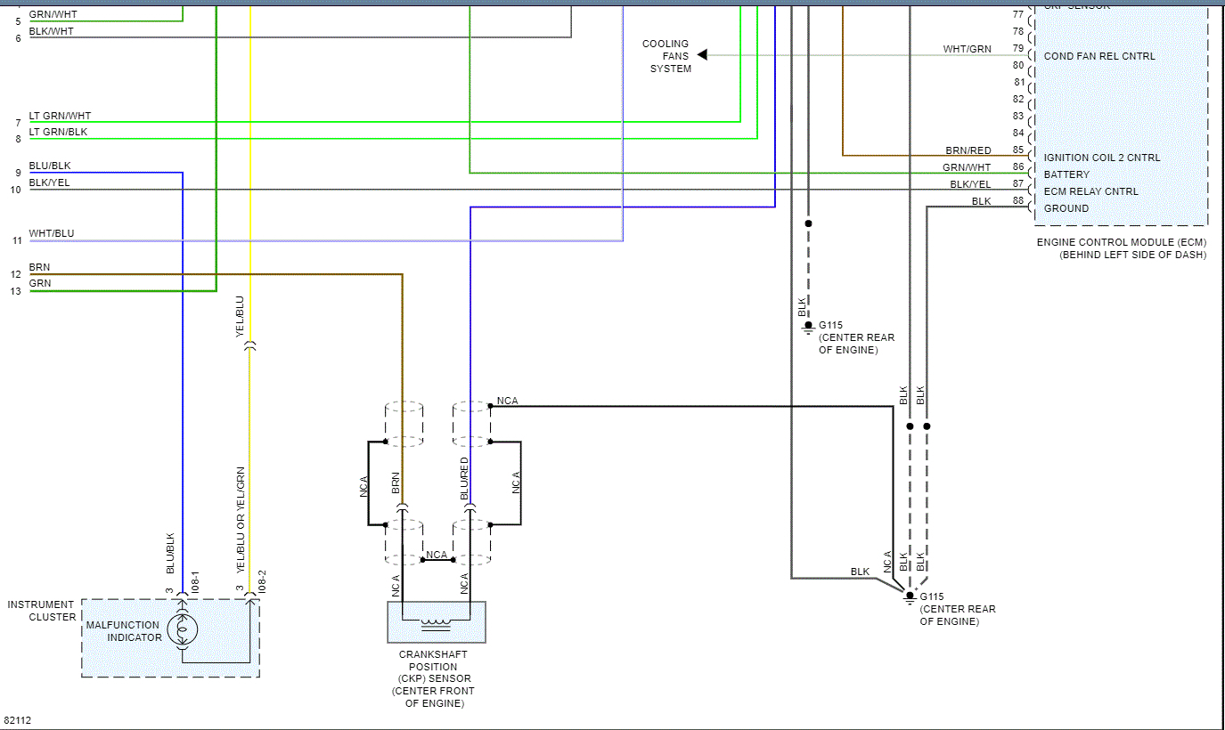

Hey buddy. I attached the schematics for the entire engine control system. The last two are what I think you need to look through first.
Are you getting an RPM signal?

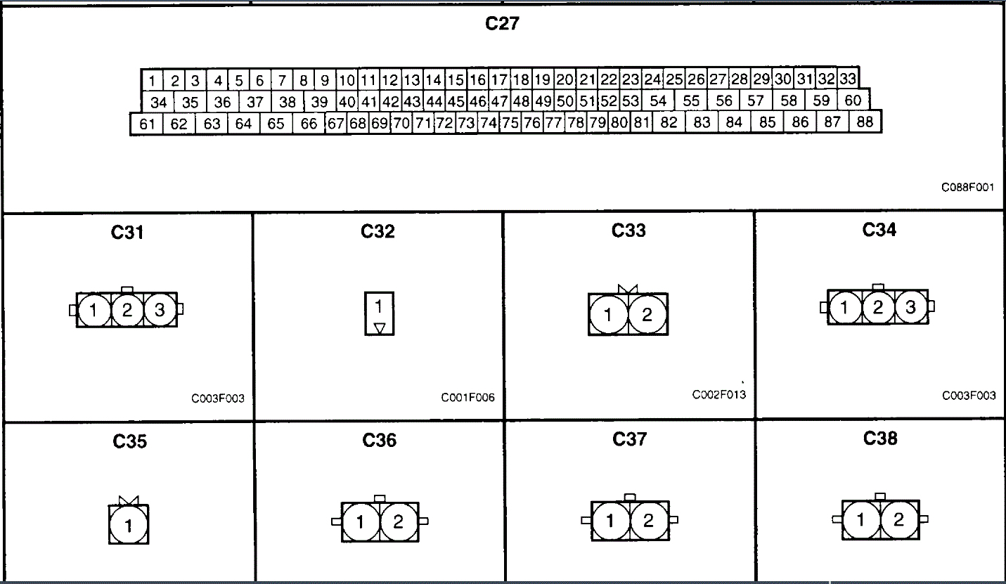

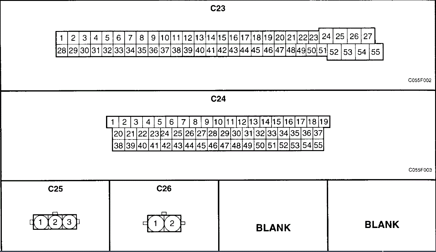

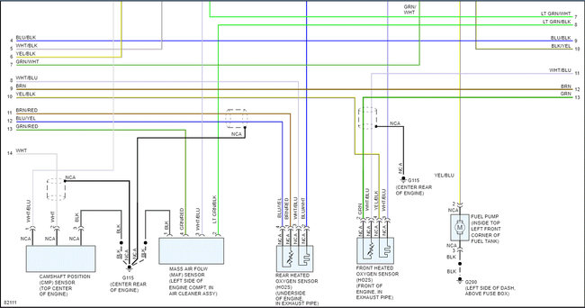

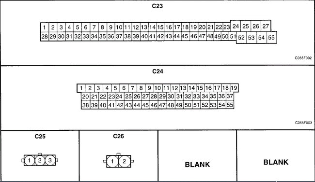

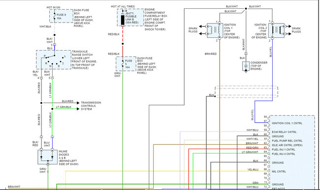

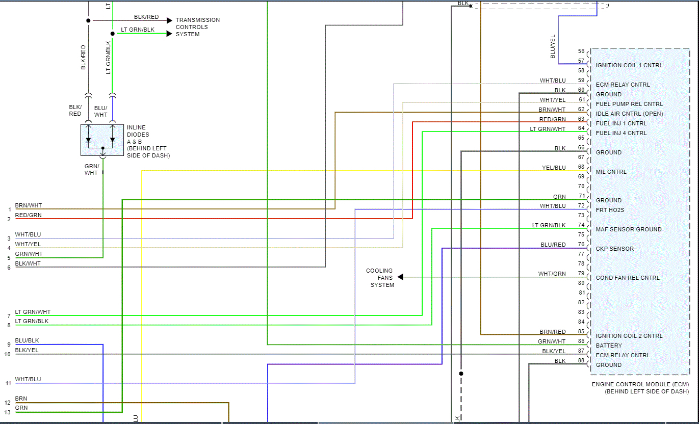

I need the no's on the PCM connector so I can determine from the connector to the sensors. Thanks
Joe its this I'm looking for so I will check wire to wire and then to sensor.
Monday, March 23rd, 2020 AT 11:18 PM
  • 109,885 POSTS
Here is what I have as far as connectors. Does that help?
