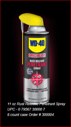

I was actually a paid participant in a focus group by WD-40 when they introduced the Rust Penetrant line. It's not the regular WD-40 in the blue/yellow can but it's actually made to compete with PB Blaster. I strongly feel it works wonders. You might want to try it. Hope this helps and thanks again for using 2CarPros.

Hi Danny L. Are you referring to the Rust Penetrant from the Chrysler dealers? Or are you saying Chrysler buys it from WD-40 and puts their name on it? They also have a product called MP-50 which in my estimation is the same as WD-40. They refer to that as a "moisture displacer" but it's actually a very light oil.

Here's what I'm talking about:
I was a paid participant in its introduction.Stuff works wonders.

Dandy. My guess is that is something different. Chrysler's stuff was made for freeing up rusted heat riser valves in the 1960's and 1970's.
