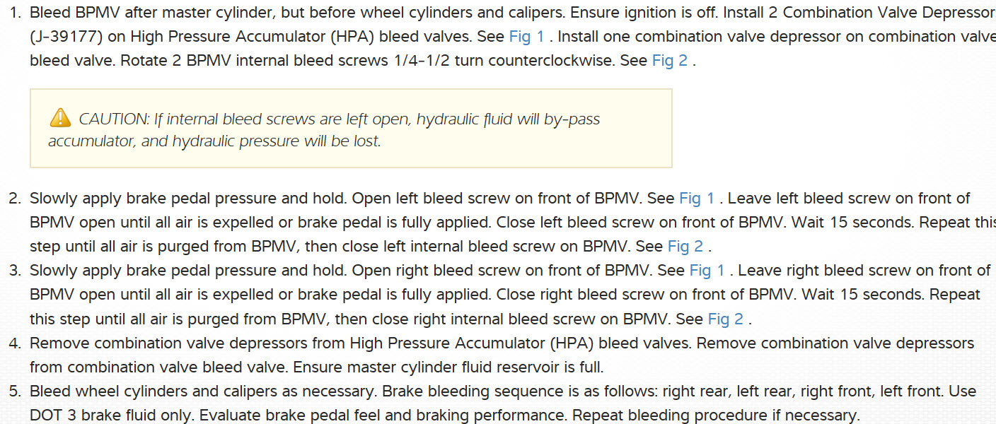

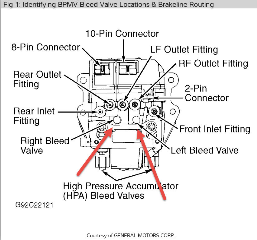

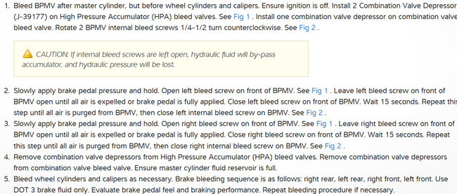

I have a Sierra pick up truck and I have a brake problem that no one can seem to solve. The pedal goes all the way to the floor. I have spent over $1,000.00 so far and still no fix. Took it to Firestone then they sent it to the dealer. It has been over thirty days and they still cannot get it to brake. Almost whole new brake system, rotor cylinders, pads break lines you name it.
+1
Tuesday, June 1st, 2021 AT 10:53 AM (Merged)
HMAC300
  • 48,601 POSTS
Try bleeding ABS unit manually before bleeding brakes normally. If this does not work find someone who has a tech 1 tool with the appropriate cartridge to do it. Your best bet is to rent a power bleeder to do this and it will take a ton of fluid. Do with ignition off. See pictures instructions are on second picture.

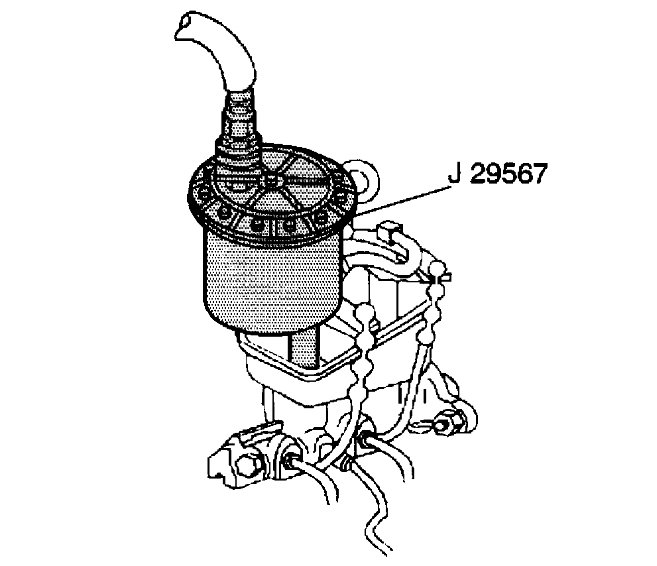

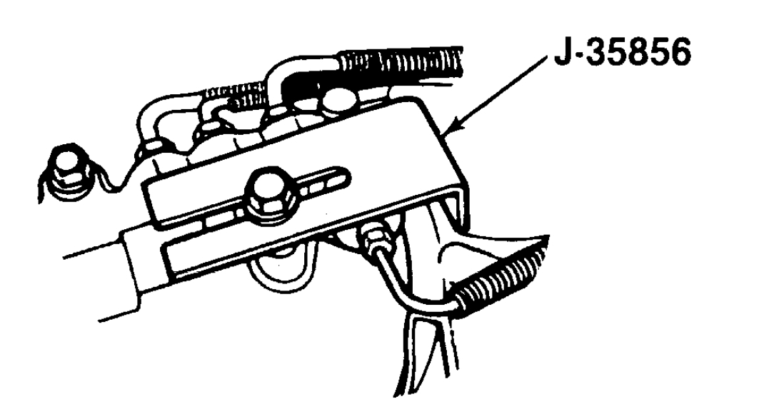

  • 52,797 POSTS
Good morning.
Do you have ABS? If you do there is a bleeding procedure you must follow.
Pressure Bleeding:
Note: The pressure bleeding equipment must be of the diaphragm type. It must have a rubber diaphragm between the air supply and the brake fluid to prevent air; moisture, oil, and other contaminants from entering the hydraulic system. Also adapters are needed. Depending on the type of master cylinder used.
Tools Required:
J-29567 Brake Bleeder Adapter (Plastic Reservoir)
J-35856 Combination Valve Depressor
Note: It is very important that the correct master cylinder bleeder adapter be used to avoid possible damage to the master cylinder reservoir.
ImageZoom/Print
1. Fill the pressure tank at least 1/3 full of brake fluid. The bleeder must be re-bled each time fluid is added.
A. Charge the bleeder to 140 - 170 kPa (20 to 25 psi).
2. Use J-35856 to depress and hold the valve stem on the combination valve during the bleeding operation.
ImageZoom/Print
a. Install the bleeder adapter so the leg with the release valve is towards the cowl.
3. Bleed each wheel in the following sequence.
A. Right rear
b. Left rear
c. Right front
d. Left front
4. Connect the hose from the bleeder to the adapter at the master cylinder.
A. Open the tank valve.
5. Attach a hose to a brake bleeder screw.
A. Immerse the opposite end of the hose into a container partially filled with clean brake fluid.
6. Open the bleeder screw at least 3/4 of a turn and allow the fluid to flow until no air is seen in the fluid.
A. Close the bleeder screw.
7. Repeat step six at all the wheels.
8. Open the bleeder screw on the Isolation/Dump Valve (vehicles with power brakes only).
A. Allow the fluid to flow until no air is seen in the fluid.
B. Close the bleeder screw.
9. Check the brake pedal for "sponginess", repeat the entire bleeding procedure if this condition is found.
10. Remove J-35856.
A. Disconnect the line from the bleeder adapter.
B. Remove bleeder adapter.
11. Fill the master cylinder to the proper level with brake fluid.

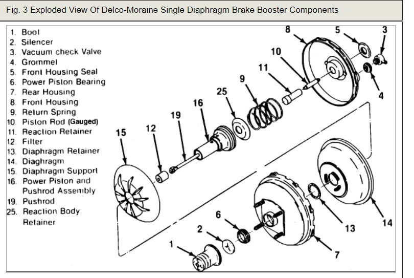

I just replaced the master cylinder and bled the brakes, but now I have brake pedal with the engine off but when you start the truck the brake pedal goes to the floor.
I'm thinking there is a problem with power booster. Just wondering if I am on the right track. Any help would be good.
Thank you in advance
MERLIN2021
  • 17,250 POSTS
I have seen where the brake booster valve fails causing the brake pedal to go to the floor when the engine is running. So you are on the right track.
This guide can help as well
https://www.2carpros.com/articles/brake-pedal-goes-to-the-floor
Here are some guides to help you.
Cheers
LOBO55707
Yep that was the problem I got a new new and the brakes have never been better.
