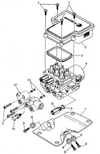

does this master cylender have the abs attached to it or is the abs on its own this is the most common used This will cause the issue you are having EHCU Valve See Figure 1 The EHCU valve is mounted near or under the master cylinder and combination valve. The valve is not serviceable and must be replaced if malfunctioning.
https://images.2carpros.com/forum/automotive_pictures/52960_0900c1528008f6dd_1.jpg
Fig. 1: Exploded view of the Electro-Hydraulic Control Unit (EHCU) Front Wheel Speed Sensors With one exception, on both 2WD and 4WD vehicles, the front wheel speed sensors are permanently mounted to the brake rotor splash shield. With the exception of the 1992-98 Suburban, if the sensor fails the rotor and splash shield must be removed. On 4WD vehicles, the hub and bearing assembly must also be removed for access. The front wheel speed sensors on 1992-98 4WD Suburban vehicles are removable without disassembly of the hub or brakes. Rear Wheel Speed Sensors Except for 1992-93 Suburban, the rear wheel speed sensors are held by 2 bolts at each rear wheel. The brake drum and primary brake shoe must be removed for access. The 1992-93 Suburban receives the rear wheel speed signal from the Vehicle Speed Sensor (VSS) buffer. The VSS is located at the left rear of the transmission. The buffer, a unit for interpreting the electrical signal from the sensor, is located behind the instrument cluster. The buffer, formerly known as the digital ratio adapter controller (DRAC), is matched to the final drive and tire size of each vehicle. If the final drive or tire size is changed, the buffer unit must be replaced to maintain accurate speedometer/odometer readings and proper ABS function.

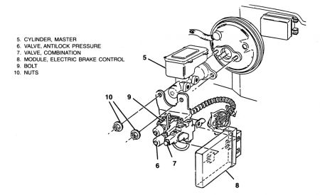

JNOVACK
  • 723 POSTS
Here i another system they used C/K Series MANUAL BRAKES See Figure 2 Disconnect the brake lines at the valve. Plug or cap the lines and ports. Unplug the switch wiring connector. Remove the valve-to-bracket bolts. To install: Install the valve. Tighten the bolts to 20 ft. lbs. (27 Nm). Bleed the system.
https://images.2carpros.com/forum/automotive_pictures/52960_0900c1528008f731_1.jpg
Fig. 2: Combination valve-C/K Series POWER BRAKES Disconnect the brake lines at the switch. Plug or cap the lines and ports. Unplug the warning switch wiring connector. Remove the anti-lock brake system control module from the bracket. See the procedure later in this section. Remove the bolts attaching the ABS isolation/dump valve to the bracket. See the procedure later in this section. Remove the nuts that attach the master cylinder and bracket to the booster. Remove the bracket and combination valve assembly. To install: Position the bracket/valve assembly and install the master cylinder-to-booster nuts. Tighten the nuts to 20 ft. lbs. (27 Nm). Install the ABS isolation/dump valve nuts. Tighten them to 21 ft. lbs. (24 Nm). Install the ABS control module. Connect the wiring. Connect the hydraulic lines. Bleed the system. SWITCH CENTERING Whenever work on the brake system is done it is possible that the brake warning light will come on and refuse to go off when the work is finished. In this event, the switch must be centered. Raise and support the truck. Attach a bleeder hose to the rear brake bleed screw and immerse the other end of the hose in a jar of clean brake fluid. Be sure that the master cylinder is full. When bleeding the brakes, the pin in the end of the metering portion of the combination valve must be held in the open position (with the tool described in the brake bleeding section installed under the pin mounting bolt). Be sure to tighten the bolt after removing the tool. Turn the ignition key ON. Open the bleed screw while an assistant applies heavy pressure on the brake pedal. The warning lamp should light. Close the bleed screw before the helper releases the pedal. To reset the switch, apply heavy pressure to the pedal. This will apply hydraulic pressure to the switch which will re-center it. Repeat Step 5 for the front bleed screw. Turn the ignition OFF and lower the truck. If the warning lamp does not light during Step 5, the switch is defective and must be replaced.

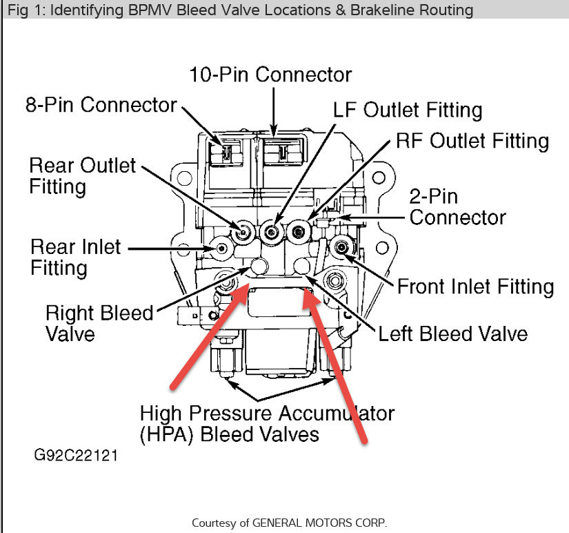

This is a common problem with these trucks you must get a ABS scanner that will open the ABS valves to let the air out.
Here is a video to show you how to connect.
https://youtu.be/rTtAnsOlZU4
If that does work I would get hold of three vise grips and clamp off all the flexible brake hoses, see how the pedal is then. if it is firm the problem will be in one of the brakes if it sinks it is the master cylinder.

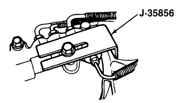

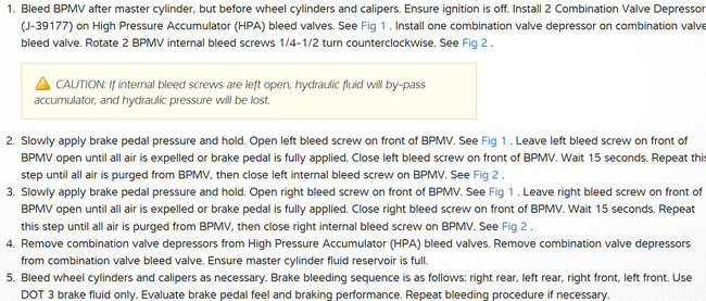

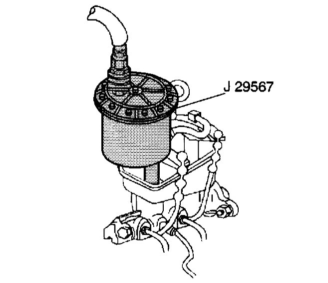

Good morning.
Do you have ABS? If you do there is a bleeding procedure you must follow.
Pressure Bleeding:
Note: The pressure bleeding equipment must be of the diaphragm type. It must have a rubber diaphragm between the air supply and the brake fluid to prevent air; moisture, oil, and other contaminants from entering the hydraulic system. Also adapters are needed. depending on the type of master cylinder used.
Tools Required:
J-29567 Brake Bleeder Adapter (Plastic Reservoir)
J-35856 Combination Valve Depressor
Note: It is very important that the correct master cylinder bleeder adapter be used to avoid possible damage to the master cylinder reservoir.
imageZoom/Print
1. Fill the pressure tank at least 1/3 full of brake fluid. The bleeder must be re-bled each time fluid is added.
a. Charge the bleeder to 140 - 170 kPa (20 to 25 psi).
2. Use J-35856 to depress and hold the valve stem on the combination valve during the bleeding operation.
imageZoom/Print
a. Install the bleeder adapter so the leg with the release valve is towards the cowl.
3. Bleed each wheel in the following sequence.
a. Right rear
b. Left rear
c. Right front
d. Left front
4. Connect the hose from the bleeder to the adapter at the master cylinder.
a. Open the tank valve.
5. Attach a hose to a brake bleeder screw.
a. Immerse the opposite end of the hose into a container partially filled with clean brake fluid.
6. Open the bleeder screw at least 3/4 of a turn and allow the fluid to flow until no air is seen in the fluid.
a. Close the bleeder screw.
7. Repeat step six at all the wheels.
8. Open the bleeder screw on the Isolation/Dump Valve (vehicles with power brakes only).
a. Allow the fluid to flow until no air is seen in the fluid.
b. Close the bleeder screw.
9. Check the brake pedal for "sponginess", repeat the entire bleeding procedure if this condition is found.
10.Remove J-35856.
a. Disconnect the line from the bleeder adapter.
b. Remove bleeder adapter.
11.Fill the master cylinder to the proper level with brake fluid.

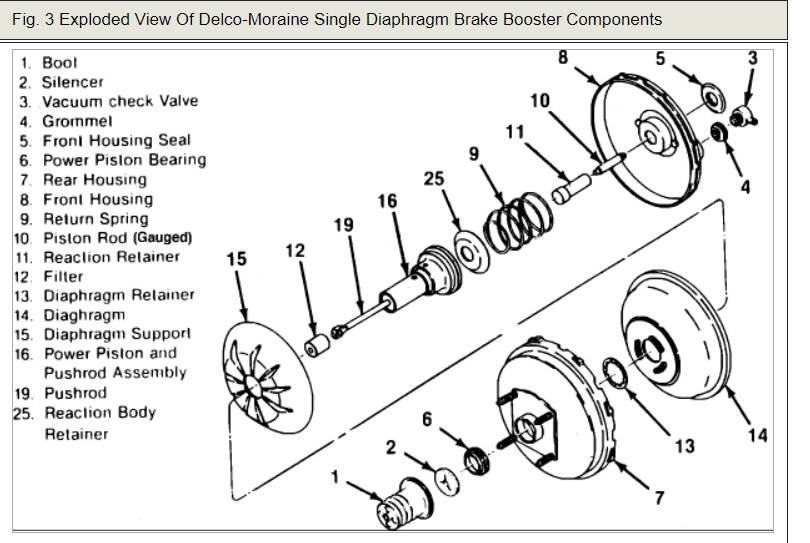

I just replaced the master cylinder and bled the brakes, but now I have brake pedal with the engine off but when you start the truck the brake pedal goes to the floor.
I'm thinking there is a problem with power booster. Just wondering if I am on the right track. Any help would be good.

I have seen where the brake booster valve fails causing the brake pedal to go to the floor when the engine is running. So you are on the right track.
This guide can help as well
https://www.2carpros.com/articles/brake-pedal-goes-to-the-floor

LOBO55707
Yep that was the problem I got a new new and the brakes have never been better.
