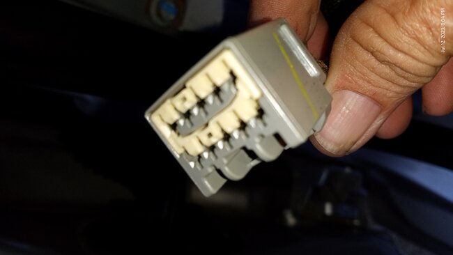

I replaced the battery, starter and bought a programmed PCM and had alternator checked, it's good, new fuel pump too. My problem is the car was already in lock out mode, the airbag light is on, and theft light and mil are all on but not flashing, only for bulb check. My battery kept draining before I replaced the PCM, so I lost power to the PCM, I have the code to relearn, but I can't get it to a shop. I also found this plug in loose under the left side of the dash and some wires pinned under the starter that I don't know where they go.

The connector is used when the car is manufactured so don't worry about it. With the new PCM installed let's run the codes to see what comes up, this will give us a direction to go in. You can get a CAN scanner (Controller Area Network) which will work on most cars from Amazon.

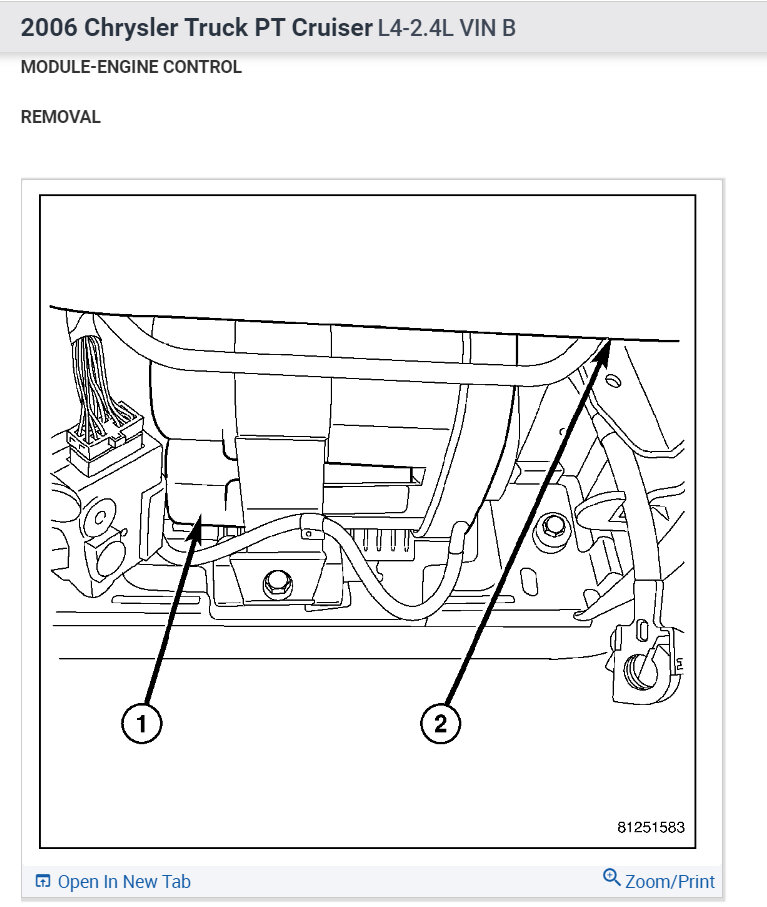

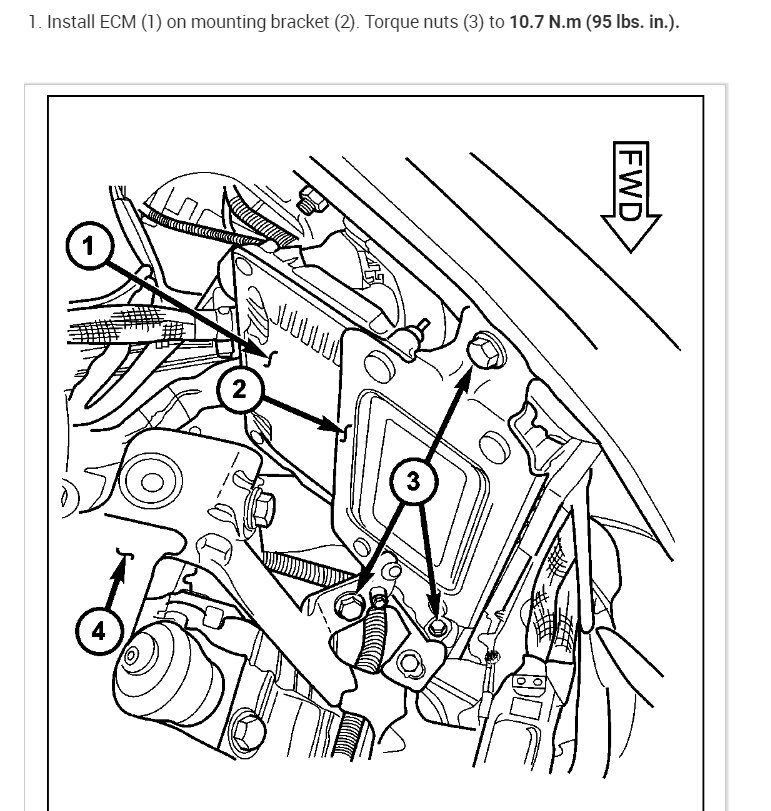

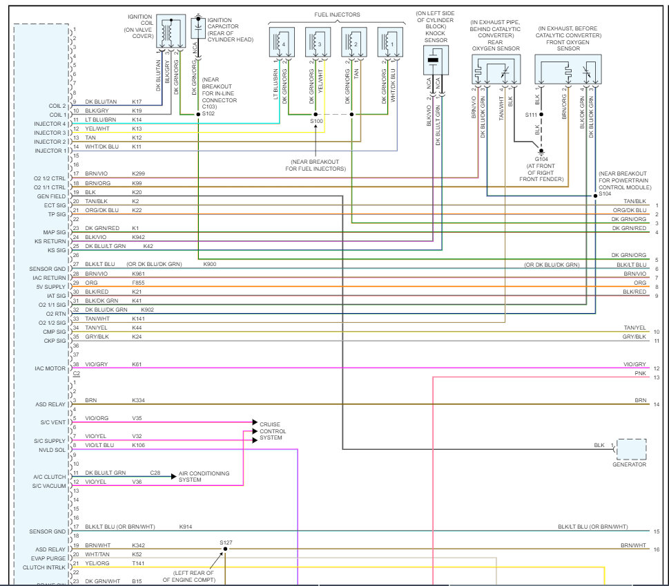

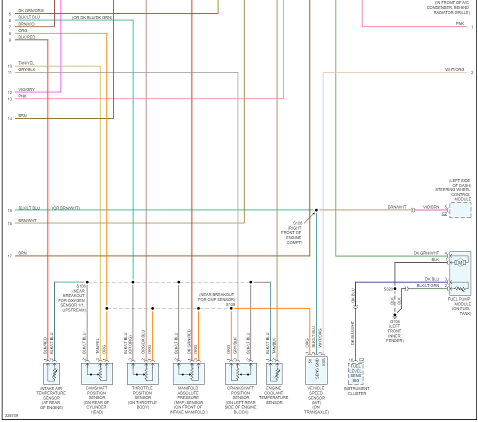

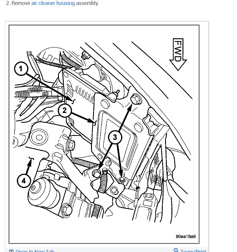

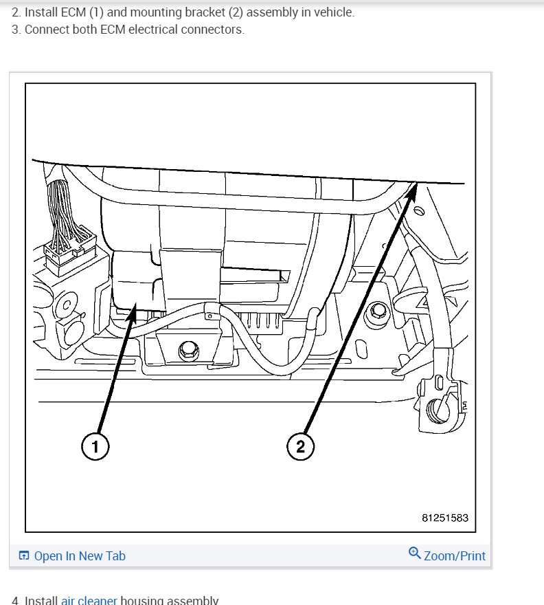

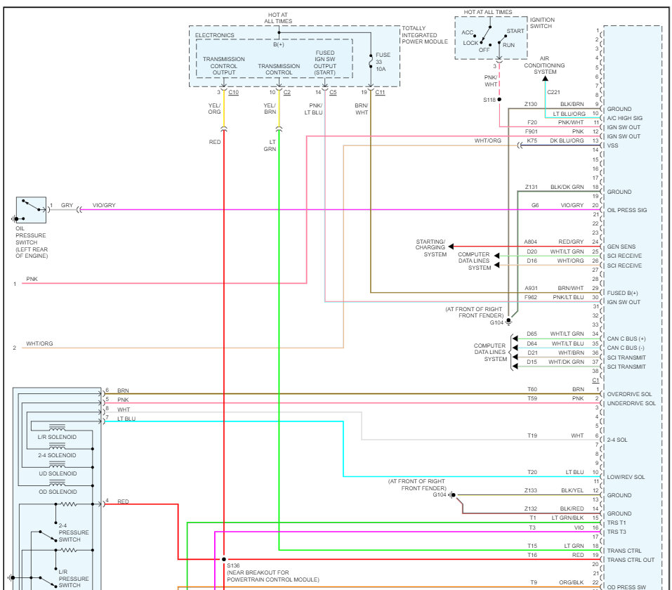

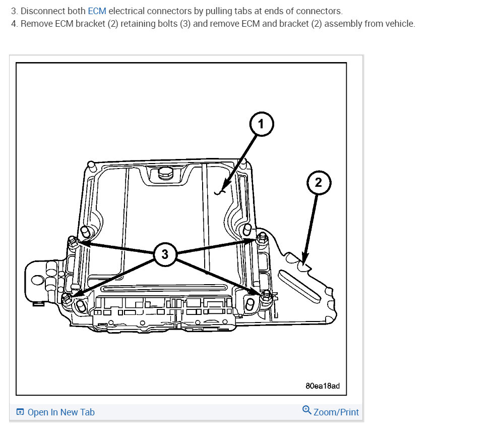

  • 55,859 POSTS

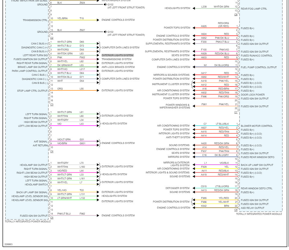

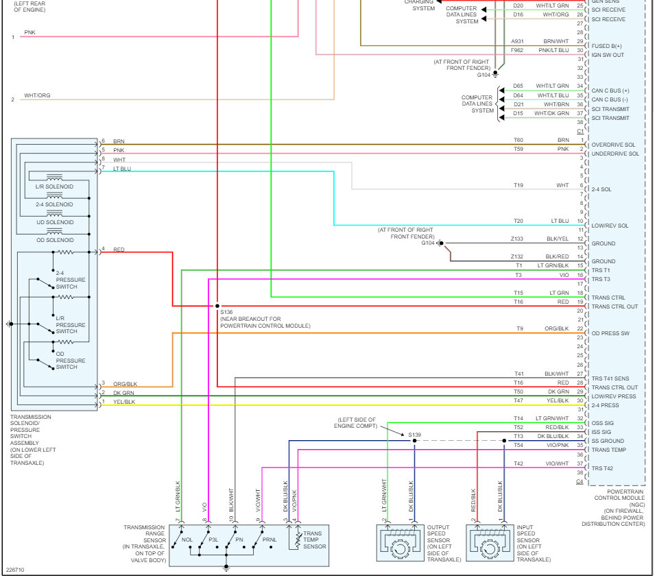

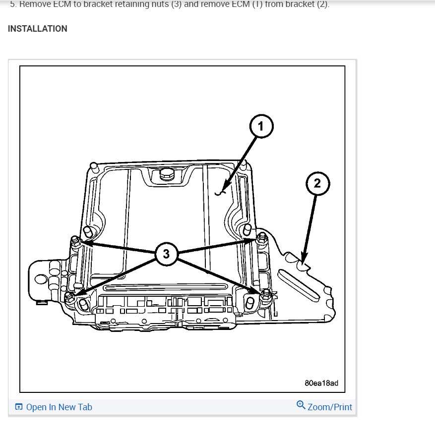

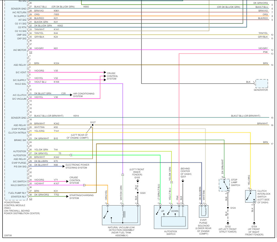

It sounds like the PCM is not programmed correctly, here is how to swap it out and I have included the PCM wiring diagrams so you can see how the system works and where to test the grounds and power inputs.
Check out the images (below). Please let us know what you find.

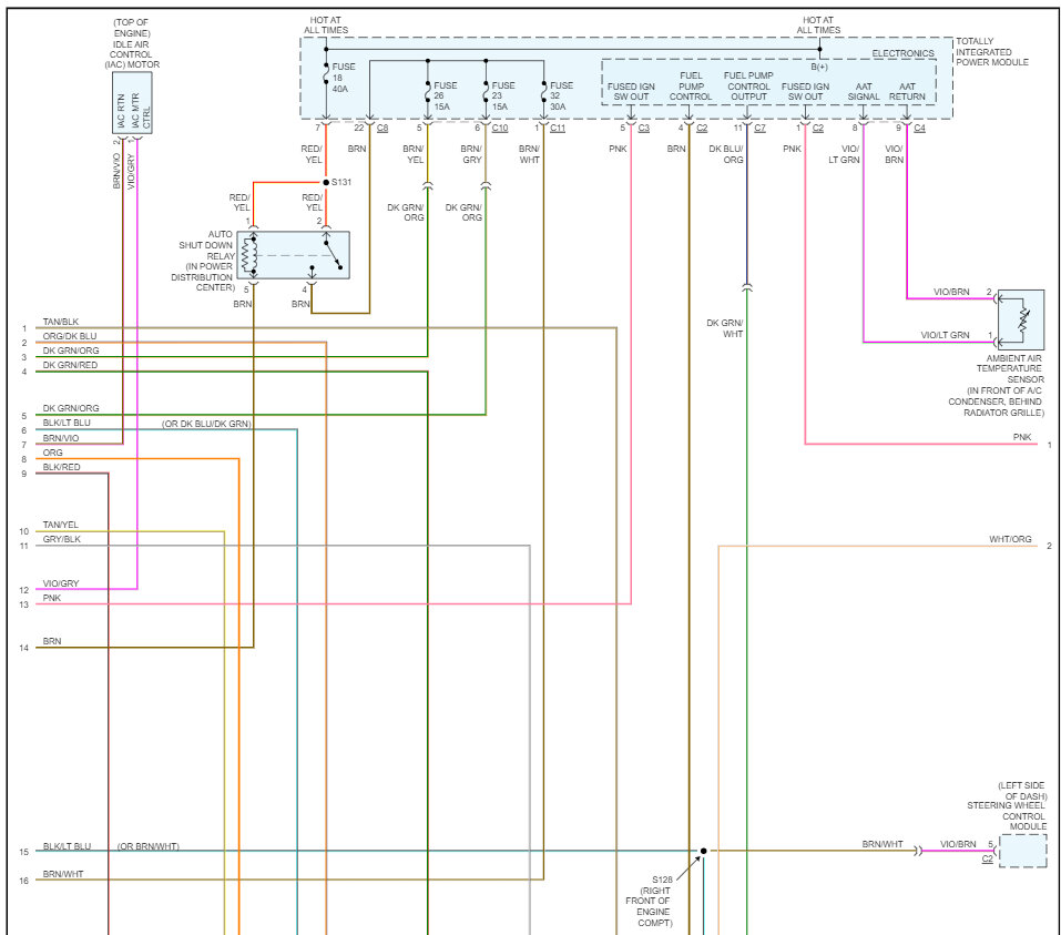

SHERIENNIS4

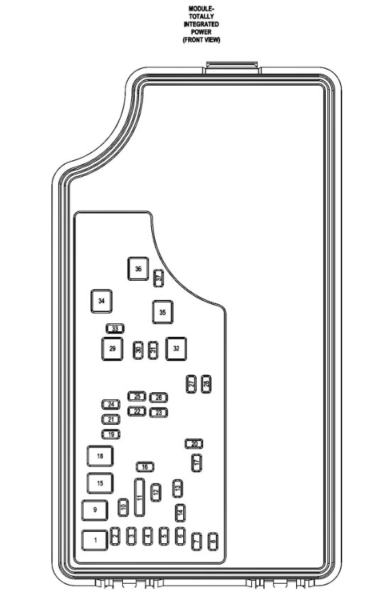

  • 32 POSTS
I have narrowed it down to the auto shut down relay,fuses 23&26, there's nothing wrong with the 15amp fuses just not getting nothing from the wires, I know they are the engine asd feed,the ylw/gry wire to the relay was cut and probably shorted out,so how do I fix this problem, please help me.
Jul 22, 2023 at 10:57 AM
  • 55,859 POSTS

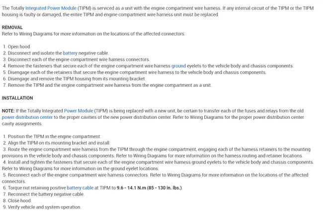

It sounds like the TIPM is not working, which is common, you should do a CAN scan to confirm the issue. Here is how to change out the TIPM which is easy because it-self initializes. Check out the images (below). Please let us know what happens.
Jul 23, 2023 at 7:30 AM

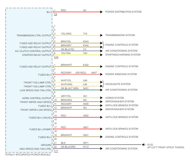

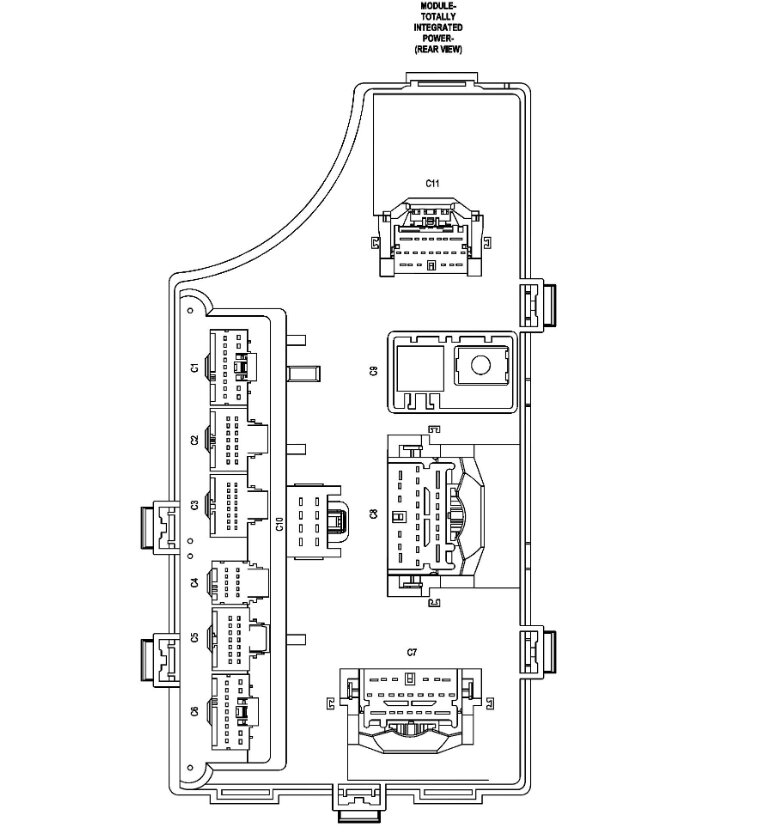

  • 55,859 POSTS

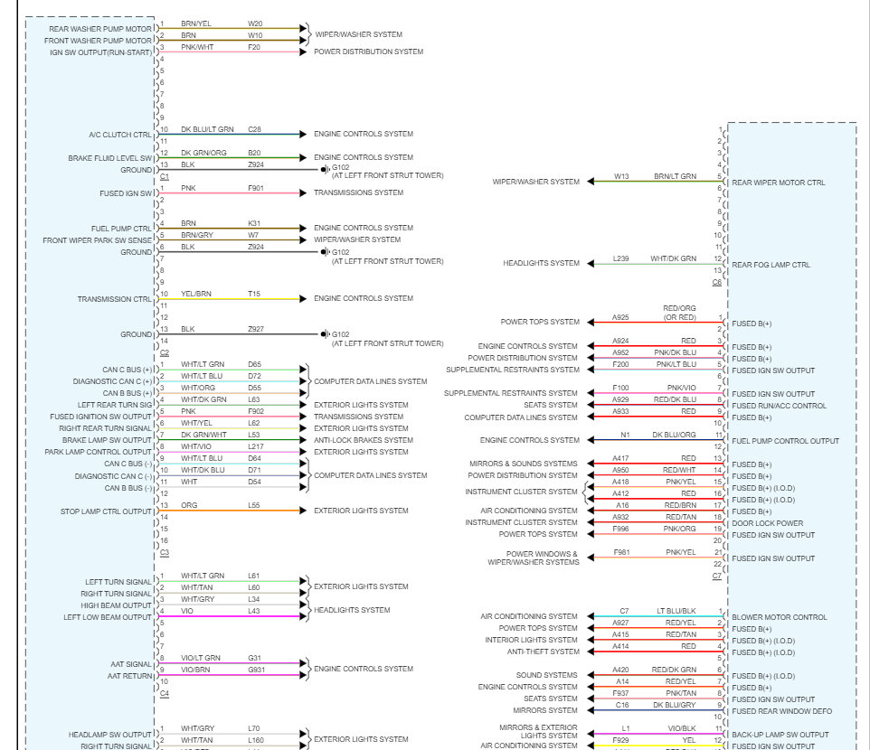

Can you clear the codes and then turn the key on without trying to start the engine and then run the codes to see which one comes up, this will tell us the hard codes and give us a better idea of what's going on. Here is the power and grounds for the TIPM, you might have a defective unit btw.
