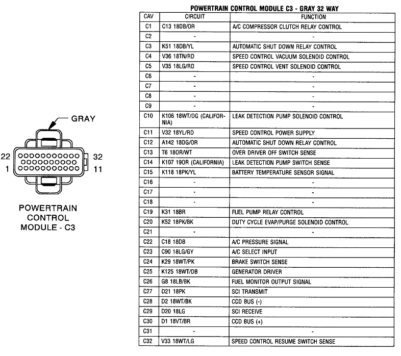

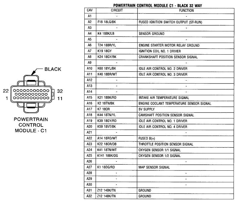

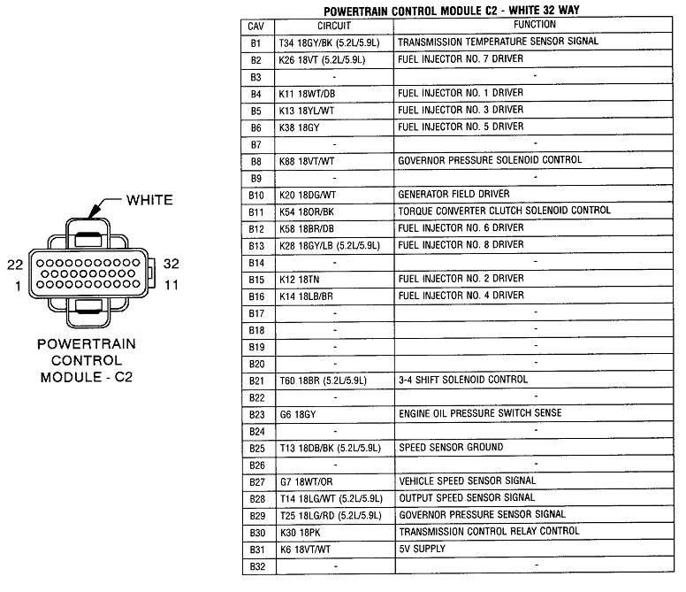

Need PCM pin out diagram.
Feb 9, 2025 at 5:17 PM
CARADIODOC
  • 34,321 POSTS
These are for a 1500 model.
Feb 9, 2025 at 5:42 PM
MILES2

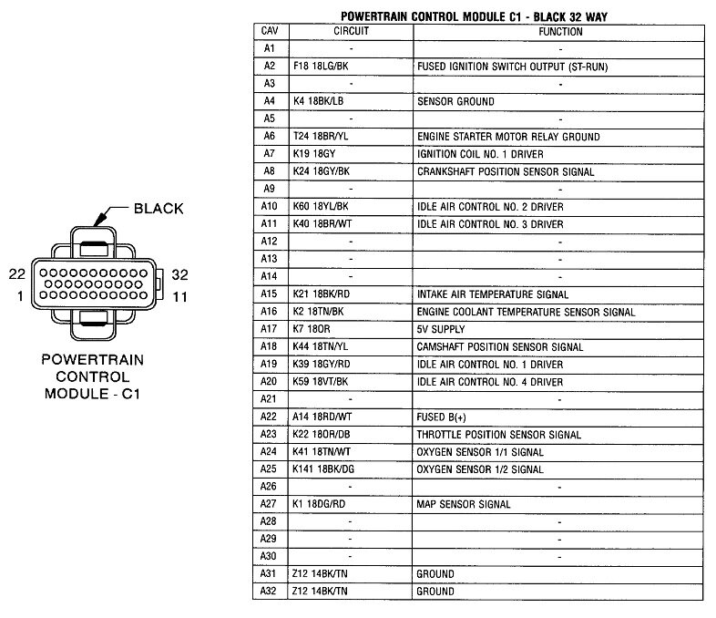

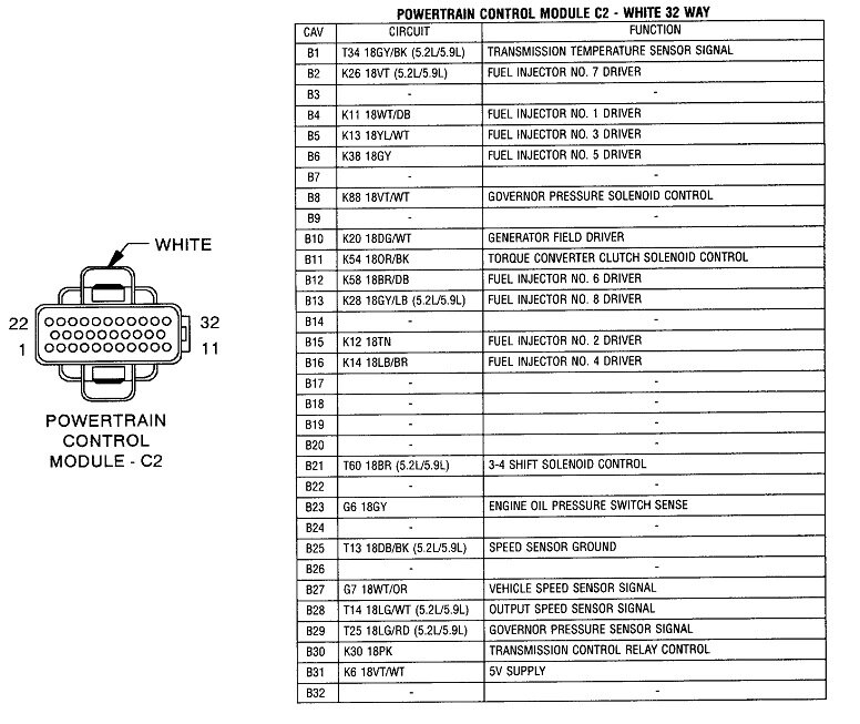

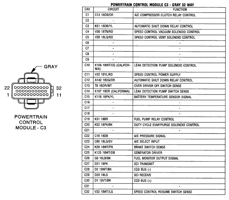

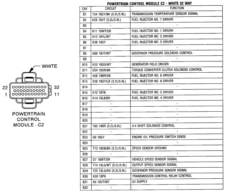

Is the 3500 (5.9l) van different?
Feb 12, 2025 at 7:48 PM
CARADIODOC
  • 34,321 POSTS
Rather than comparing each terminal and risk overlooking something, these are for the 3500.

I'm having the dreaded PCM issue. Do you have a PCM component schematic? Mainly looking for the location of a 12v step up transformer inside PCM.
Feb 23, 2025 at 11:50 AM
CARADIODOC
  • 34,321 POSTS
That is something you will never find. All computer modules from all car manufacturers are proprietary, and service manuals are not released.
