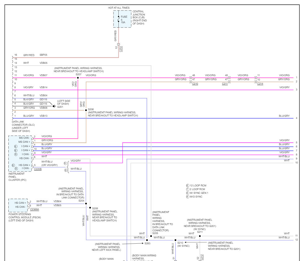

I need pinout for the vehicle listed above diesel.
Jul 17, 2023 at 12:26 PM
  • 55,423 POSTS

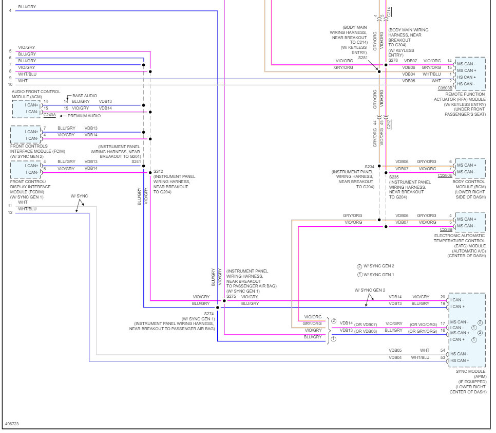

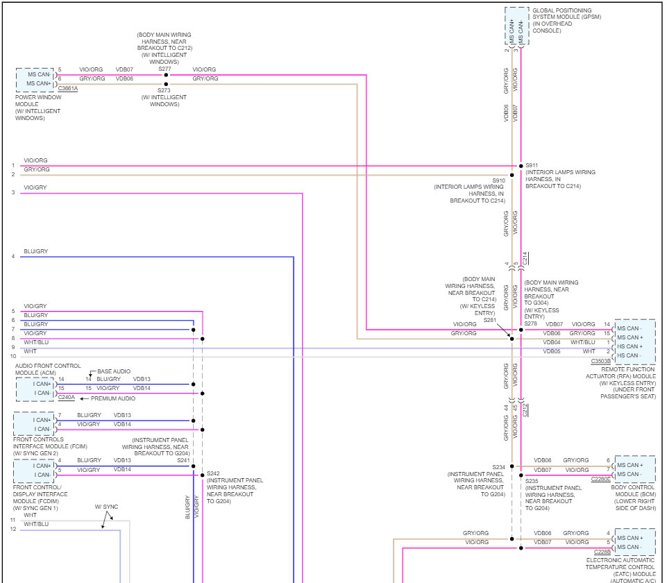

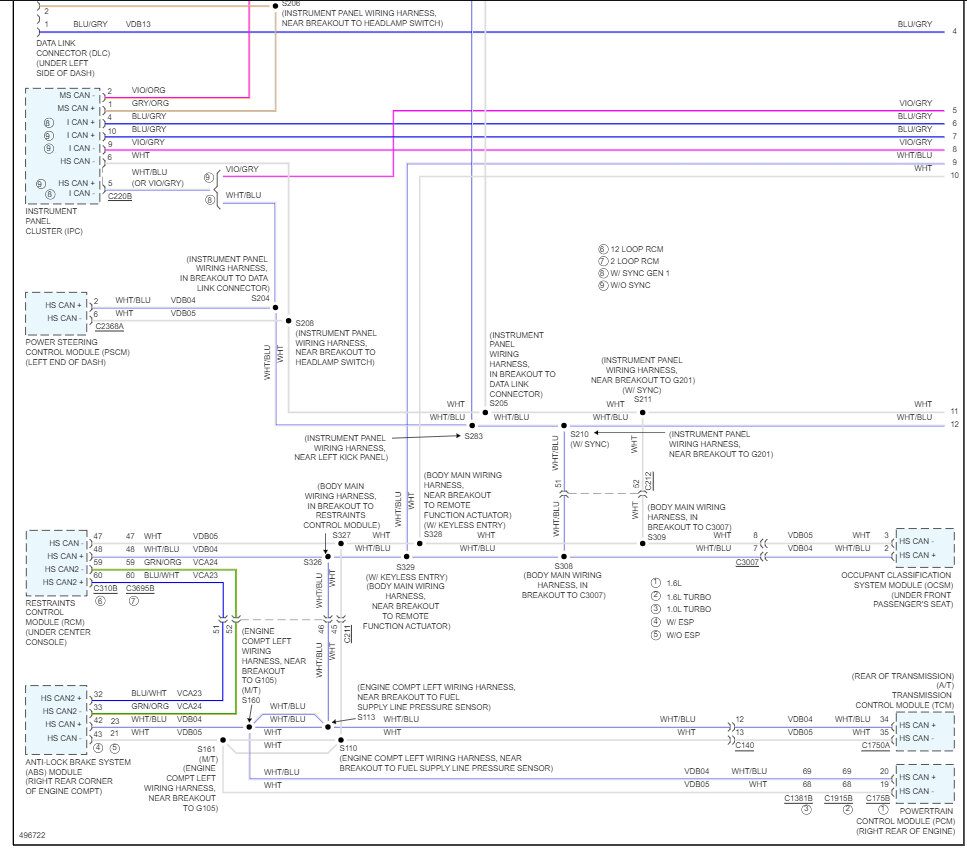

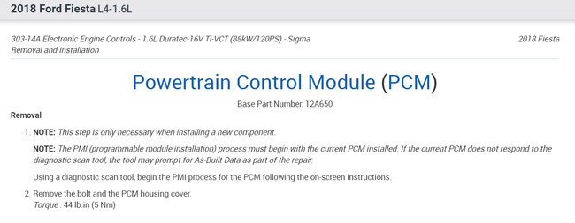

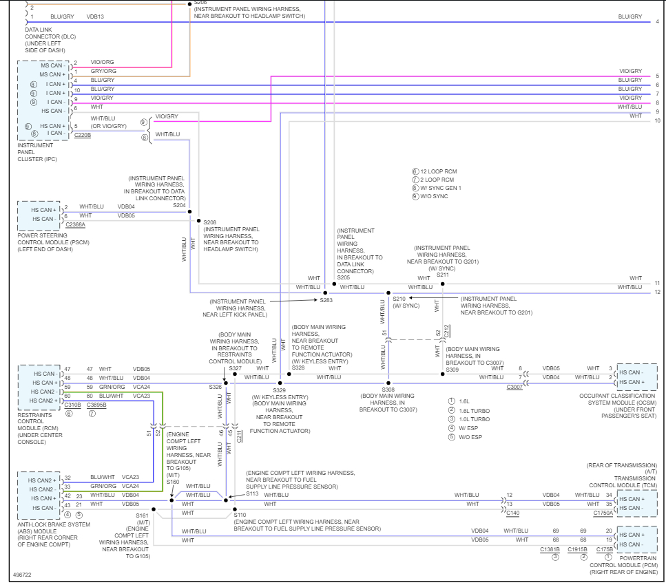

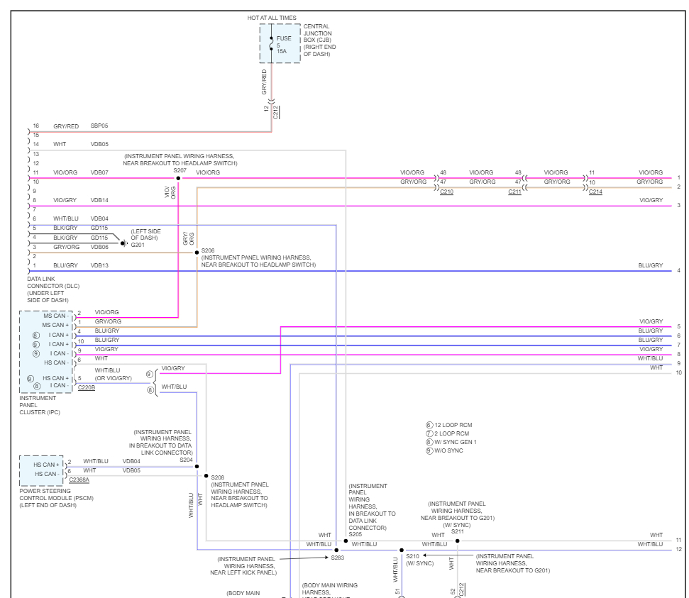

The first thing I would do is check the scanner in another car to see if it works, next check the fuse # 5 - 15 amp in the central fuse panel at the right end of the dashboard. This guide can help:
Here are the wiring diagrams for the ALDL connector and a guide to help you check the power and ground for the system. You may have a bad PCM.

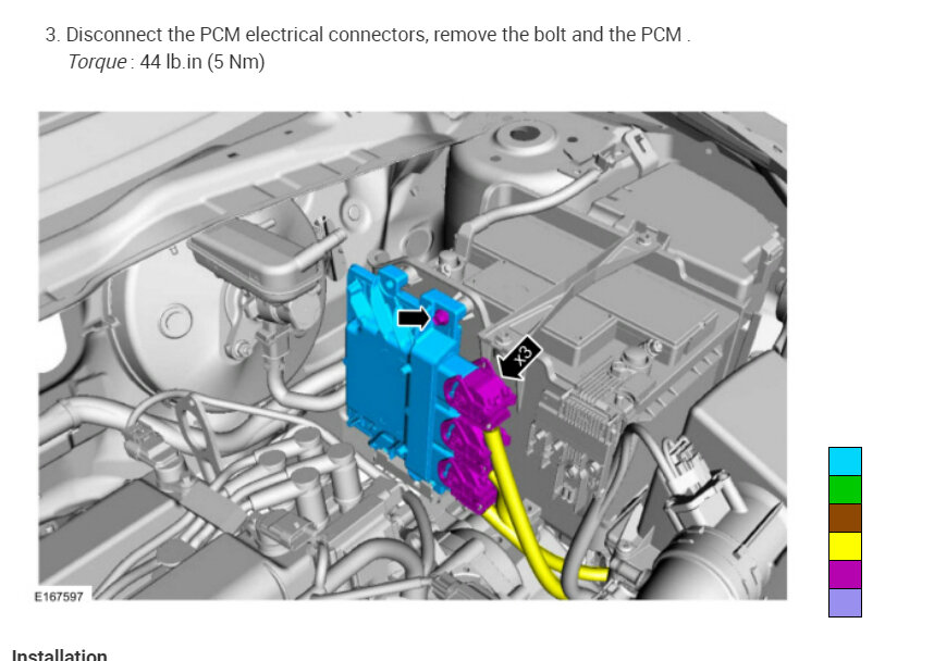

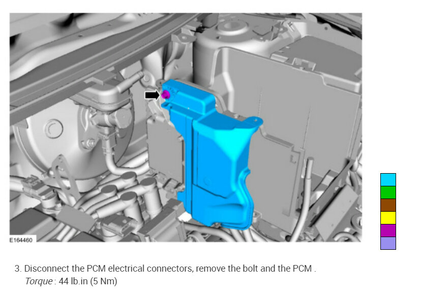

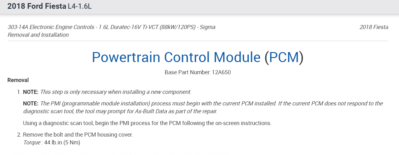

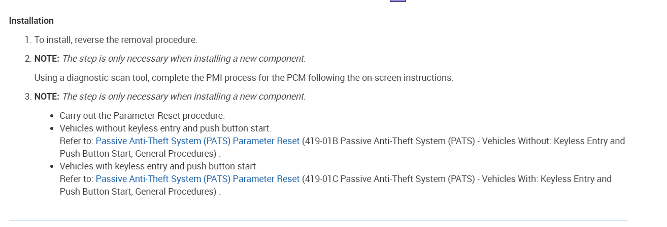

Here is how to change the engine control module out in case you need it, you can get a preprogrammed unit by searching Google or Ebay. Check out the images (below). Please let us know how it goes.
