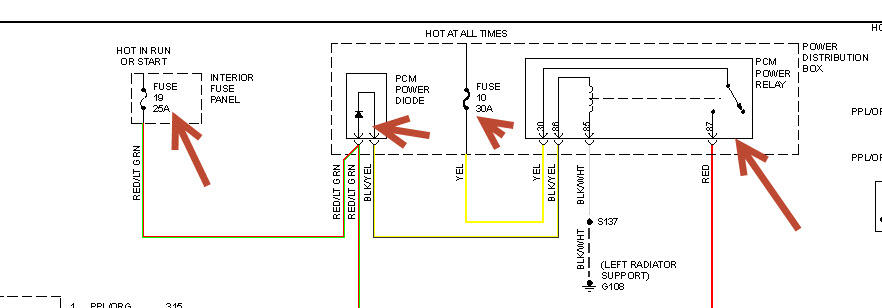

have the battery tested for condition and load test, not it's good cause it cranks in morning.ok what engine is in this and check the tings in pic that I have pointed out

Ok, I have had the battery tested, and I also have checked all of the fuses inline.
Finally received a trouble code stating an o2 sensor was slow, could that be the cause of this problem? also it still forgets the engine over a 5 hour period on not being run.
