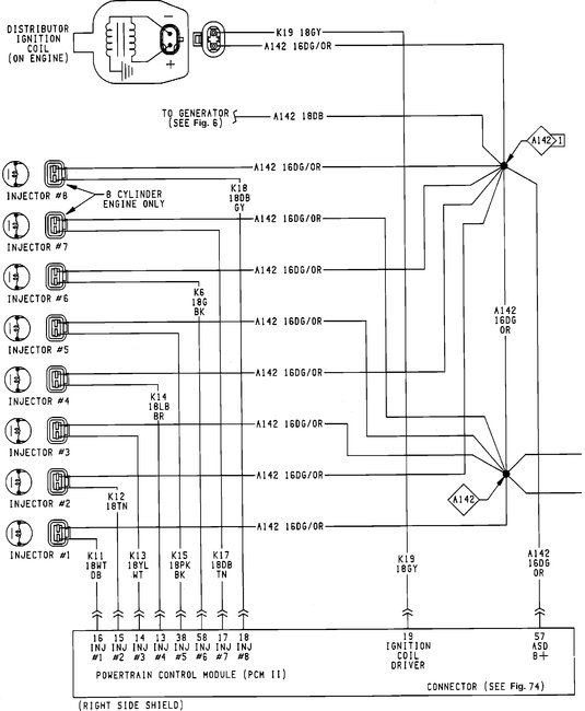

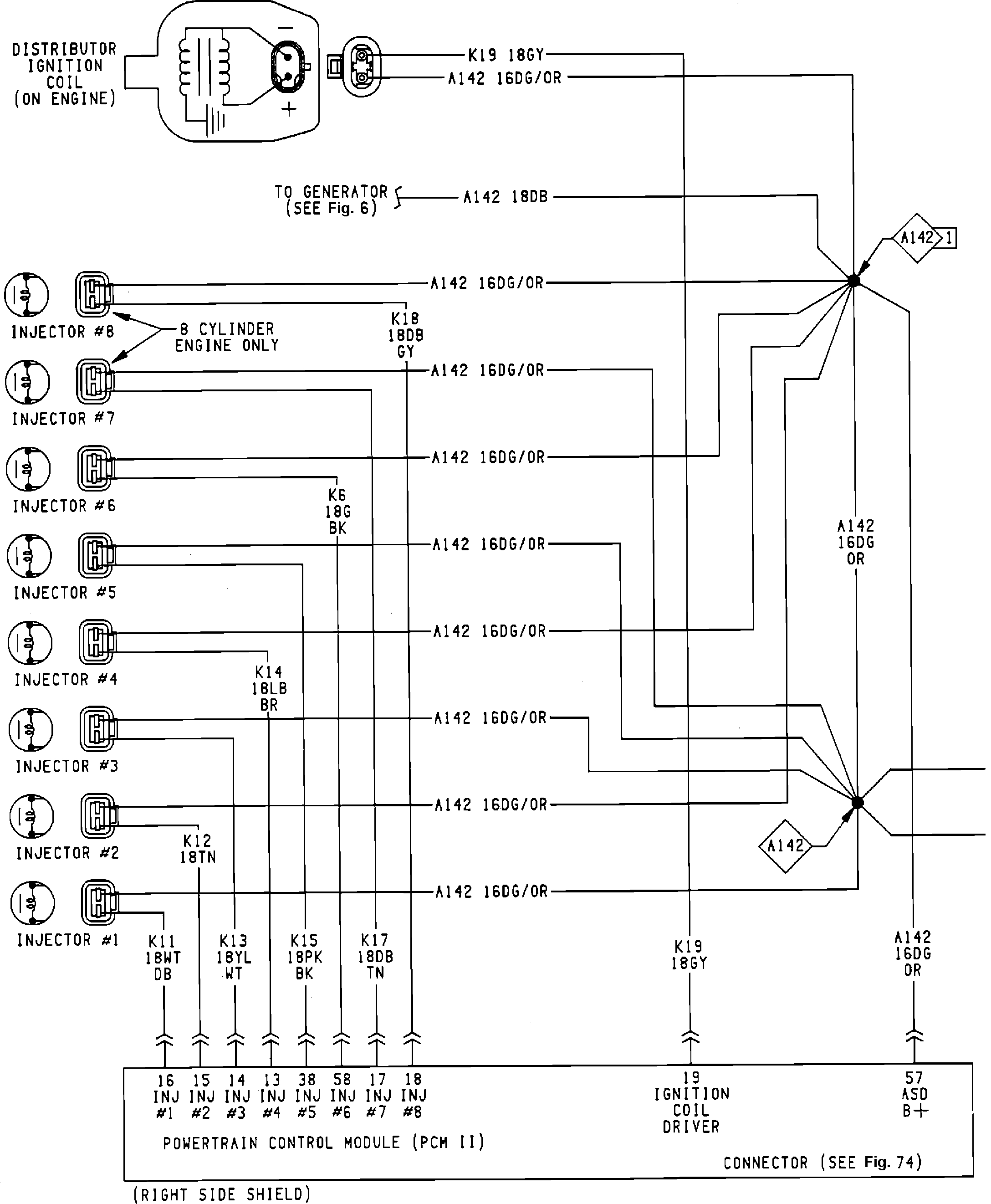

Hello and thank you to all who read my question. I need to know where the wires for the seventh and eighth injector wires would go on the PCM connector. I'm looking to swap my v6 with the 318 magnum. I've already sourced my engine from a 1994 Dakota but I need to add the extra injector plugs for it to run properly.
Thanks for any help.

I've attached a picture below with the PCM/injector wiring. Hope this helps and thanks for using 2CarPros.

Thank you very much this diagram helped out a lot. Now I'll be mating the 318 to the ax15 transmission and I know I have to swap the flex plate out for a flywheel but would I use the v6 clutch on the 318?
