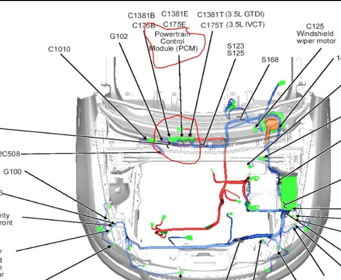

Hello
Where is PCM location under hood
Thank you

So it is a little hidden under the hood, it will be at the firewall with 3 large electrical connectors on it. Here is the location, Check out the images (below). Please let us know what happens.

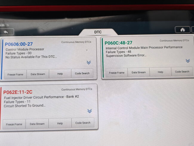

Is pcm same as ecu,becouse i have ecu under fender.i have codes
P0606:00-27,P062E:11-2C(Bank #2 failure) circuit shorted to ground.P060C:48-27..i have changed injectors and ecu..sometimes cant connect obd scsnner to car

This was scaned

Yes, the PCM is the same as the ECU.

So with these codes I would test all fuel injectors because one might be shorted to ground causing the issue with the PCM/ECU Here is a guide to help help with the testing.
https://www.2carpros.com/articles/how-to-test-a-fuel-injector
Please go over this guide and get back to us.

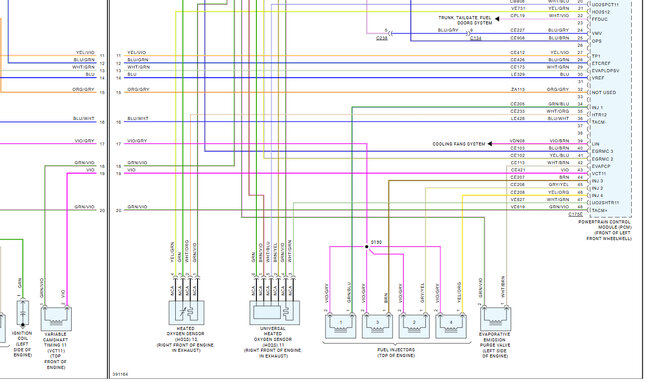

Injectors are new 0miles,can i recive wire diagram from injector bank 2 to ecu?

So the injectors are power by the fuse #34 in the fuse panel under the hood so I would check that. Here is a guide to help you check the wiring, with the injector wiring diagrams below.
Check out the images (below). Please let us know what happens. Ken
