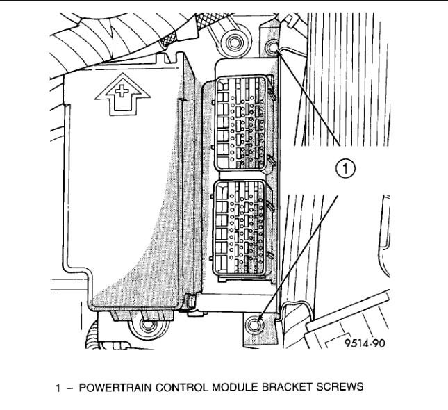

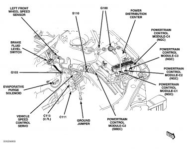

Where is the PCM located?
May 23, 2020 at 9:58 PM
Good morning,

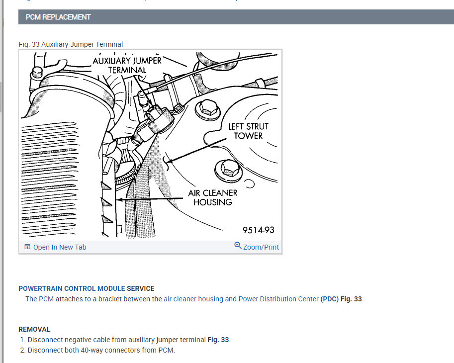

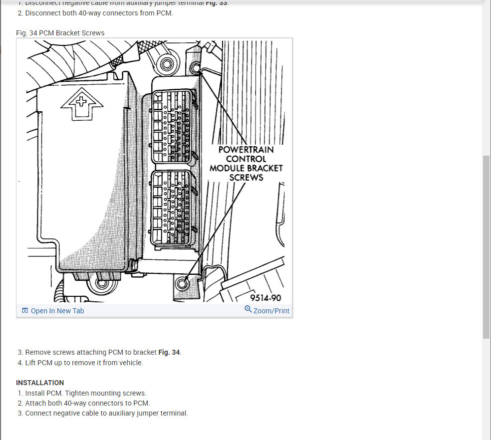

I attached the procedure below as well as a picture.
Why are you changing the ECM?
NOTE: The PCM engine control strategy prevents reduced idle speeds until after the engine operates for 320 km (200 miles). If the PCM is replaced after 320 km (200 miles) of usage, update the mileage and Vehicle Identification Number (VIN) in the new PCM. Use the DRB scan tool to change the millage and VIN in the PCM. If this step is not done, a Diagnostic Trouble Code (DTC) may be set. Refer to the appropriate Powertrain Diagnostic Procedure and the DRB scan tool.

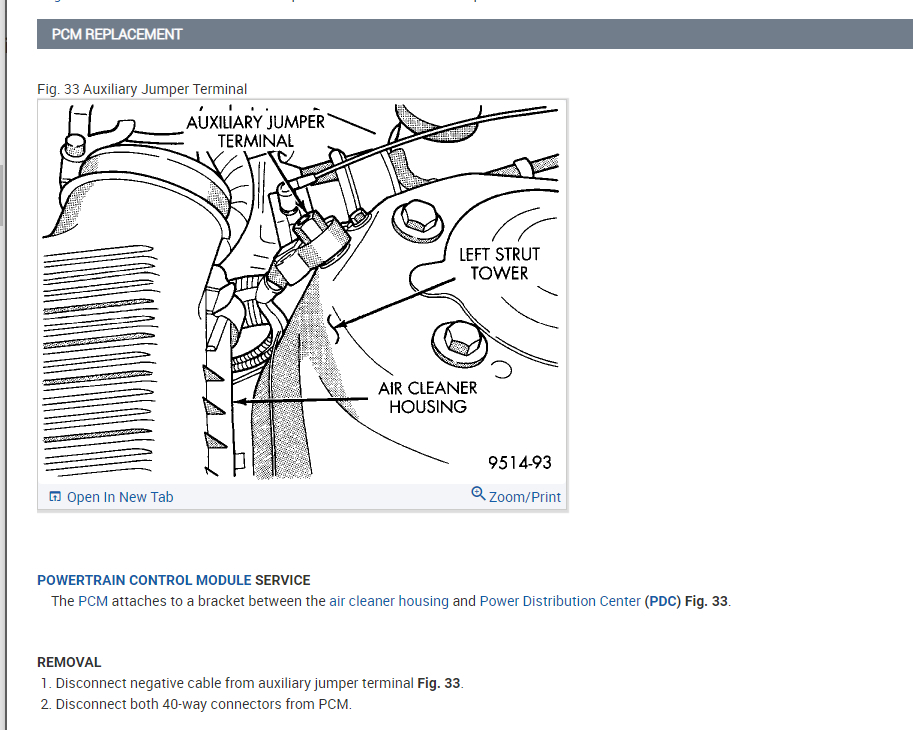

The PCM attaches to a bracket between the air cleaner housing and Power Distribution Center (PDC).
REMOVAL
Auxiliary Jumper Terminal
1. Disconnect negative cable from auxiliary jumper terminal.
2. Disconnect both 40-way connectors from PCM.
PCM Bracket Screws
3. Remove screws attaching PCM to bracket.
4. Lift PCM up to remove it from vehicle.
INSTALLATION
1. Install PCM. Tighten mounting screws to 4 Nm (35 in.lbs.).
2. Attach both 40-way connectors to PCM.
3. Connect negative cable to auxiliary jumper terminal.

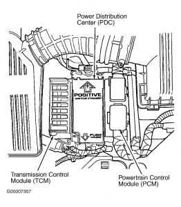

where is the shift module located
Dec 9, 2020 at 1:02 AM (Merged)
ZACKMAN
  • 4,202 POSTS
Do you mean transmission control module? Under the hood, next to the power distribution center.

The pcm is located near the air cleaner.
If you get one that has anti-theft programmed into it and yours doesn't, The used pcm will teach the BCM that it should have anti-theft and will not start the car until you fix the anti-theft problem in a system that you don't have. Then your into another pcm and bcm.
I attached the process from the manual below. Please let us know what questions you have. Thanks

DADACTA
I'm having trouble finding out if my car has a PCM or ECM. My problem is that i need the original number of whichever one of these modules my car uses and I have no idea where the this module is located. So, if anyone could tell me where i can find this module i'd really appreciate it.
Dec 9, 2020 at 1:07 AM (Merged)
ZACKMAN
  • 4,202 POSTS
The term PCM and ECM are usually used interchangeably to describe the computer. Powertrain Control Module or Engine Control Module.
In your particular case, you have a PCM. Your PCM is under the hood, sandwiched in between your air filter box and the fuse box (where your battery positive remote terminal is). And just to the left of the fuse box is your TCM, Transmission Control Module.
And yes, you can only replace your PCM with the ones that have the same part number.

You have a PCM and it is located on left front fender engine compartment with a bunch of other stuff. It's the ons next to fender with two terminal connectors.

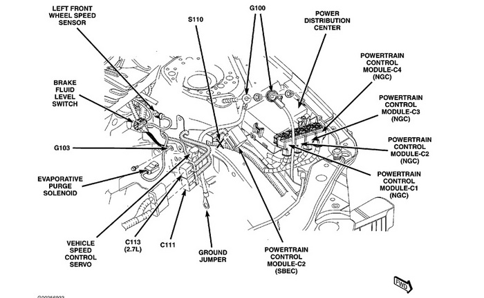

RUBEN PEREZ
WHER IS COMPUTER LOCATED AT?
Dec 9, 2020 at 1:08 AM (Merged)
DOCFIXIT
  • 18,828 POSTS
Left front engine, Check out the diagrams (Below). Please let us know if you need anything else to get the problem fixed.compartment
