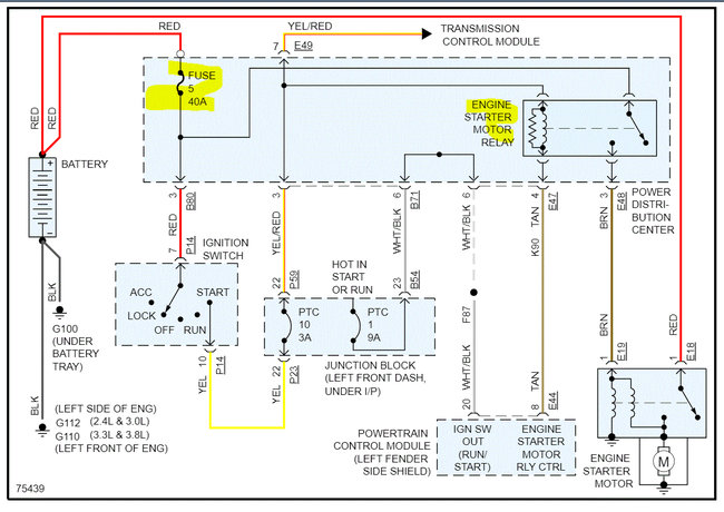

After replacing the PCM nothing happens when I turn the key
1996 DODGE CARAVAN
200,000 MILES • 3.8L • V6 • 2WD • AUTOMATIC
DAVEBOALS
replaced PCM with a new one everything works, but nothing when i turn the key.
Dec 12, 2021 at 5:03 AM
  • 110,240 POSTS

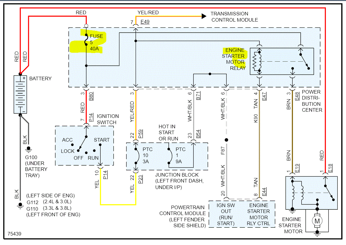

Do you mean when the key is turned to the start position, the starter doesn't engage? Please explain.
If that is the case, confirm fuse 5 in the power distribution box under the hood is good and has power to and from it. Additionally, remove the starter relay and switch it with a different one having the same part number and see if that makes a difference.
I attached the wiring schematic below for the starting circuit for your reference. Additionally, here are two links you may find helpful:
Let me know if that is what is happening. Also, see if it will start if you place it in neutral.
See pic below.
