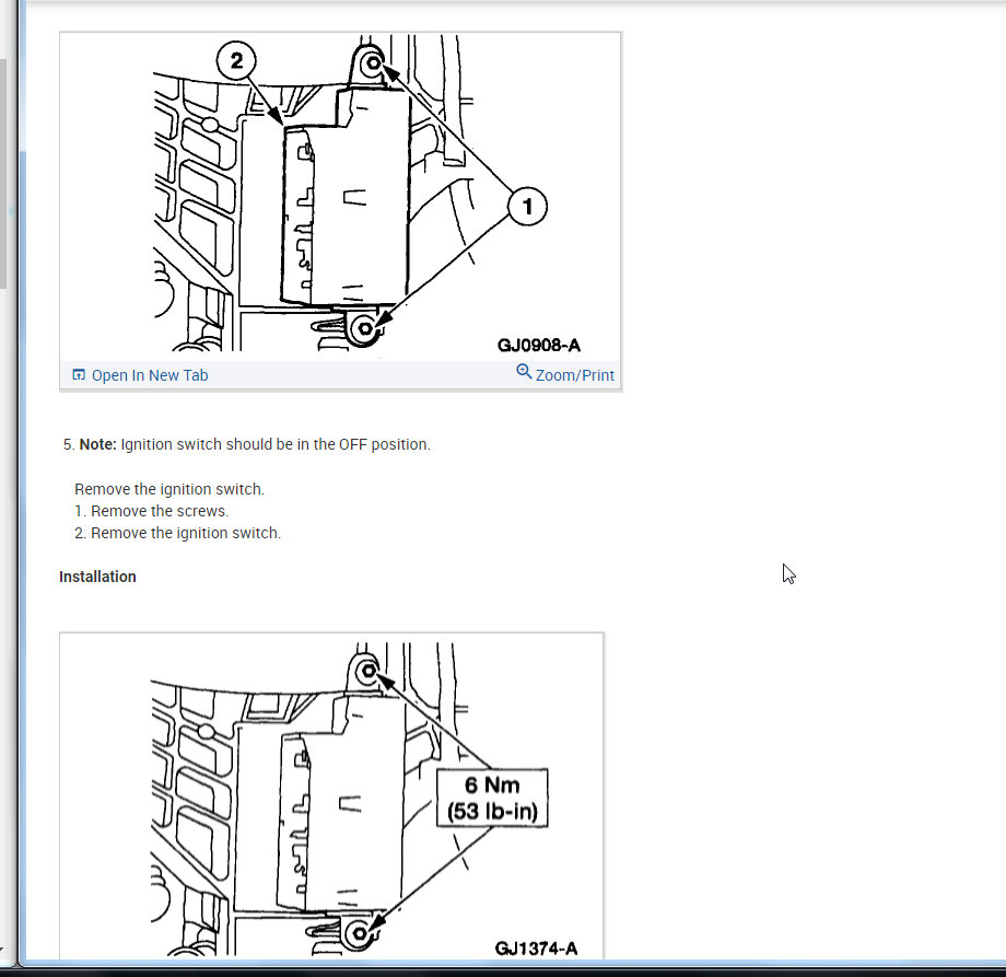

Someone tried to steal my car (listed above) and they took a sledge hammer and screws to my ignition and engaged anti-theft. so I'm wondering how to disengage the PATS anti-theft and/or how do I fix my car the easiest and cheapest way. I'm a single mom and I've been without a car now for 3 months and I live in the middle of nowhere.
Jun 6, 2021 at 11:28 AM
Unfortunately, the only way to repair this would be to replace the components that were damaged and get new keys for it or have the new cylinder keyed to the same key you have.
However, you can get a PCM that has this system removed from it but then that means it will be easier to steal the vehicle. Since this was already attempted, I would just replace the damaged parts so that you can get the vehicle running again.

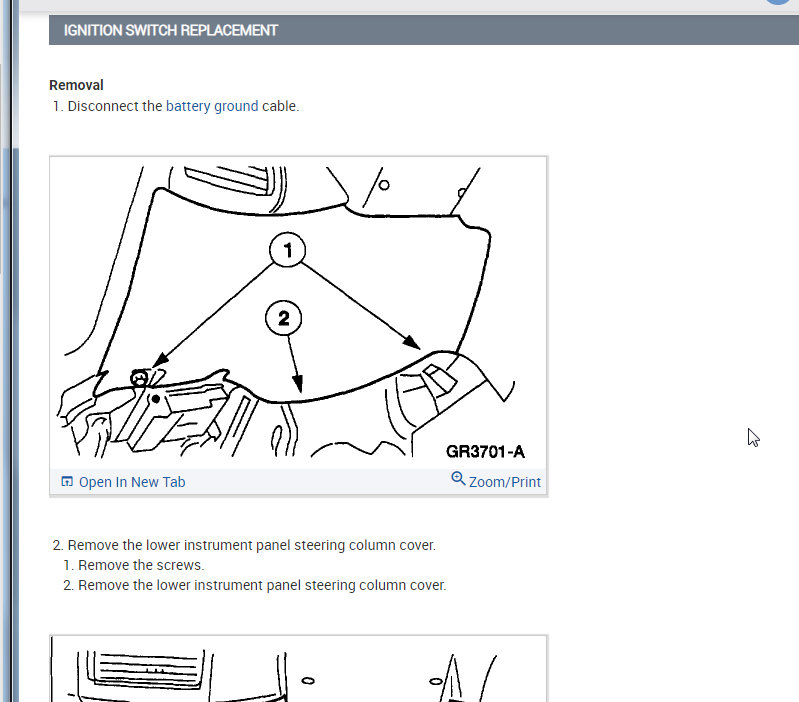

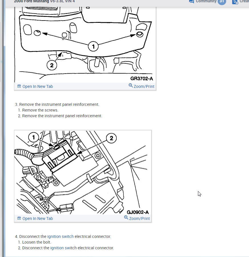

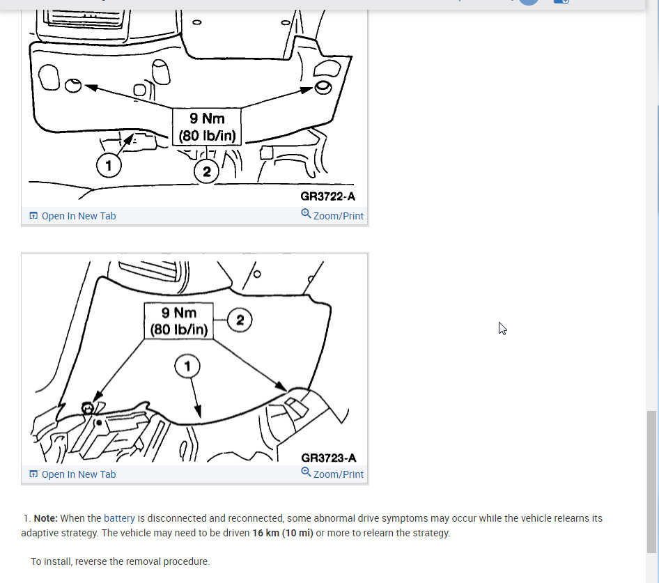

I attached the info on how to replace the ignition switch for your info.
Please let us know if you have other questions and we can go from there. Thanks
