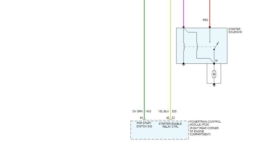

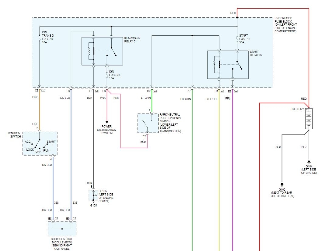

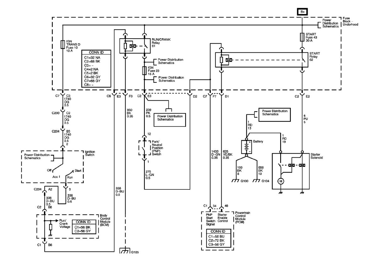

No problem. It can get to be a real pain trying to find issues in modern wiring. Things that should be simple get run through computers and modules and make it much harder. The attached are the wiring diagrams for the starting circuit.

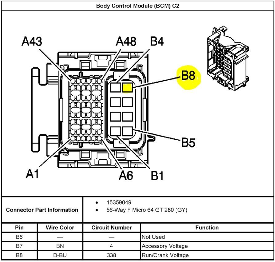

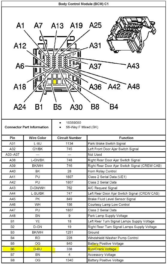

Hey man how's going? Okay, so now that I got the hurricane out the way I think I did some good; I have got it to where when I turn the key to the on position the pass-lock light is on but when turn the key still nothing happens, but the light goes off.
Friday, August 28th, 2020 AT 10:41 AM
STEVE W.
  • 13,577 POSTS
Okay, that means it at least is seeing the key as valid. Now we need to figure out why the switch start signal isn't getting to the relay. For that, verify that the start pin 3 on the switch is sending battery voltage when you turn it to start. If it does then go to the Body Control module and verify that the same signal is there on pin B8 in connector2 If it is then great, if not then that wire is open someplace. If it's good then check pin B6 in connector number 1 for the same signal. If its there good, if not then the BCM has an internal problem as they should be linked. From there it goes out to the start relay. If no signal at the relay the wire has an issue.
