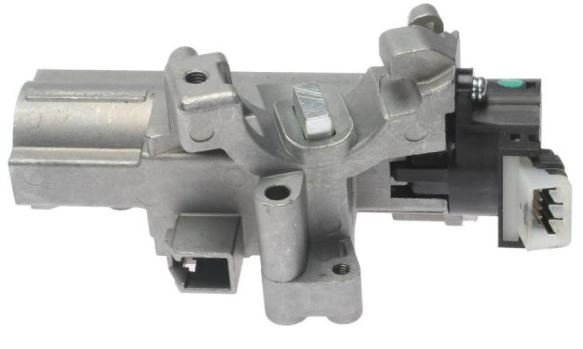

Okay, in that case and that it doesn't turn over when you turn the key I'm thinking it's the ignition switch or the housing itself that are the issue. If it was only the pass-lock system the light would stay on but the engine would turn over, pass-lock turns off the fuel pump only, it doesn't disable the starter. Inside the switch housing are a few plastic pieces that move as the key moves the internals, they tend to break and create problems. They are a common failure item. I prefer to use the OEM parts but there are some available after market. The biggest issue is that replacement key switches are only available as a complete housing switch, this is due to the internal parts being an issue.

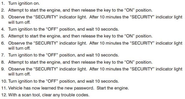

There are a couple other issues to replacing it though, one is that once it is changed you need to reprogram that new part into the system using the 30 minute method. The other is that most of the upper part of the column has to come apart and the steering wheel removed to get into the housing if it is the failure item. This is a video on the process if you wish to do see what the job is like:

Try the 30 minute relearn process in the video. It's in the image below. This is because that piece is now wrong in the eyes of the system and need the relearn performed.

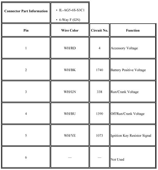

If the light is flashing but it isn't turning over with the key then you have two problems. One is the key isn't recognized which the relearn procedure or a scan tool can correct. The other is that there is still an issue with the ignition switch power, which is likely also why the relearn isn't working, it sounds like the body control module isn't getting the signal from the switch telling it to start.
You say you can get it to crank under the hood, Are you doing that by jumping the relay? If so and you leave the key on, does it run a couple seconds and shut off? If it only cranks without trying to start the problem is more likely the run circuit from the switch not sending power. That circuit also tells the fuel pump to turn on and prime. To see if it may be the issue you can go to the run relay in the same box under the hood. See if you can jumper it and try to start it. Also check the IBN Trans D fuse (10am) in the same box for power.

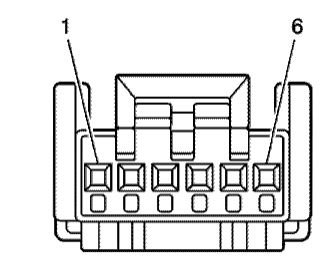

I attached the switch wiring functions below.
Pin 1- Battery voltage in accessory and run positions
Pin 2- Battery voltage constant
Pin 3- Battery voltage in run or start positions
Pin 4- Battery voltage with only key in, 5 volts with key in run position. Less than 5 volts volts in the start position. This is the signal for the key reader having the correct key.
Pin 5- Bias voltage from BCM - 5 volts
To test these you leave the connector in place but use a pin to probe the connections in place for the correct voltages.
In the above video that testing is in the first 6 minutes. If you have the correct voltages in each position then the issue is not in the switch now and is in the relays or wiring.

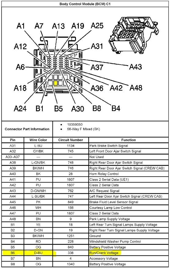

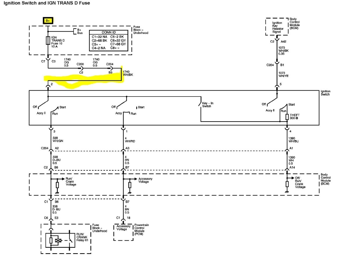

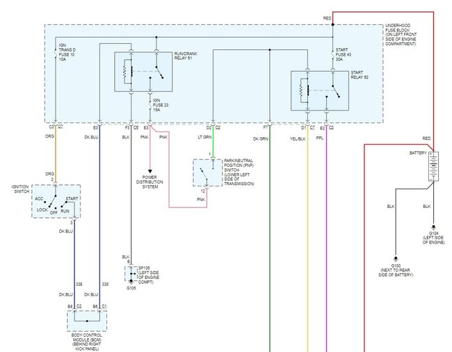

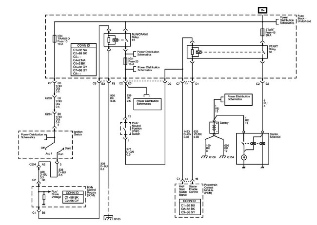

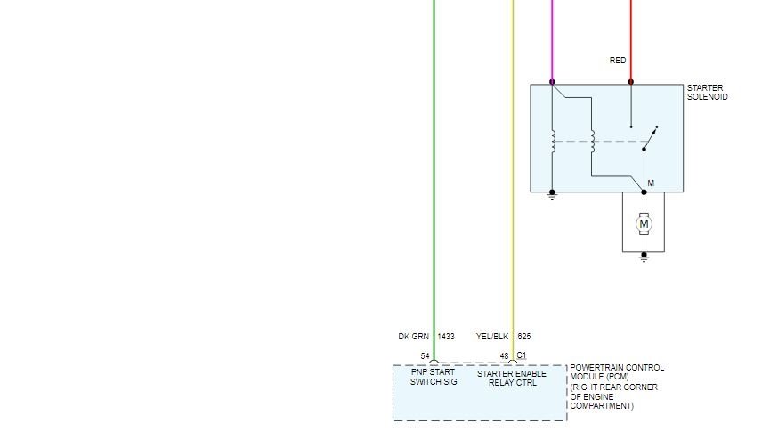

Yeah, it can get that way quick. About the only way to find it would be to either trace the wire harness and look for damage or bad connectors. You might try a jumper wire from the start pin on the switch over to the correct pin on the body control module, that would bypass the connections. If it works every time you would know where the problem is. If not there then From the BCM out to the relay. Or if you could get a good scan tool on it you might be able to watch the switch modes to see if the BCM shows the start signal every time. Another possibility would be to see if a locksmith in your area could use their tools to do the relearn and at least eliminate that part of the problem, that would leave just the hunt for the starting issue.
Aug 23, 2020 at 12:22 PM
CLAY FONTENOT2
  • 18 POSTS
Oh, that's what I will do. I will be in touch.
Aug 23, 2020 at 12:35 PM
STEVE W.
  • 15,349 POSTS
No problem. It can get to be a real pain trying to find issues in modern wiring. Things that should be simple get run through computers and modules and make it much harder. The attached are the wiring diagrams for the starting circuit.

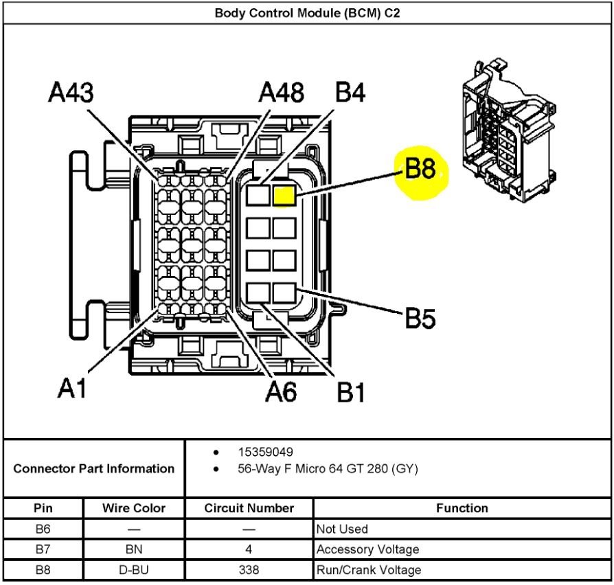

Hey man how's going? okay, so now that i got the hurricane out the way i think i did some good; i have got it to where when i turn the key to the on position the pass-lock light is on but when turn the key still nothing happens, but the light goes off.
Aug 28, 2020 at 3:41 AM
STEVE W.
  • 15,349 POSTS
Okay, that means it at least is seeing the key as valid. Now we need to figure out why the switch start signal isn't getting to the relay. For that, verify that the start pin 3 on the switch is sending battery voltage when you turn it to start. If it does then go to the Body Control module and verify that the same signal is there on pin B8 in connector2 If it is then great, if not then that wire is open someplace. If it's good then check pin B6 in connector number 1 for the same signal. If its there good, if not then the BCM has an internal problem as they should be linked. From there it goes out to the start relay. If no signal at the relay the wire has an issue.
