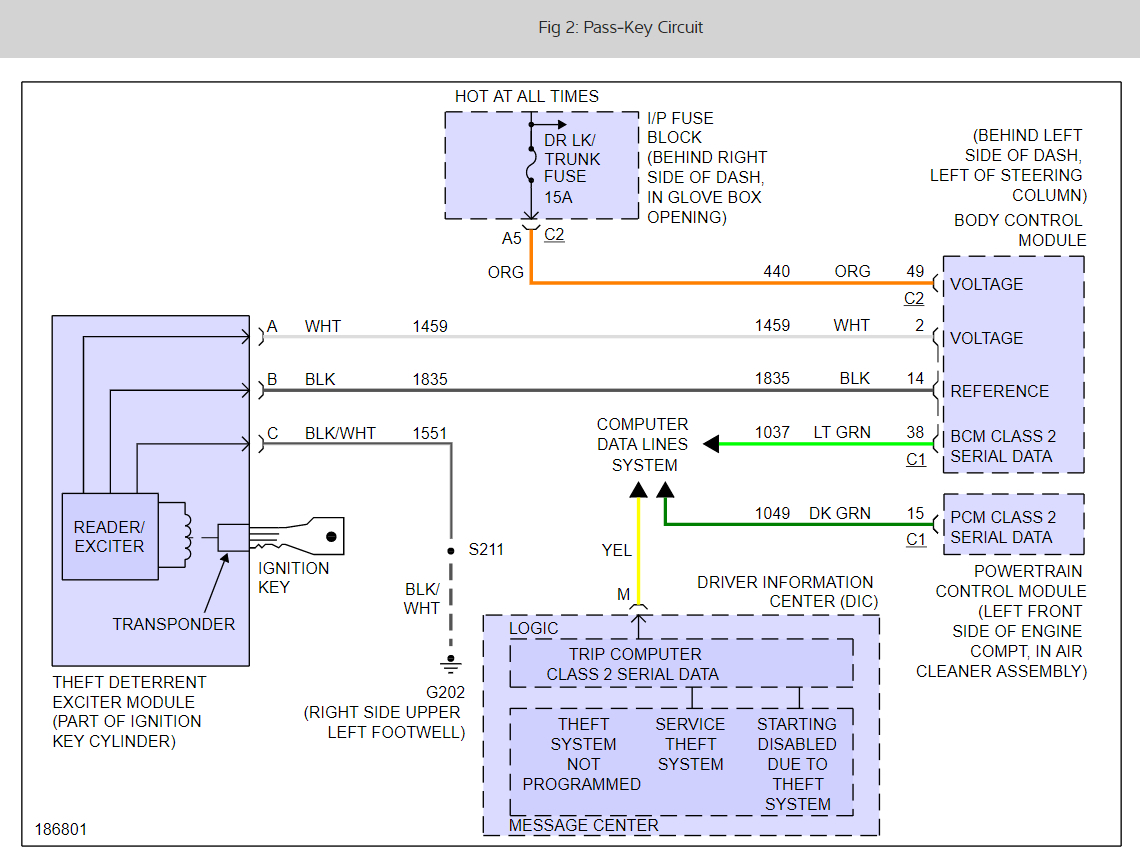

I have had problems in the past with the vehicle not starting all the time, finally it would not start at all. Come to find out the plastic ring that goes around the ignition lock cylinder that has the little chip or motherboard in it had broken. So I ordered a whole new lock cylinder (which did not come with a new key) but I ordered a new pk3 key blank from another place, I had the key cut to the new cylinder and I installed the new cylinder and new plastic ring with it, but I cannot get it to start and I have tried the relearn system five or six times, but I keep getting the " starting disabled due to theft system " message from the car. Do you have any ideas as to what I need to do? Thanks

KEN L
  • MASTER CERTIFIED MECHANIC
  • 48,571 POSTS
It sounds like the dealership that did the programming did not do it right to me. You may have another problem like a connection issue. You should check the wiring and connection to make sure we are not chasing our tail.
(Security wiring diagram below)
