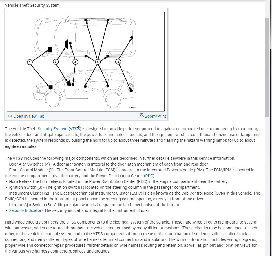

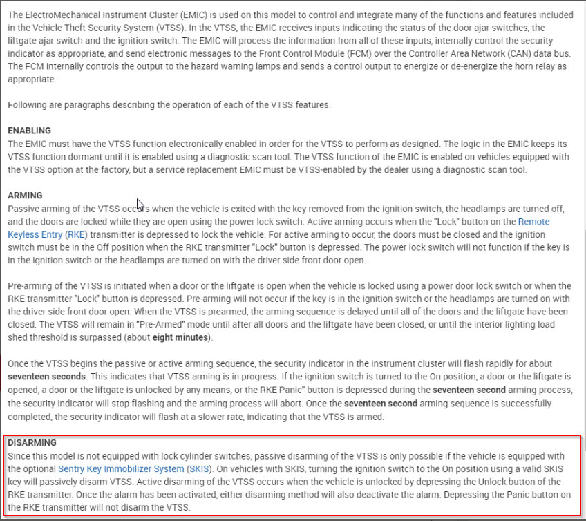

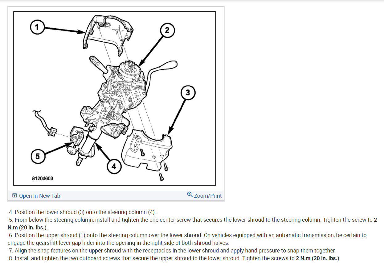

Gives the service key-less system message when I plugged it back in and crank the vehicle message was gone, but it acted like it was cranked with remote and would not shift into gear once unplugged everything back to normal. just have the service key-less system message. How can I reset the security is there fuse?
Mar 15, 2020 at 7:09 AM

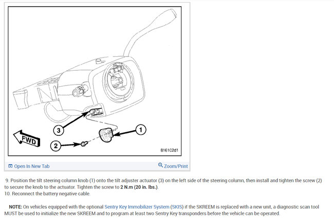

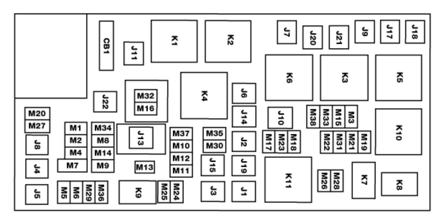

let's scan for codes and then also we need to check all the key-less functions and see what does not work. lets do a CAN scan which is the future of automotive repair you can get a CAN scanner from Amazon for about $50.00 here is a video to show you how.
https://youtu.be/u-4syLc-ifQ

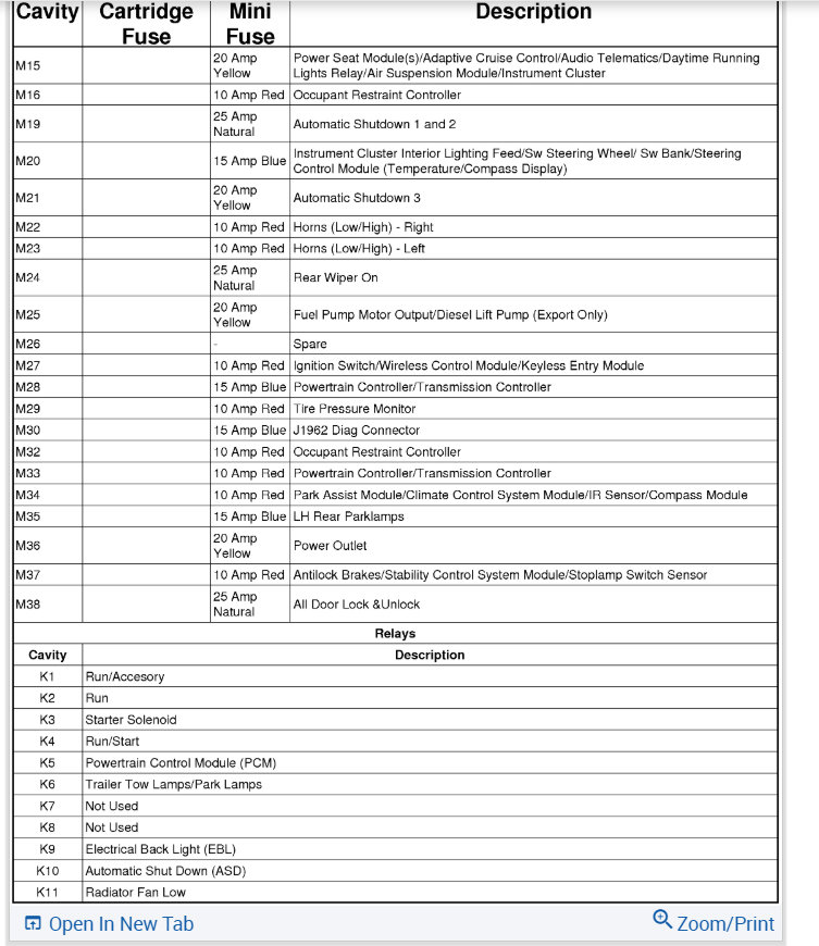

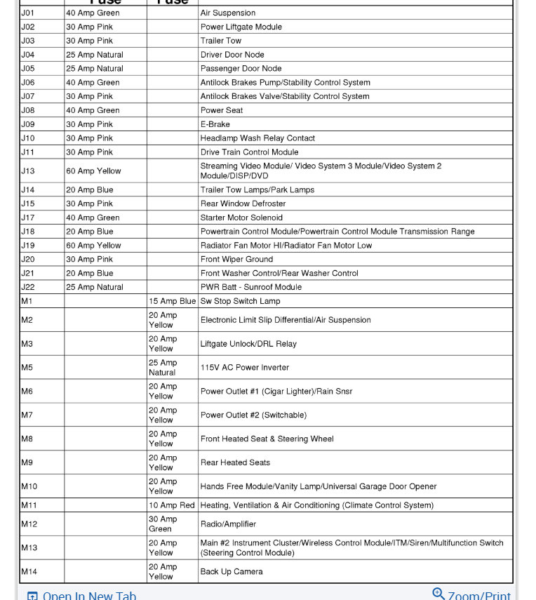

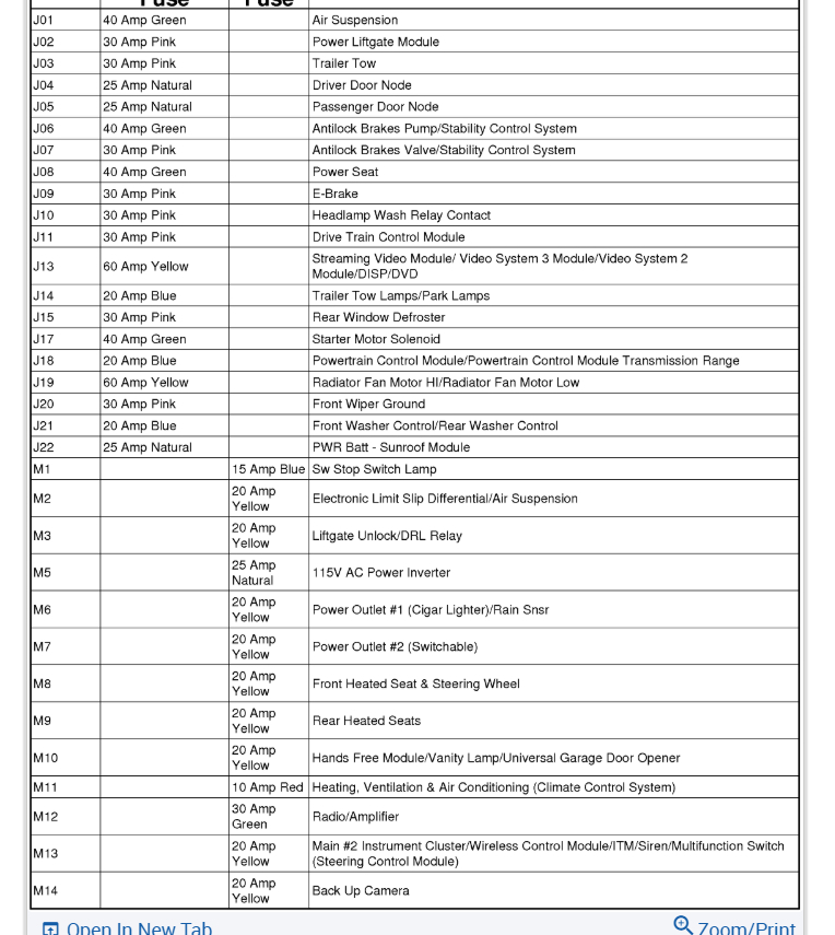

Here is a guide to help you reset the system with the security alarm fuse location in the diagrams below.
https://www.2carpros.com/articles/how-to-reset-a-security-system
Check out the diagrams (Below). Let us know what happens and please upload pictures or videos of the problem.
Mar 15, 2020 at 7:30 AM

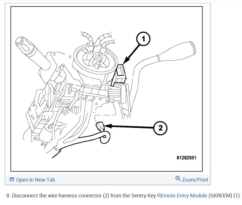

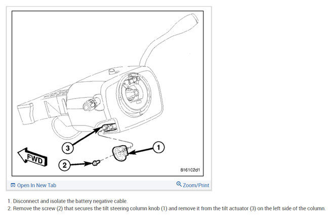

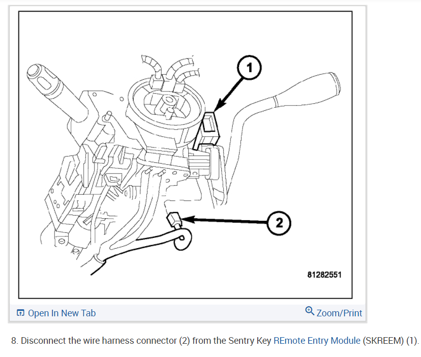

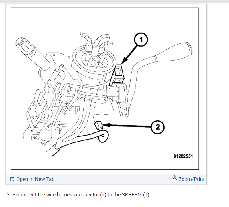

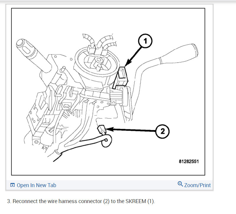

CURTIS LONG
The wire for the key-less antenna was unplugged when I plugged it back in it started acting like it was crank with the fob and would not go into gear. once I unplugged the wire again every thing worked right but the passive entry and the service key-less system message came back on. So I checked outt he guide and that did it, back going again. thank you

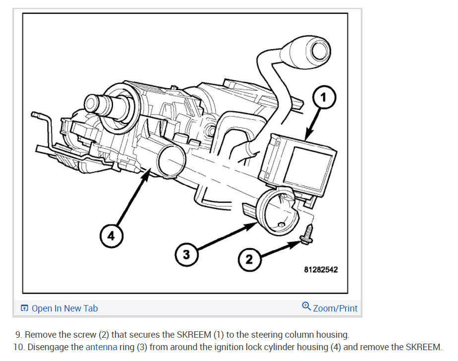

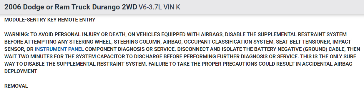

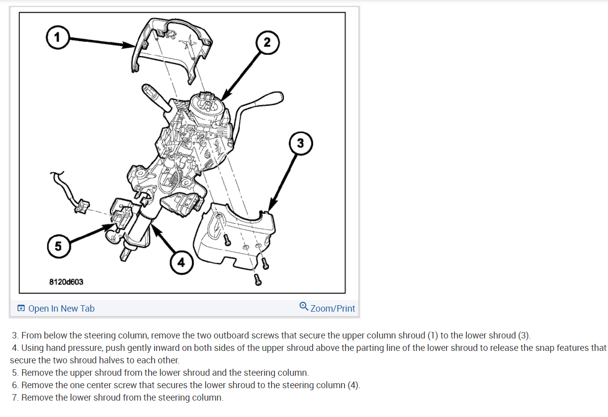

It sounds like the security module needs to be replaced. does the engine start up and run? Here is the location of the module and the replacement instructions below. Check out the diagrams (below). Let us know what happens and please upload pictures or videos of the problem.

It sounds like the security module is bad. To be sure let's check out this video which will help confirm the issue:
https://youtu.be/InIlnsjOVFA

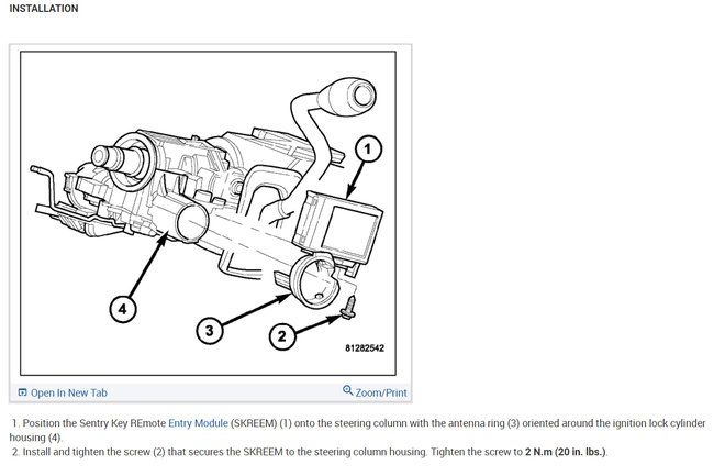

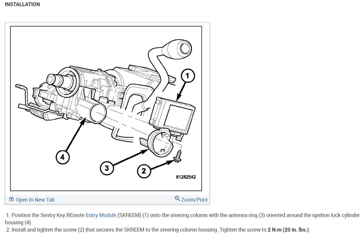

Being a 2006 you are looking at buying the parts to replace the damaged ones as well as new keys. The aftermarket bypass systems usually cause far more problems than they claim to solve especially on this type of system. Then add on a remote start as well and you are getting deep into the barrel of worms.
The good news is that it isn't that bad.
Step one will be to get a new SKREEM module and lock cylinder, that is the part with the antenna that circles the switch. Now visit a locksmith or have one come to you, with your title and registration and drivers license. With those they can contact the factory and get the proper key codes to cut the new keys. Then the replacement cylinder can be pinned to match the lost keys. That way you don't need to replace the rest of the locks. Those parts get installed and they can program the replacement SKREEM module and the keys into the system. I would call a few places as well as the dealers and see who has the better deal. Remember that the smiths will usually charge more to come to you but that with the dealer you are looking at tow bills.
Unfortunately there are no shortcuts or ways you can program the keys yourself. As for the lost keys, as the new keys are programmed in the old ones can be erased so that even if they do turn up they will not work.

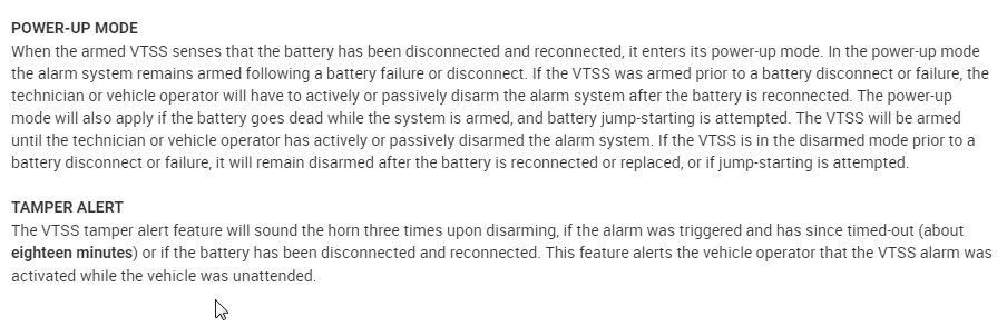

You cannot bypass the alarm easily, have you tried a hard reboot of the system? Remove the negative cable from the battery and hold it to the positive battery terminal for one minute. This will discharge the capacitors and let the system reboot. Here is a guide that can help:

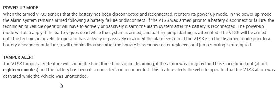

Start by rolling one window down and open the hood. Shut all doors and lock them. Disconnect the battery and let the car sit for 30 minutes and reconnect the battery. Using the key unlock the drivers door and the system should be reset.
If that doesn't work we need to do a hard reboot of the security system so it can reinitialize. Remove the negative cable terminal and hold it to the positive for 5 minutes this will discharge the capacitors and force the system to relearn. Reconnect the battery and unlock the door using the remote.
Here is a guide to help you as well.

There's no reset button except for the trip odometer. The best way to reset the alarm is to disconnect the battery then turn the key on and reconnect the battery here is a guid to help walk you through the process.
