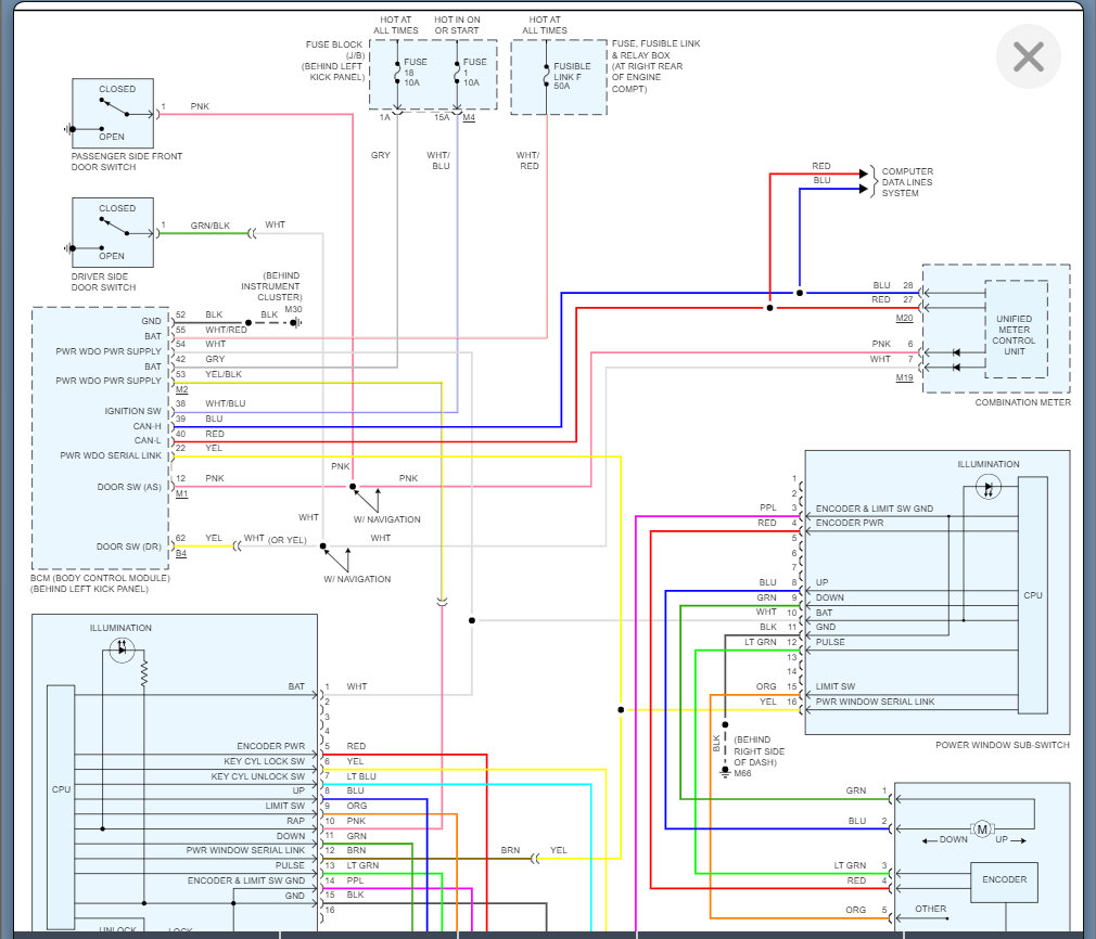

Doesn't roll down. When i click the master button switch i hear a click on the passenger side, same if i click from the passenger side.. click, click.
Feb 22, 2022 at 7:50 AM

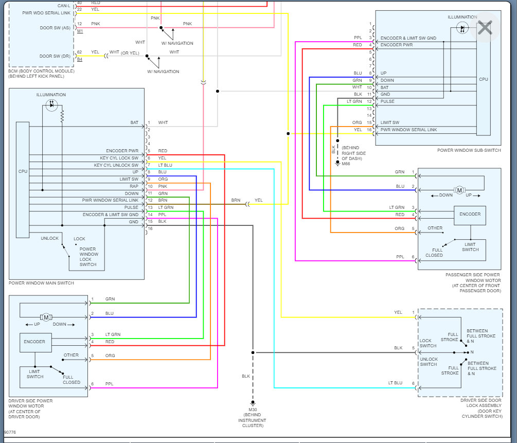

We need to start by checking the voltage coming out of the switch.
I suspect this is a master switch issue, but we need to start with checking to see if there is voltage coming out of the switch going to the motor. Here is a guide that will help with this:
https://youtu.be/HBFBcJrdym4
I am attaching the wiring diagram below but if you have power coming out of the switch then we are going to have to check the wiring. However, I doubt that will be the case as I suspect the master window switch is causing this issue.
So, let's see what this testing turns up and we will have the proof we need.
Let me know what questions you have.
Thanks
