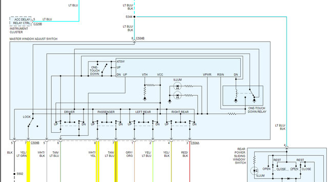

My passenger side window is not going up but with go down. I’m just going to get the motor replaced I want to buy the part. But don’t really know what part is right my truck is the 4 door 2 front full 2 back half.

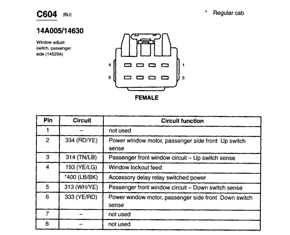

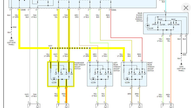

I attached a wiring diagram for you to follow.
You need to check the yellow/green wire at the switch for power.
If you have no power, you will need to check the wires in the rubber boot from the truck body to the door. Very common for wires to break in that boot.
