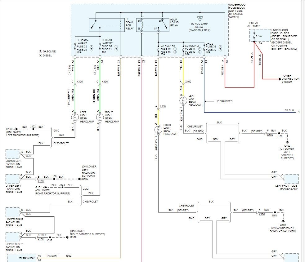

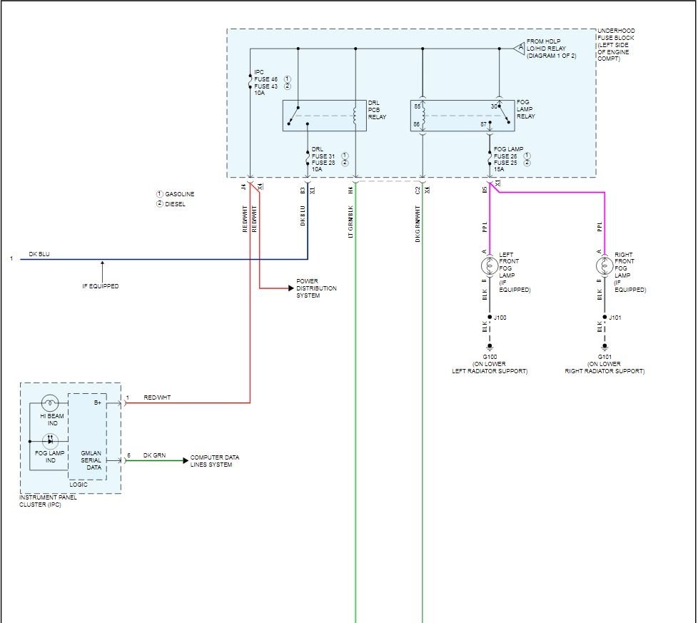

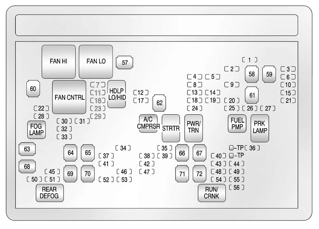

Passenger side low beam went out. I replaced driver and passenger side low beam lights. Passenger side still will not come on.

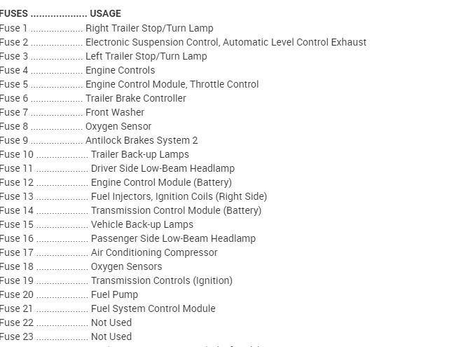

The first thing I recommend checking is the fuse. On these vehicles, high beam, low beam, left, and right, have their own fuses. Since it is the passenger side, that is considered the right? I attached a picture of the fuse box under hood of your vehicle. I need you to check fuse number 16. That is for the passenger side low beam.

Picture 1 is the fuse box under hood specific to your vehicle. Look at the picture, locate number 16 and then locate it in the truck. Once you locate it, then you can check it.

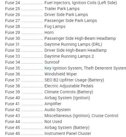

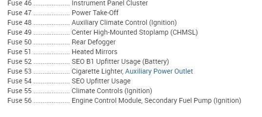

Pictures 2, 3, and 4 are the legend for what each fuse does. You will see that each light and beam choice has its own fuse,
I hope this is helpful. If you find the fuse isn't bad and there is power to it, let me know.

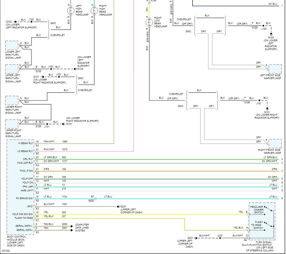

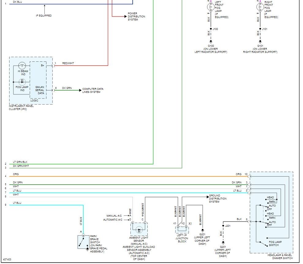

Also attached below are the wiring diagrams for your headlights
