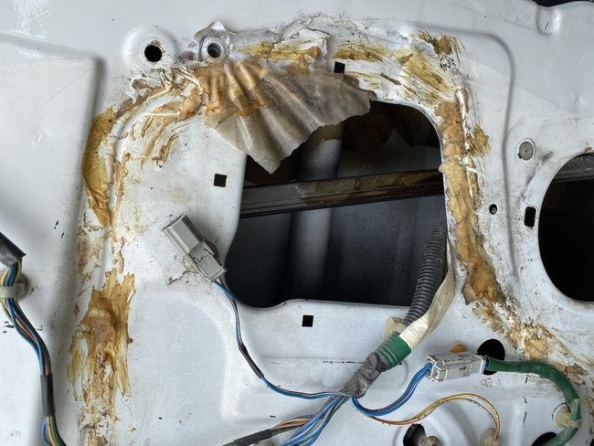

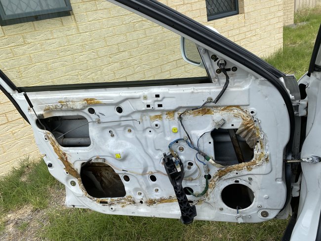

Got this car used and found out that the passenger side windows, side mirror and speakers does not work. Suspected the wiring frayed in between the doors but they seemed fine...
Also i noticed there is a female connection that is just dangling freely with nothing connected, can this be the fault?
After pulling apart the driver side door panel i noticed that there is a door lock control unit on the driver side but not on the passenger side, strange.

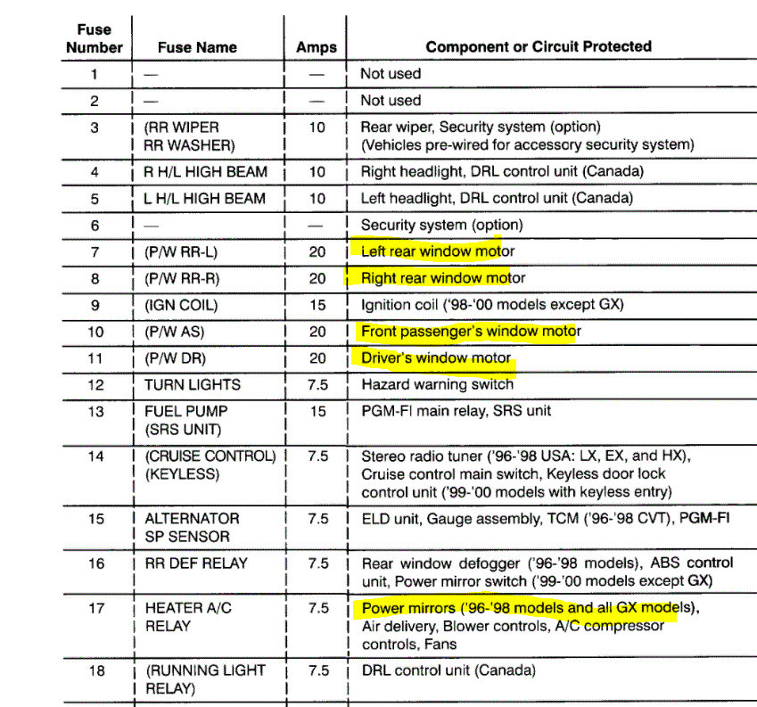

I need to know if it is a 2 or 4 door model. The wiring schematics are different. Also, have you checked fuses? Believe it or not, the windows seem to have their own fuse on the 4 door, so I need to confirm that.
Next, have you checked for power to any of the wires? You could have power but have lost ground. Check that first. Once you let me know which model you have, I will be able to check for fuses and other things.
Also, if you look at pic 1 below, you'll see what I mean about the fuses. However, the mirror fuse is different as well.

Thanks for letting me know. I was looking at the correct wiring. Have you checked for power at the connections? Also, have you checked the fuses shown in the above pic? Fuse 10 is the one you need to check. Also, that is located in the fuse box under the dash.
