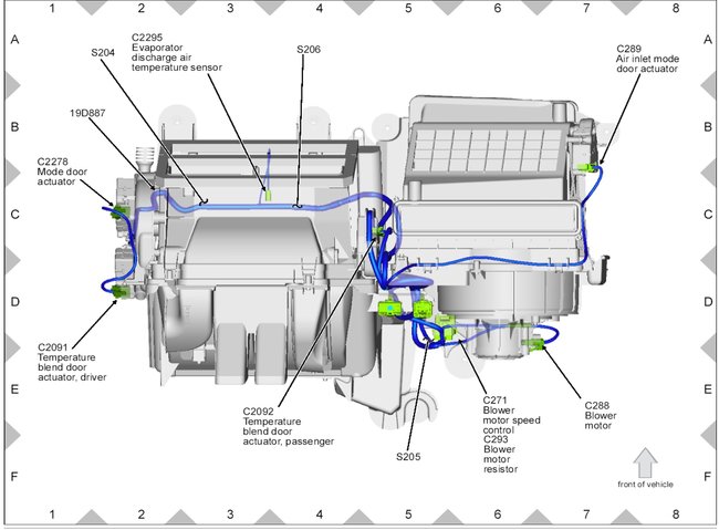

While using my A/C the driver's side vents blow cold air but the passenger side vents blow warm air. I suspect the passenger side blend door actuator is the culprit. I'm unable to find good information on the location of this component for the 2013 and newer model year Fusions. Is it accessible from behind the glove compartment or do I need to remove trim panels on the driver's side, center console, or passenger side?
Aug 7, 2019 at 9:40 PM
SCGRANTURISMO
  • 4,897 POSTS
I have included the information that you have requested in the diagrams down below. I have included the factory removal and installation guides for your vehicle for the passenger side temperature control door actuator. Please go through this guide and get back to us with how everything turns out.

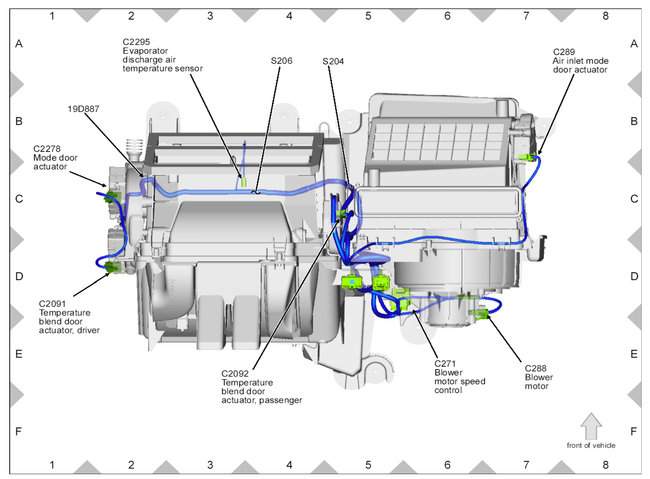

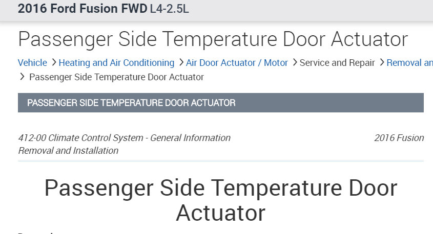

DR359679
Heat on driver side cod on passenger side . How to replace the driver side blend door?
Oct 14, 2020 at 5:49 AM (Merged)
Here is the procedure. Let me know if you need more information. Thanks
DR359679
I'm not seeing any blend door on the driver's side. I replaced the blend door on the passenger side. I'm still getting cold air on the passenger side and hot air on the driver's side . please help
Do you have dual temp zones? Meaning can you set the drive side to a different temperature then the passenger side?
DR359679
No it's not dual climate control.

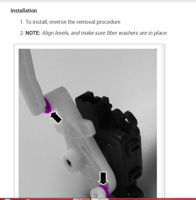

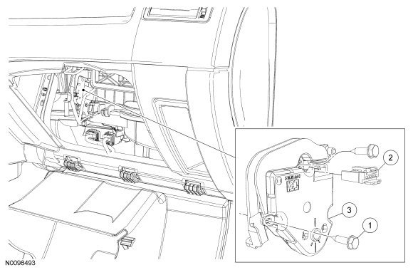

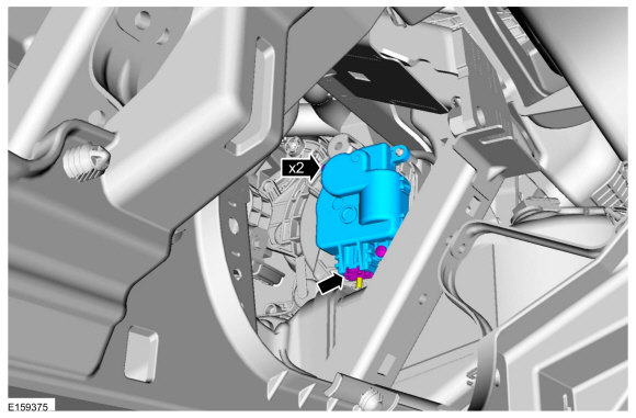

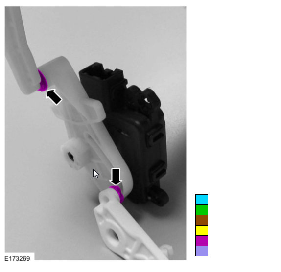

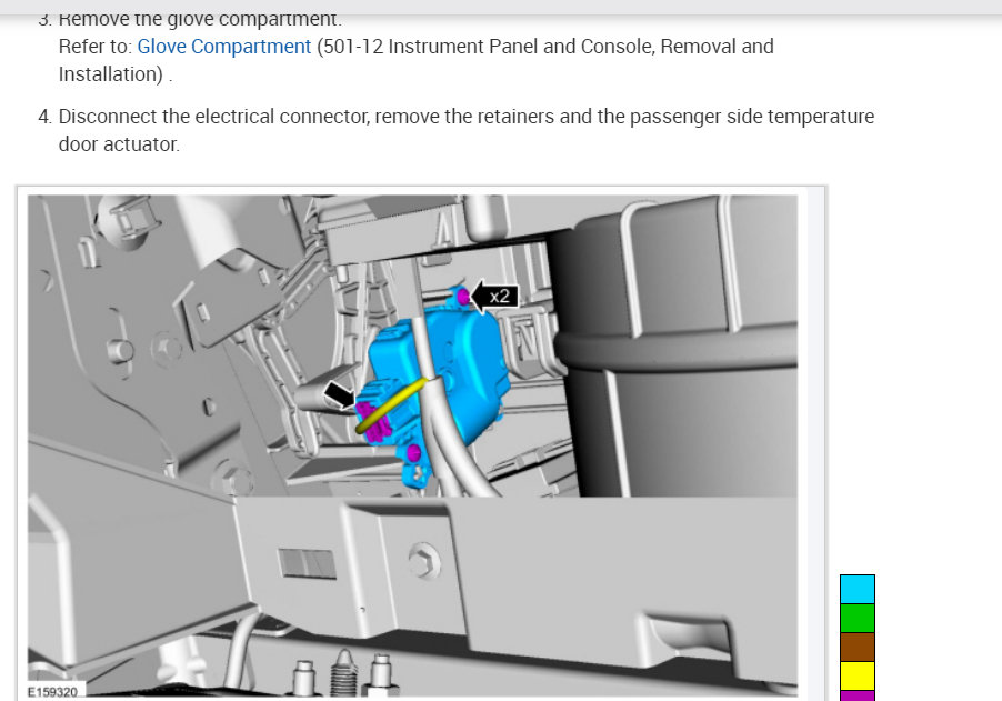

Okay. Then you should have a a lever on the passenger side actuator that controls both doors. More than likely this has come off or arm/door is frozen.
I would remove this and inspect the passenger side actuator and see if one of the arms is not connected.

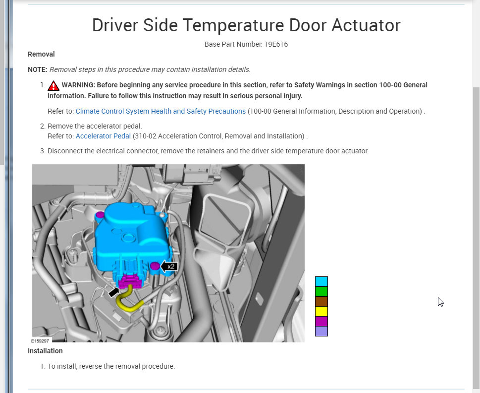

ISTAL
My car listed above has cold air blowing out the passenger side but hot air blowing out the driver side. Is this a blend door malfunction?

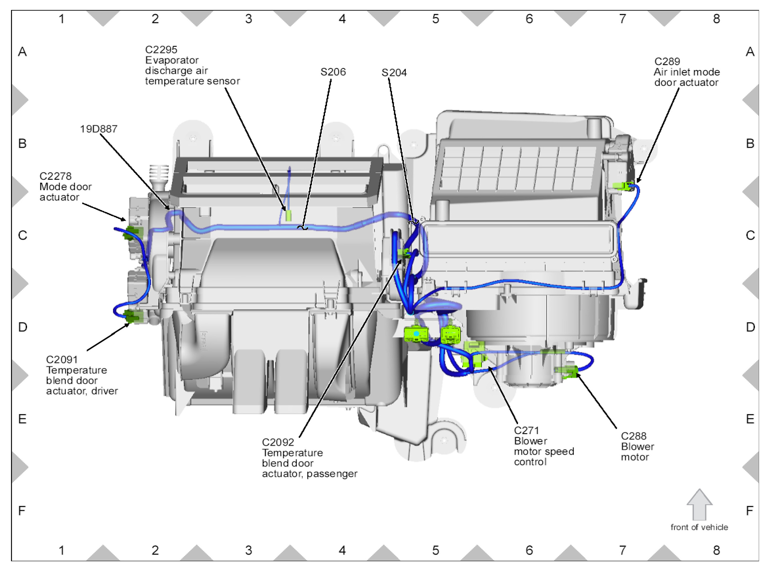

Yes. I suspect this is the case. You have two actuators. One for each side. I attached the process for replacing this. Let us know what happens.
Thanks

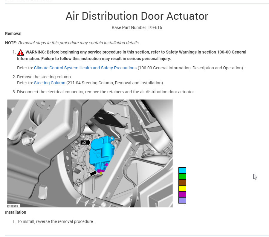

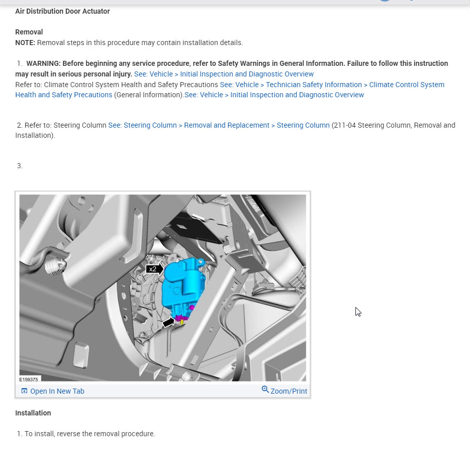

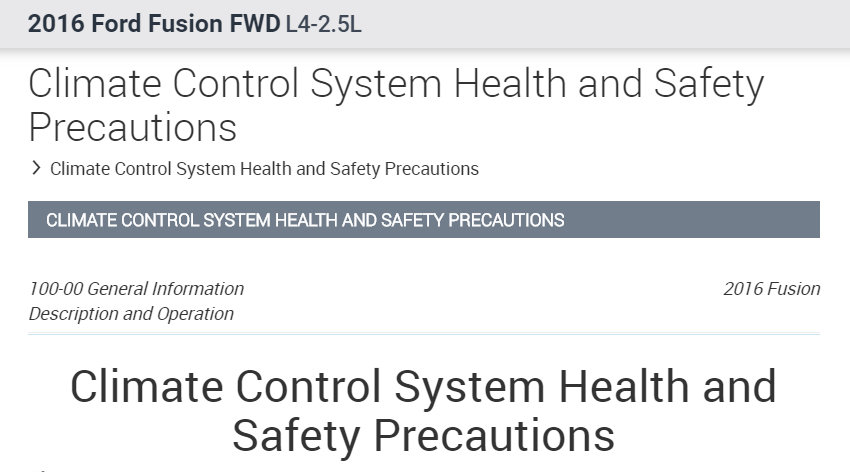

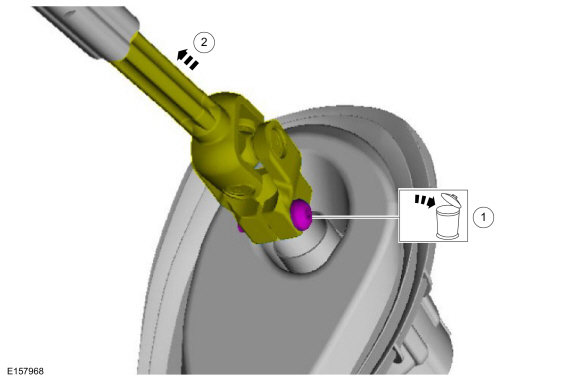

JENOS83
I have air only coming through the head/face vents even when I have the floor and/or defog vents selected. Hot and cold selection still works fine. From what I've read this sounds like the blend door actuator, but I'm unsure of the location on my model.
Oct 14, 2020 at 5:50 AM (Merged)

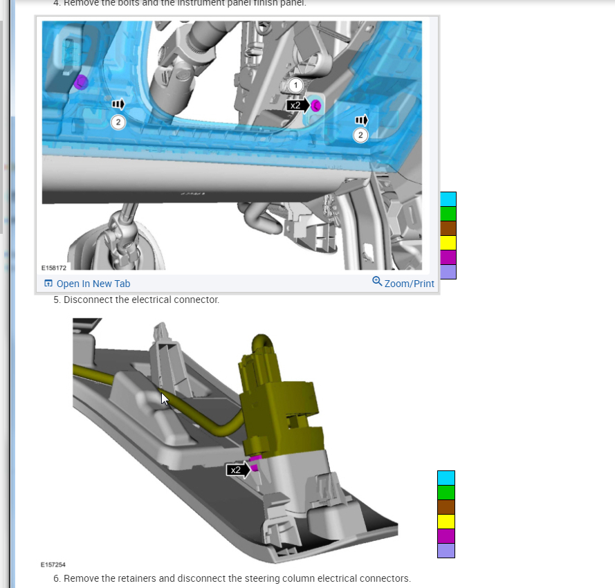

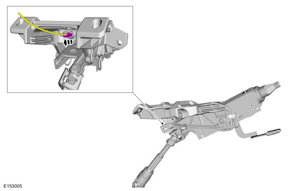

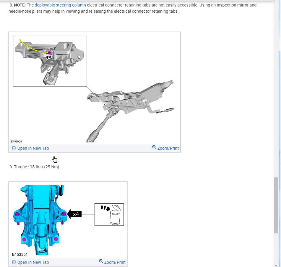

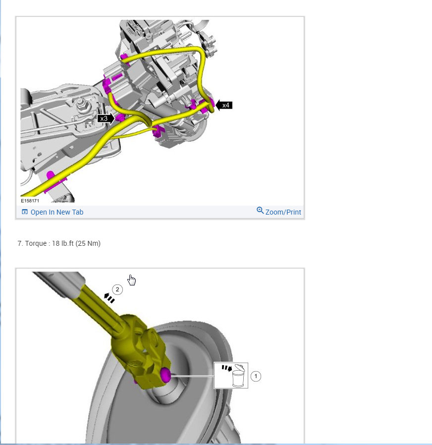

This is actually called the distribution actuator. The blend door actuator is what mixes the air to give you the temp that you are requesting.
I attached the process. Unfortunately they say you need to remove the steering column. I attached that process as well.
Let me know if you have questions. Thanks

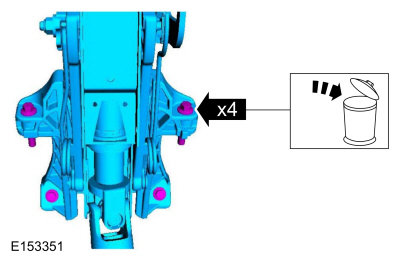

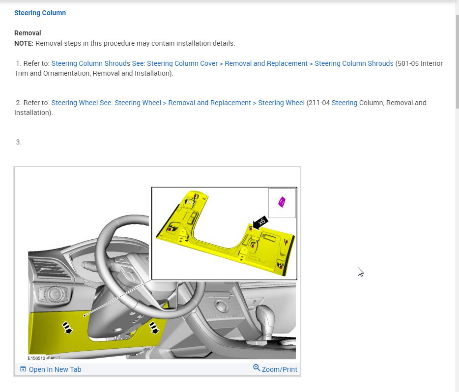

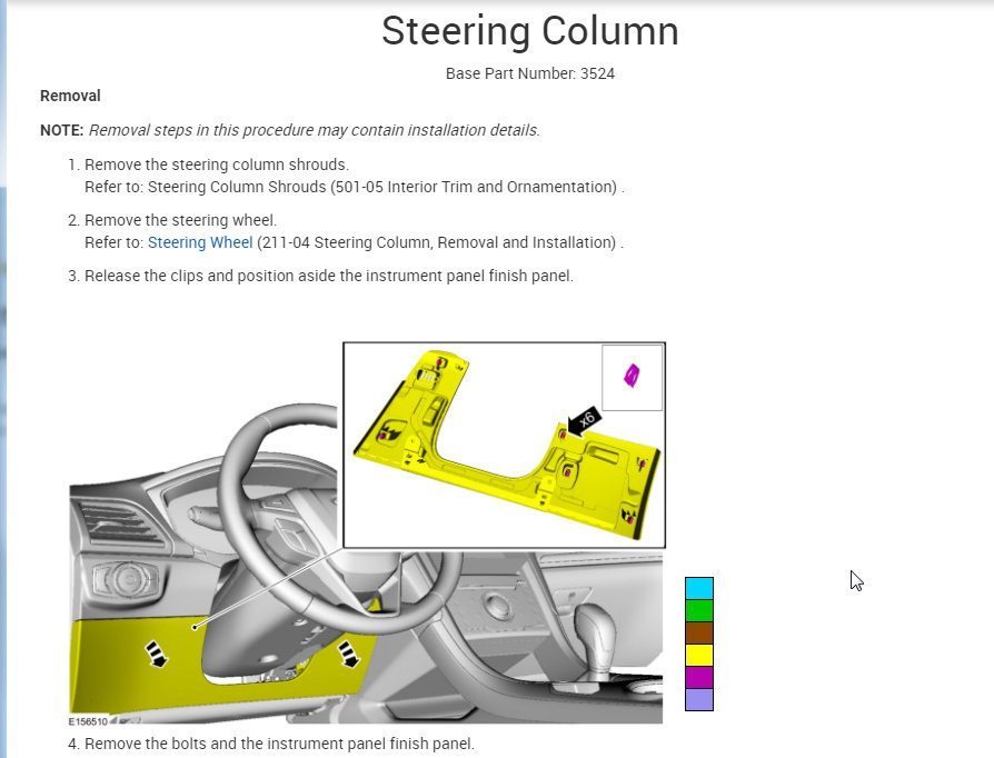

BMDOUBLE
  • 1,139 POSTS

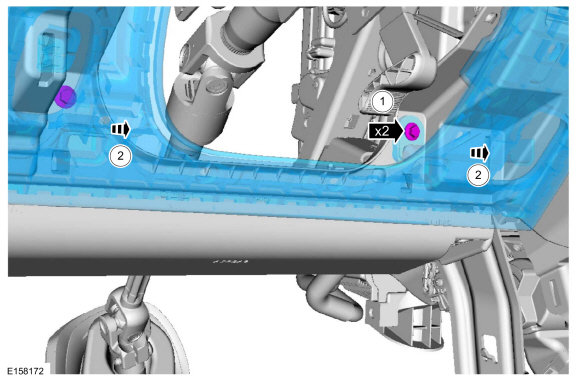

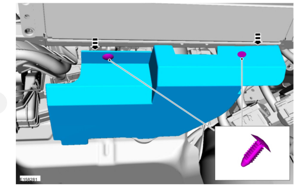

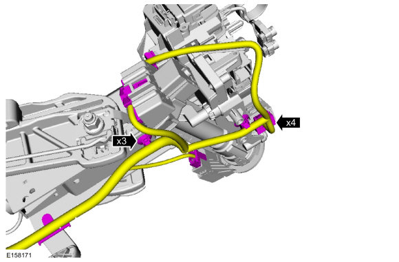

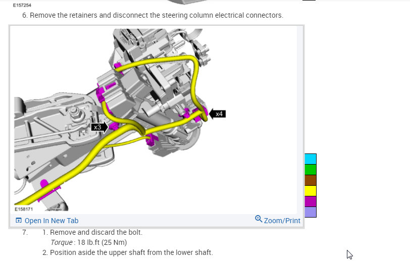

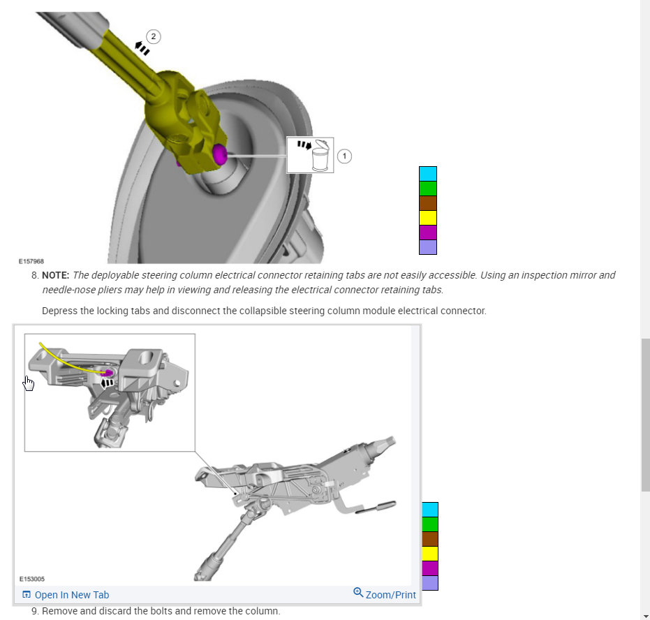

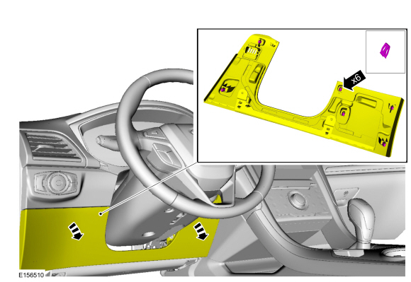

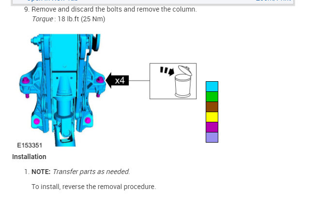

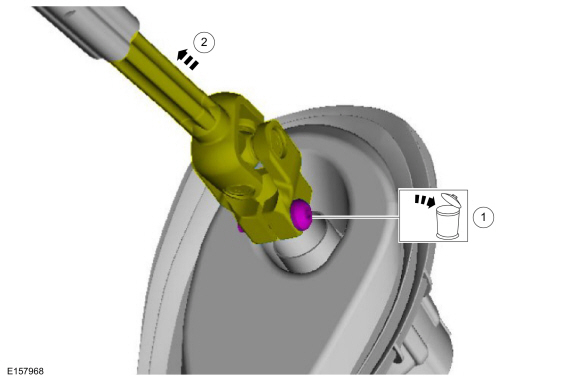

The air distribution blend door motor is on the driver side of the plenum and the steering column must be removed. Here are the removal and Installation instructions for the steering column:

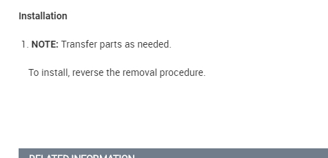

Steering Column
Removal
NOTE: Removal steps in this procedure may contain installation details.
Remove the steering column shrouds.
Refer to: Steering Column Shrouds (501-05 Interior Trim and Ornamentation) .
Remove the steering wheel.
Refer to: Steering Wheel (211-04 Steering Column, Removal and Installation) .
Release the clips and position aside the instrument panel finish panel.
Remove the bolts and the instrument panel finish panel.
Disconnect the electrical connector.
Remove the retainers and disconnect the steering column electrical connectors.
Remove and discard the bolt.
Torque : 18 lb.ft (25 Nm)
Position aside the upper shaft from the lower shaft.
NOTE: The deployable steering column electrical connector retaining tabs are not easily accessible. Using an inspection mirror and needle-nose pliers may help in viewing and releasing the electrical connector retaining tabs.
Depress the locking tabs and disconnect the collapsible steering column module electrical connector.
Remove and discard the bolts and remove the column.
Installation
NOTE: Transfer parts as needed.
To install, reverse the removal procedure.

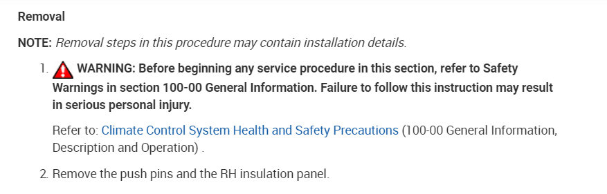

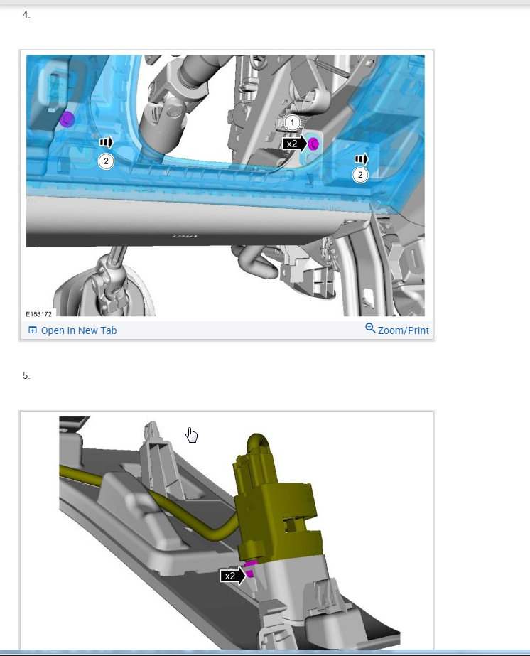

DEMUSR

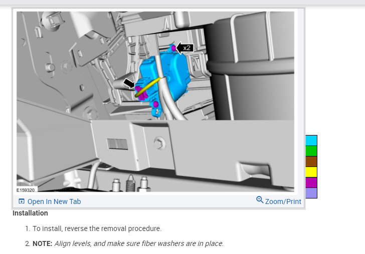

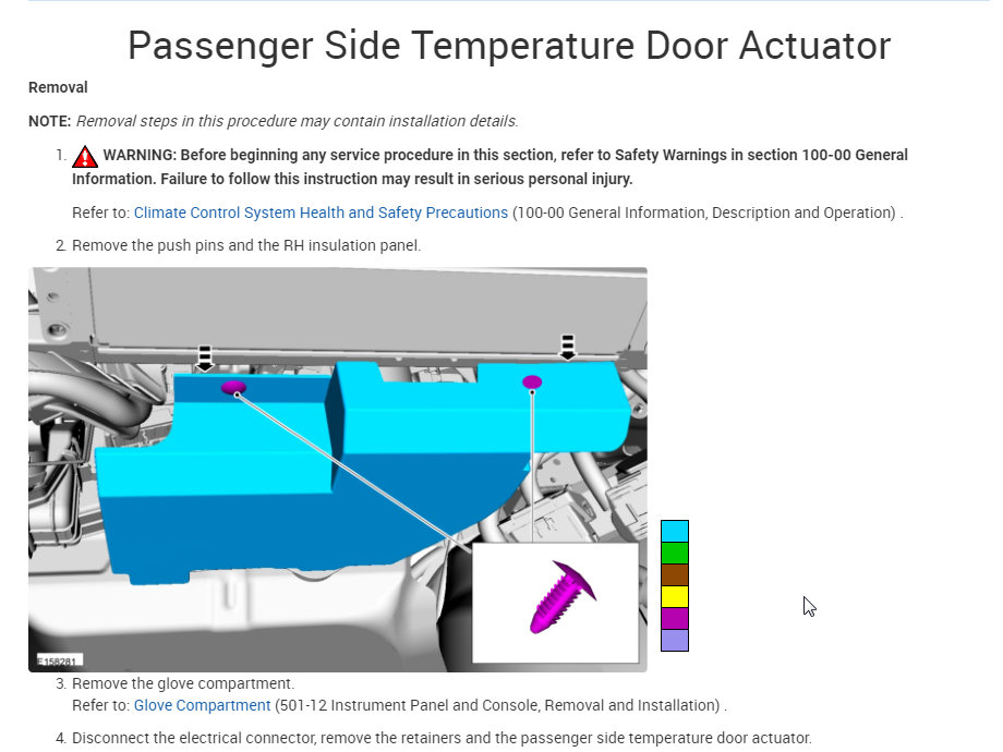

My car is a Hybrid. Bad blend door actuator on passenger side needs replaced. I have the glove box out and have located it but I can only see one screw on the actuator and one on the mount. What else needs to be removed to replace this? Update: Found the three 5.5mm bolt heads. Cannot fit my 1/4" socket with ratchet on two of the three.
  • 110,240 POSTS
Here is a link that describes replacement in general:
Here are the directions specific to your vehicle from Alldata. The attached pictures correlate with these directions. These directions also include the recalibration process.
__________________

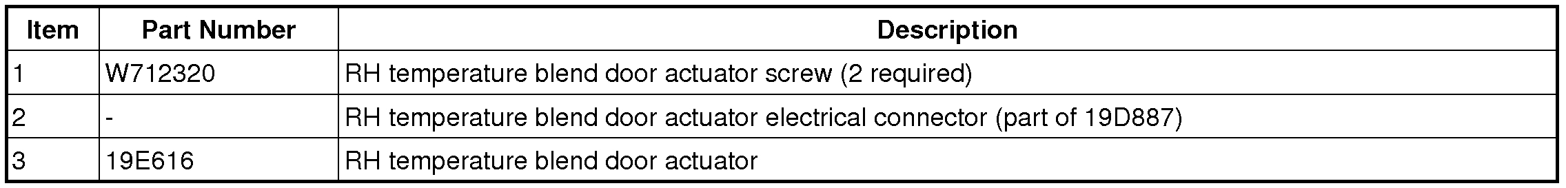

Temperature Blend Door Actuator - RH, Dual-Zone EATC
1. Remove the passenger air bag module.
2. Disconnect the RH temperature blend door actuator electrical connector.
3. Remove the 2 RH temperature blend door actuator bracket screws.
4. Detach the wire harness from the RH temperature blend door actuator bracket.
5. Remove the RH temperature blend door actuator.
6. To install, reverse the removal procedure.
7. NOTE: The purpose of the module actuator position calibration is to allow the HVAC module to reinitialize and calibrate the actuator stop points. To carry out calibration, carry out the following steps.
Remove the Smart Junction Box (SJB) fuse 15 for at least one minute.
8. NOTE: When the ignition switch is switched to the ON position, the HVAC module will initialize and calibrate the actuators. Calibration of the actuators will take approximately 30 seconds.
Reinstall SJB (Smart Junction Box) fuse 15. Turn the ignition switch to the ON position and wait 30 seconds before verifying correct DEFROST/PANEL/FLOOR operation.
___________________________________
Let me know if this helps.

MAC1956

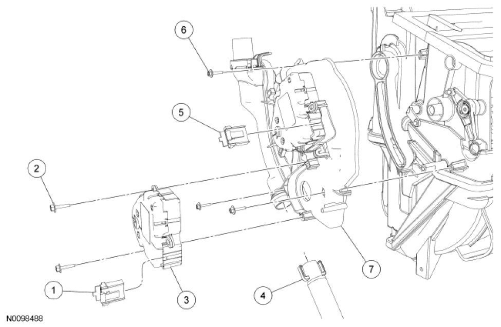

The buttons light up, but when pressed, the vents do not change. Which actuator and where is it located? Thank you

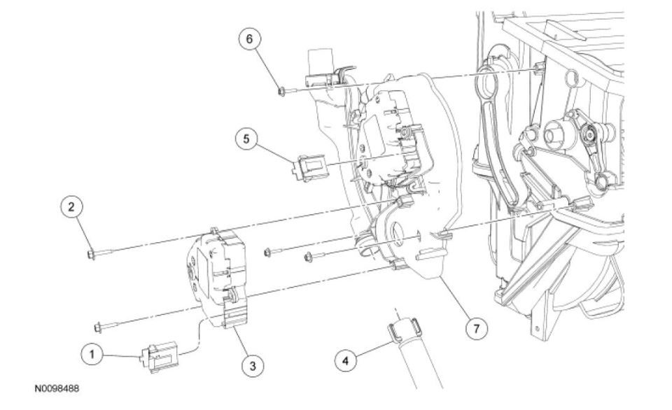

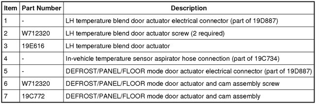

Good evening.
It is in the dash. The instrument cluster has to be removed to access. It is on the side of the heater case. I believe you can see it but not remove it without the dash removed.
It is number 7 in the picture This is a very involved procedure. Are you planning on doing this job yourself?
1. Remove the instrument panel. For additional information, refer to Instrument Panel and Console See: Dashboard / Instrument Panel > Removal and Replacement > Instrument Panel.
2. Disconnect the LH temperature blend door actuator electrical connector.
3. Remove the 2 LH temperature blend door actuator screws.
4. Remove the LH temperature blend door actuator.
5. Disconnect the in-vehicle temperature sensor aspirator hose connection.
6. Disconnect the DEFROST/PANEL/FLOOR mode door actuator electrical connector.
7. Remove the 3 DEFROST/PANEL/FLOOR mode door actuator and cam assembly screws.
8. Remove the DEFROST/PANEL/FLOOR mode door actuator and cam assembly.
9. To install, reverse the removal procedure.
10. NOTE: The purpose of the module actuator position calibration is to allow the HVAC module to reinitialize and calibrate the actuator stop points. To carry out calibration, carry out the following steps.
11. NOTE: When the ignition switch is switched to the ON position, the HVAC module will initialize and calibrate the actuators. Calibration of the actuators will take approximately 30 seconds.
Reinstall SJB fuse 15. Turn the ignition switch to the ON position and wait 30 seconds before verifying correct DEFROST/PANEL/FLOOR operation.

The buttons on the vent display light up, but when pushed, the vent does not change. I have been turning the car off, pushing the button for the vent selection, then restarting the car. Thank you
  • 110,240 POSTS
It sounds like there is a problem with the mode door actuator. I have to be honest, it is not easy to get to for inspections. However, here are the directions for removal and replacement. Once you reach it, then you can check if it is functioning. The attached pictures correlate with these directions.

FRANKFORD1

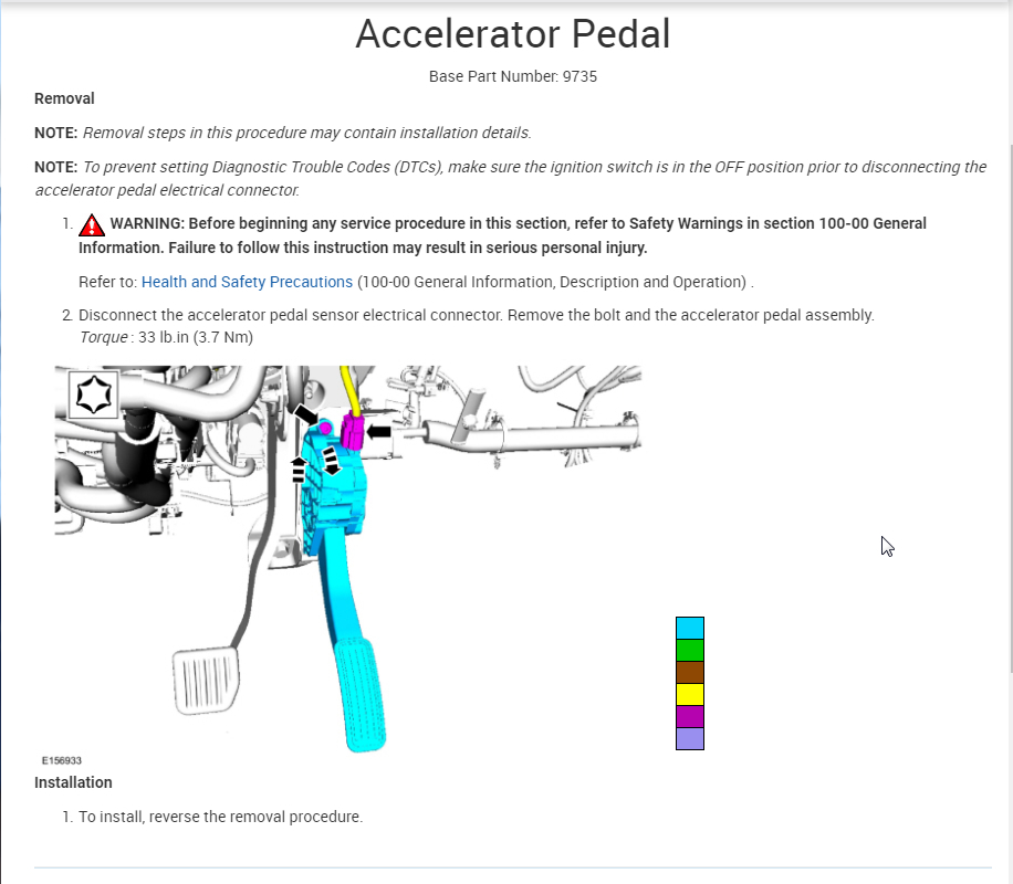

Hi, sorry for bumping this thread. But I have the same issue with the actuator, changing between cold and hot does nothing. From what I understand this is a faulty blend door actuator and not a distributor?
And blend door actuator is behind the glove box, and distributor is the one above gas pedal?
And do both of distributor and blend door use the same part? Or are they different?
Edit: changing the A/C flow zone works fine.
Dec 19, 2020 at 11:12 PM
KENW1
  • 213 POSTS
On the 2011 Fusion they are located as seen below. Passenger blend door actuator to left of blower motor and drivers to right of accelerator pedal.
Dec 20, 2020 at 8:15 AM
