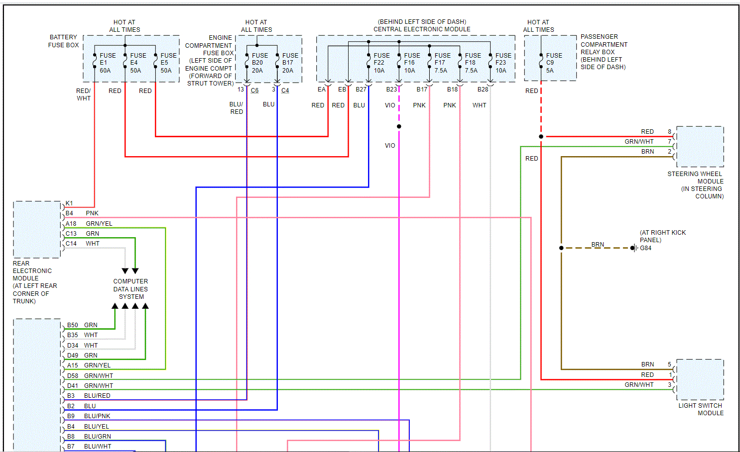

Passenger (left side) headlight turns on then almost immediately goes out
2005 VOLVO S60
230,000 MILES • 2.4L • 5 CYL • 2WD • AUTOMATIC
IMCKEEN
However, if I switch the lights on before I start the engine the lights work okay.
Apr 4, 2021 at 7:55 AM
  • 110,244 POSTS
That is really odd. The best thing to do with something like this is to start checking connections and grounds. Something could be loose or corroded.
I do have a question. If the engine is warm and you start the engine first, does the same thing happen? Also, here is a link you may find helpful:

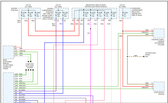

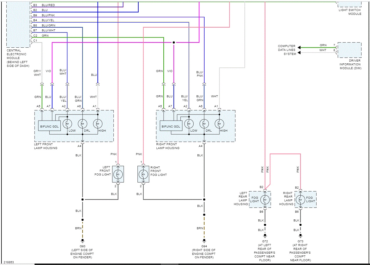

I attached the wiring schematic for the headlamp system. I had to cut the pic in half to make it readable, but I did overlap them so you can easily follow. Check the connectors at the headlamps, the grounds, and make sure fuses are not corroded.
Let me know what you find.
