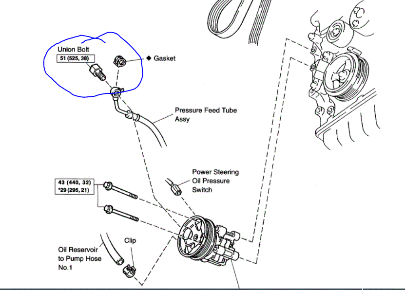

I'm not sure if this is allowed as a question, but anyways if it so I will just state it if it gets deleted i apologize. anyways, i'm looking for two different parts for my power steering.

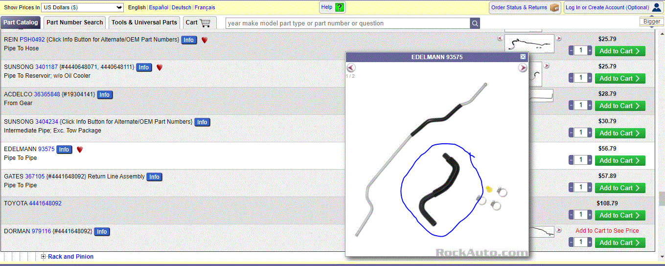

1. the hose from the reservoir to the pump. i'm not sure what its called i tried typing power steering hose on amazon eBay even Rock Auto and only pressure line and return lines pop up. is this something i might get at Home Depot?

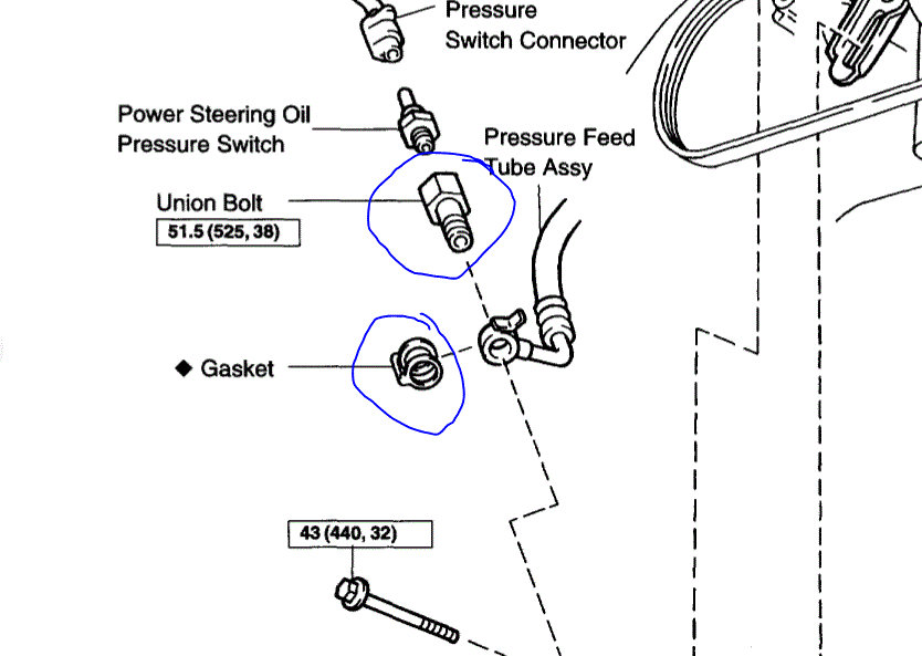

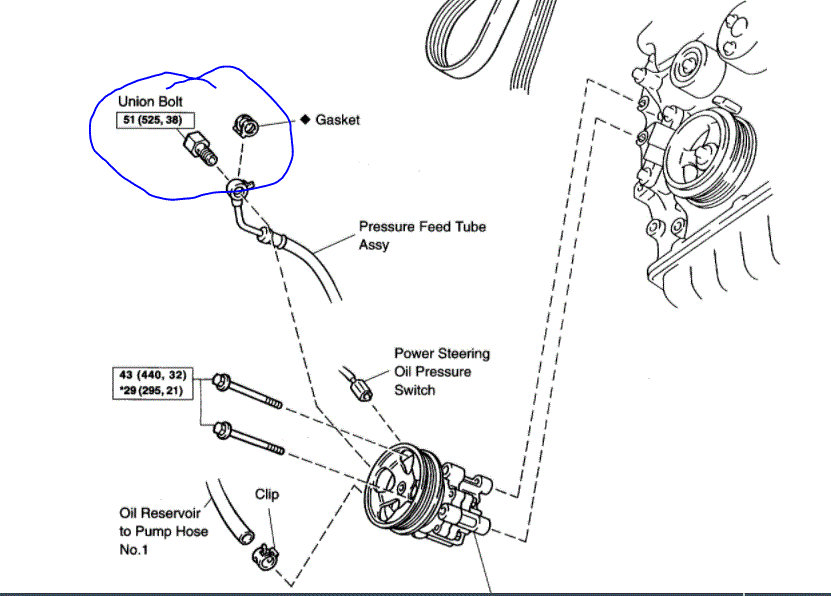

2. Banjo bolt, i have ordered a new pump but non of them seems to come with the bolt so is this also something i can get at a hardware store?
i know this is two different parts and questions but i'm hoping i can get some feedback on these two items,
with the Banjo bolt i had cross threaded the bolt i'm thinking with that just to get a dye and rethread it.

I found the hose for you at rock auto. It comes with a return line. It is just a hose from the tank to the pump.
As far as the pump, I also attached pictures of the bolts and washers. You can get these at a dealer or you can go to Fastenal for those bolts as well. They carry these bolts with washers and all.

i got the hose off of somebody on Facebook sales in my area, also the bolt i had it rethreaded . after removing the pump i found out it wasn't much the bolt that i had damaged but it was the pump that i messed the threads up. anyway picking up that pump tomorrow at the post office. thanks for your time.
