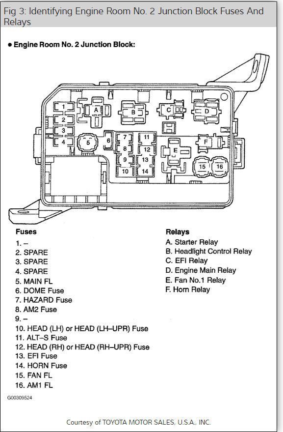

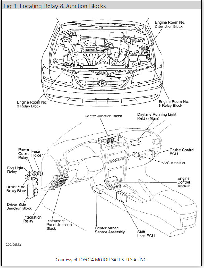

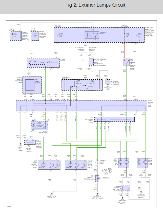

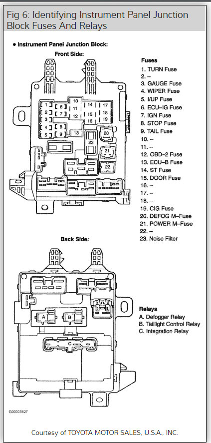

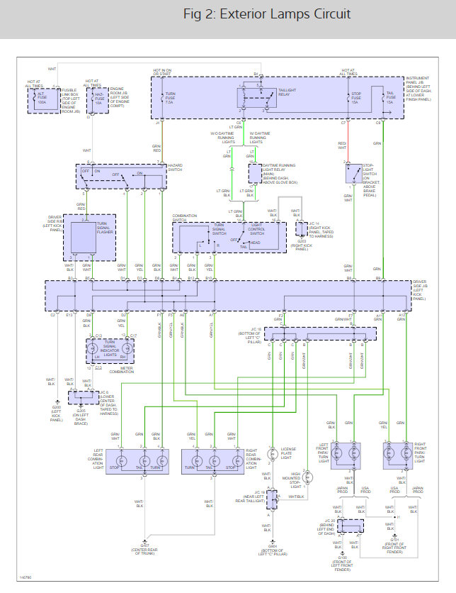

The parking lights on my car will not turn off even after I turn the car off. It drains my battery and I have no clue why this happening. It is not a DRL system car. If you guys have any suggestions as to how to fix this problem, please let me know.

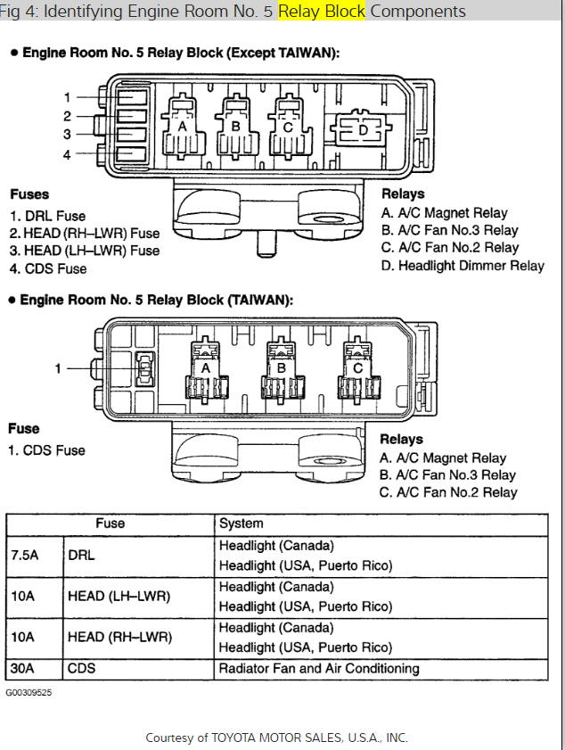

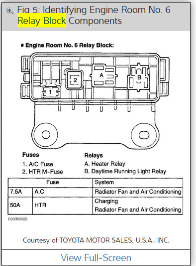

You have a tail light relay that is sticking on here is the location of the relay and the wiring diagrams so you can see how the system works.
Check out the diagrams (below) last one. Please let us know if you need anything else to get the problem fixed.

I had this problem. Thanks for the information. I replaced the tail light relay everything working great once again!
