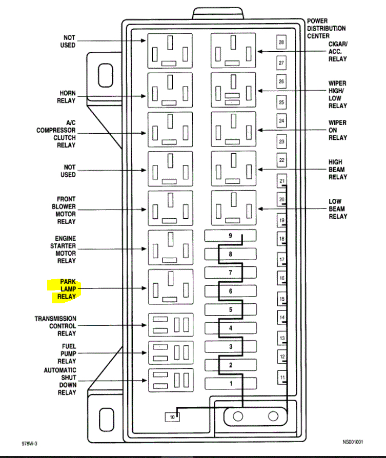

Initially at random the parking lights would come on with ignition off and key removed. Now routinely when I turn it off the park lights come on. Only way to keep battery from running down is to remove the park lights fuse.
when I remove the key immediately there is a warning beep, and the park lights light up.
I've removed the connections to the ignition switch and put them back to make sure of a good connection but didn't help. What's my next step? pick n Pull for a replacement switch or does the entire ignition system need to be replaced. Or some other problem?
I've already replaced the lights/mirror switch but that didn't help.

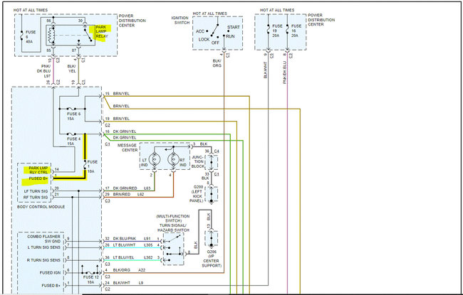

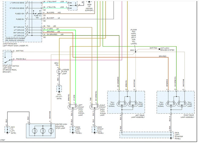

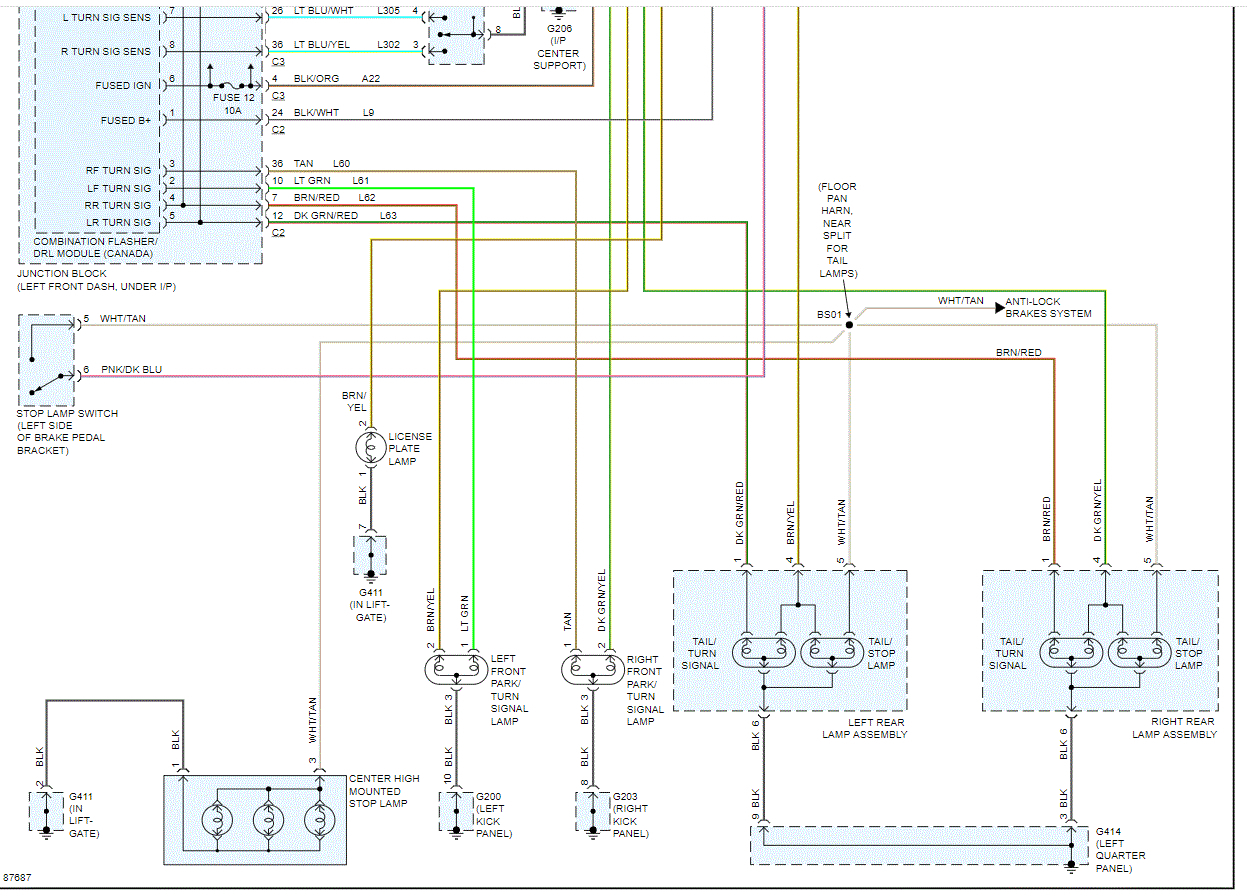

Do you know if they are on at all times, or does this only happen when the key is turned off? I ask because if the key is in the on position, there will be no indicator.
Next, I don't feel it is the switch unless the lights are on regardless of the key position. Somehow, we are getting power when it isn't needed. So, let's try to narrow it down.

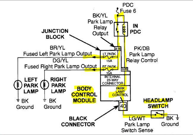

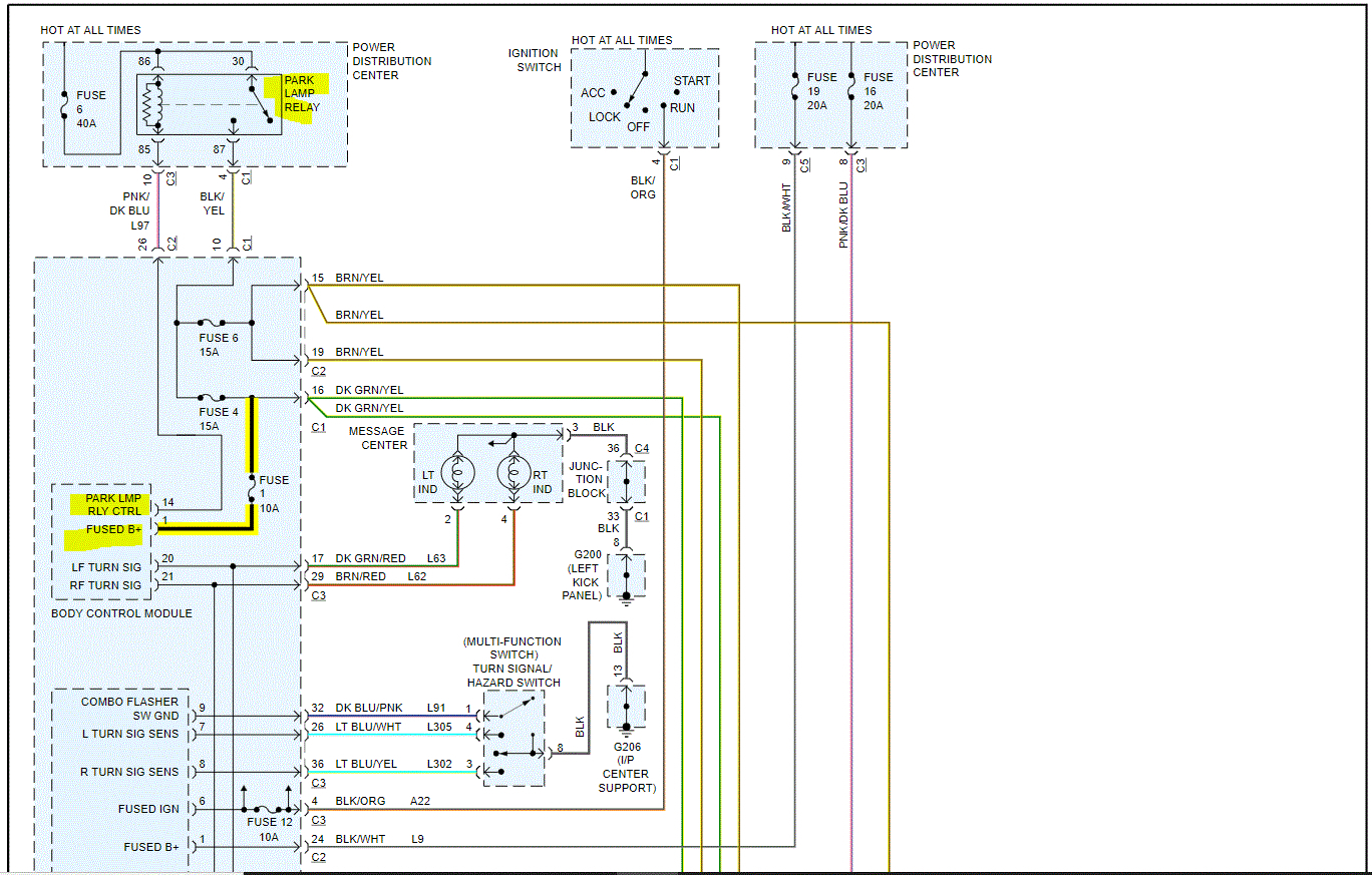

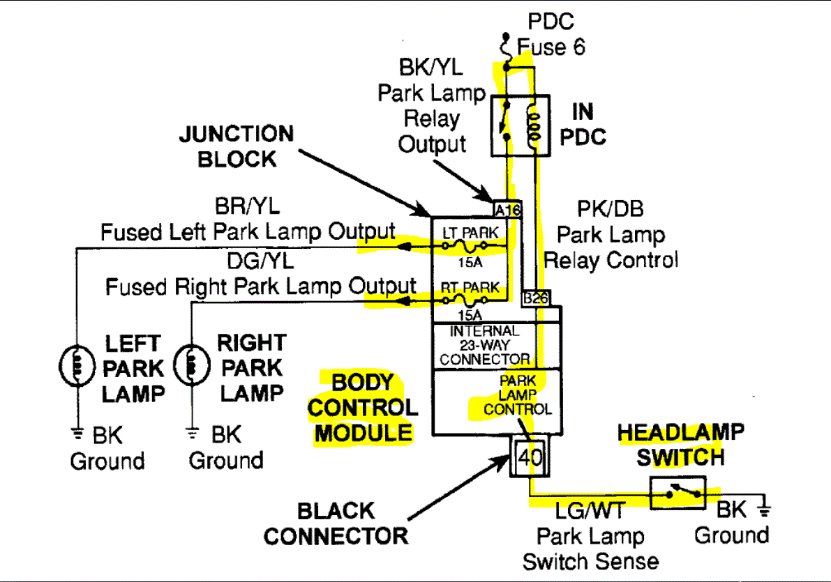

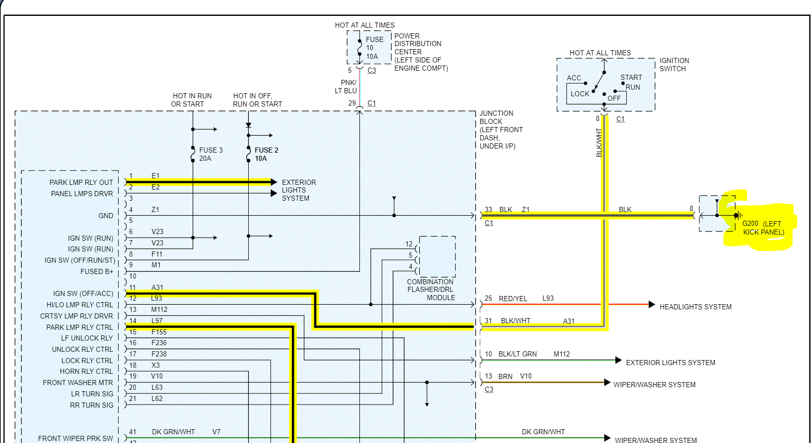

If you look below, I attached the wiring schematics for the exterior lighting. The first thing I'm questioning is the park lamp relay. If you look at the schematics, it shows the location to be in the power distribution box. What I need you to do is this. Remove that relay and confirm the lights went off. Next, if there is another relay with the same part number, switch them to see if it makes a difference. If there isn't one there, here is a link that explains how to test a relay:

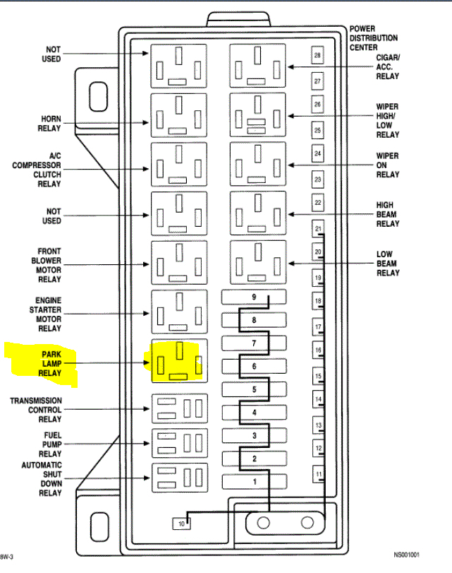

See pics below. Pic 3 shows the relay location. (under-hood in the power distribution box)

I did hear a clicking sound when the park lights were going on and off. But couldn't tell which relay. I tried to remove the park lights relay but couldn't get it out, so I just made sure it is seated firmly. Now the park lights are working properly but since it is a random occurrence, I'll have to check over time if the issue is solved. If that is the case, then thanks so much.

Since the relay is too tight to be removed, I wonder if there is a build-up of corrosion. That could cause issues.
Regardless, let me know if things change or if there is anything I can do to help.

Okay, so i took out the relay and it is very clean and no corrosion. I thought the issue was fixed with just a firm seating but last night the parking lights came on again at random when no one was around the vehicle. so today I'll switch relays with one with the same number and see if problem is isolated. Anything else to check? could it be the BCM or ignition switch?

Okay, I exchanged the park light relay with the blower relay that has the same number. the problem still exists which indicates it is not a faulty relay issue. I did notice that pushing in the key while in the off position can sometimes generate the issue with the park lights turning on. but if they are on, then nothing I do with the key while in the off position will turn the lights off. the warning dinger and the park lights are in sync.

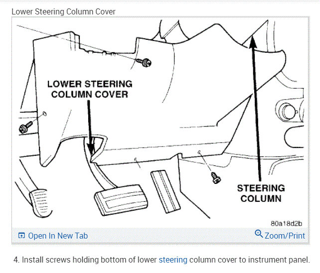

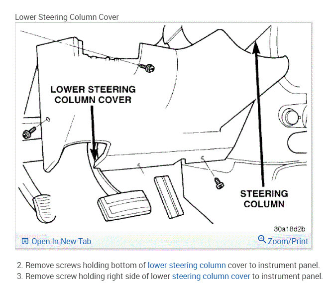

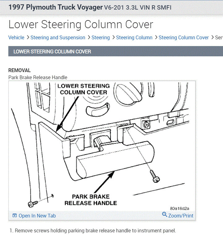

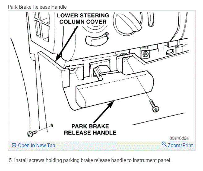

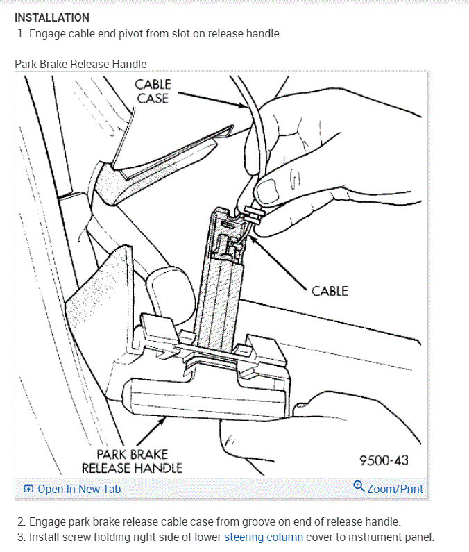

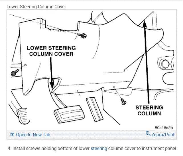

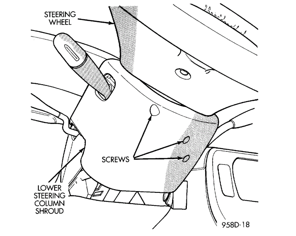

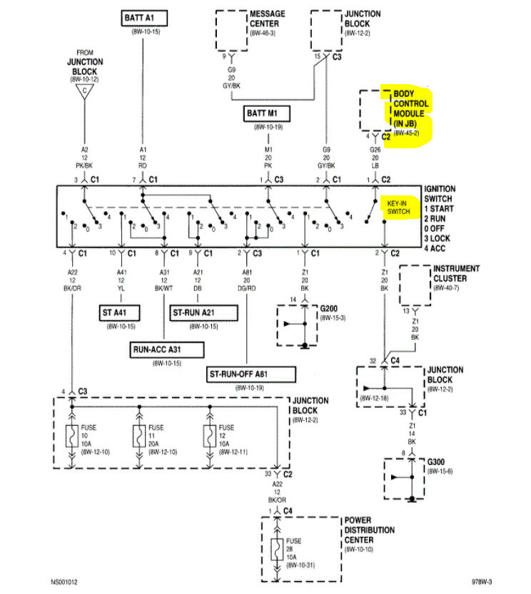

I looked through schematics and the ignition switch itself doesn't have anything to do with the parking lights. Also, the switch is the same regardless of the engine.
Based on the info I was able to find, there must be a short at some point. When you said pushing in on the switch could sometimes cause it, I'm wondering if you are placing pressure on the harnesses inside the column.
If you look at the bottom of the steering column, there will be a wiring harness. Have a helper watch as you wiggle those wires around to see if they come on. If you want to gain better access to the wiring, the column cover can be removed. I attached the directions below for removing it. Since you are not actually replacing the cover, you should be able to simply remove the bolts behind the park brake release and not disconnect the cable. That will get it lowered but not removed.
If the lights come on or even flicker, that could be the issue. It could also be related to a failing switch. Hang in there. We'll figure it out together.
One last thing. I'm not sure if this model year will require reprogramming if the ignition switch is replaced. I don't believe it does, nothing is listed in the manual to indicate it, but anything is possible. Remember, the ignition switch is just that, a switch. It is not the key cylinder lock/tumbler.
Try this and let me know the results.

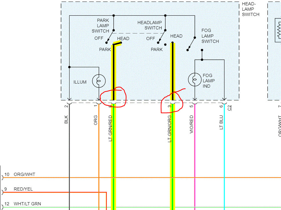

I think I recall something related to the dash lights. Since the lights are now on at all times, it could be the switch itself shorted internally.
If you look at the pic below, I included the headlamp switch. Note there are two light green wires, one has a red tracer and the other has an orange tracer. With the lights in the off position, check to see if there is power on either of those wires. If there is, then most likely the switch is shorted internally.

There are two green wires to the light switch, one with red and one with white tracer. both seem to have low voltage current as the dinger goes off when I touch either with a grounded tester. However, the tester light doesn't light so maybe my ground isn't the best. While messing with these wires the issue went away and I thought perhaps the issue is solved so I tried various positions and connections, and everything seemed to be working. So, I put the dash back together and seemed okay but coming out of a store half hour later the park lights were on again. Now it seems intermittent and not on all the time. perhaps a left over Halloween ghost?

I just went through the schematics again. I cannot find a light green wire with a white tracer. You indicated that is off the light switch, correct?
Now, since the dinger stops when you use a tester, I need you to try something. It sounds like the ground may be the issue. There should be a black wire from the switch. Simply splice into the black wire and run a jumper to a known good ground and see if that changes things.

Maybe I was confusing by what I said earlier. with the light switch disconnected from the switch, when I touched the tester to either green wire the dinger "sounds", but the 12 v test light does not illuminate. not sure what voltage is on those wires. I may not get to test the ground wire tomorrow but will let you know when I do.
Nov 3, 2021 at 7:18 PM
  • 110,194 POSTS
With the headlamp switch disconnected, there should be no power to the green wires. The idea that the dinger turned on is leading me to believe there is a ground issue and power is back feeding through the circuit seeking a new ground path. It's a theory at this point, but I'll keep my fingers crossed.

Okay, then there is a short to power after the fuses. Here is what we need to do. Remove one fuse at a time until the lights go off. At that point, we will have at least narrowed it down to one circuit.

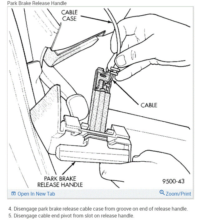

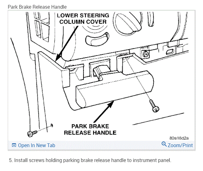

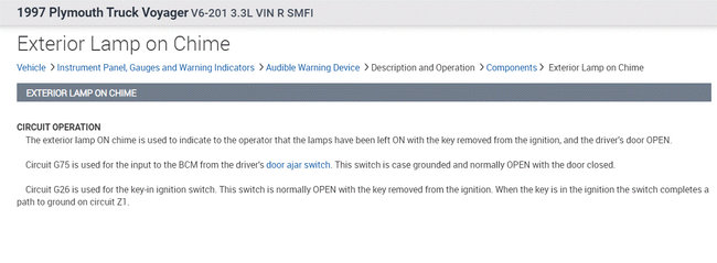

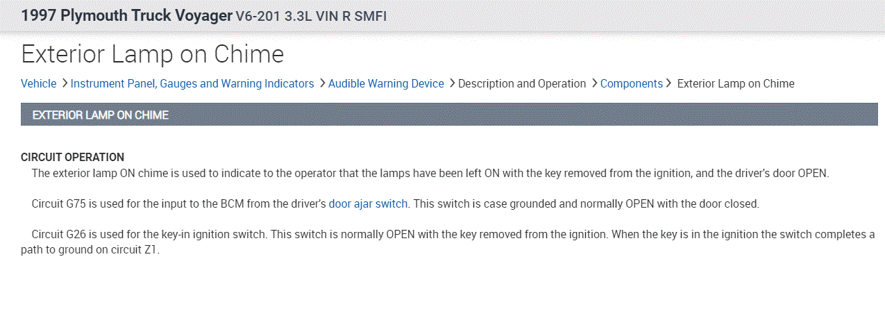

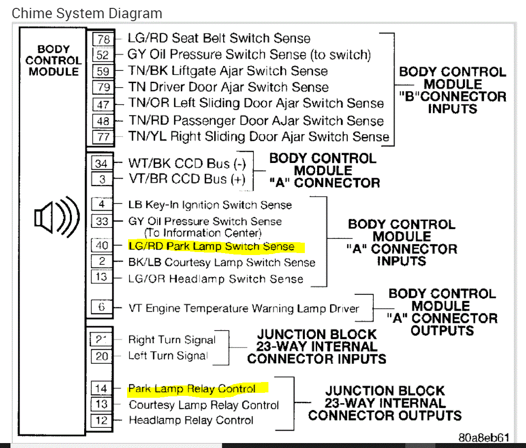

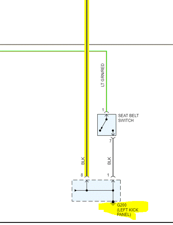

The warning chime is controlled by the driver's door ajar switch. That is what signals the body control module (BCM) if the lights are left on. The idea that the chimes stayed on regardless of the fuses, I have a feeling the BCM may be bad and shorting internally or there is a connection issue. Since removing the fuses does shut power (fuses both before and after the BCM) that tells me the problem lies between the BCM and the lights.

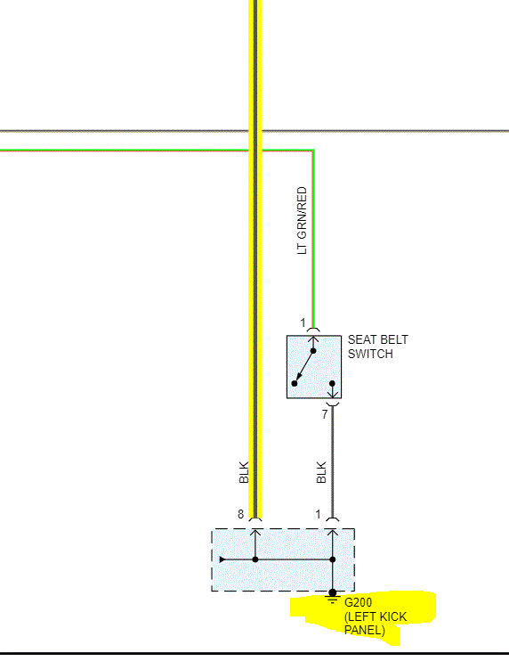

If you look at the pics below, 1 and 2 are specific to the warning chime. Pic 3 shows how the headlamp switch provides ground when the switch is on. So, either the switch isn't opening the ground circuit when off, the BCM is bad, or the park lamp relay is stuck on. See pic 4 for the relay location.
Did you check the relay itself (pic 4)? Since this is happening when the headlamp switch is disconnected, I suspect it is either the relay or the body control module itself.
Do one last check for me. The BCM ground for the parking lights is in the left kick panel. That is where you left foot would rest when seated. Check that ground Pics 6 and 7. If that isn't bad, I would suspect the BCM.

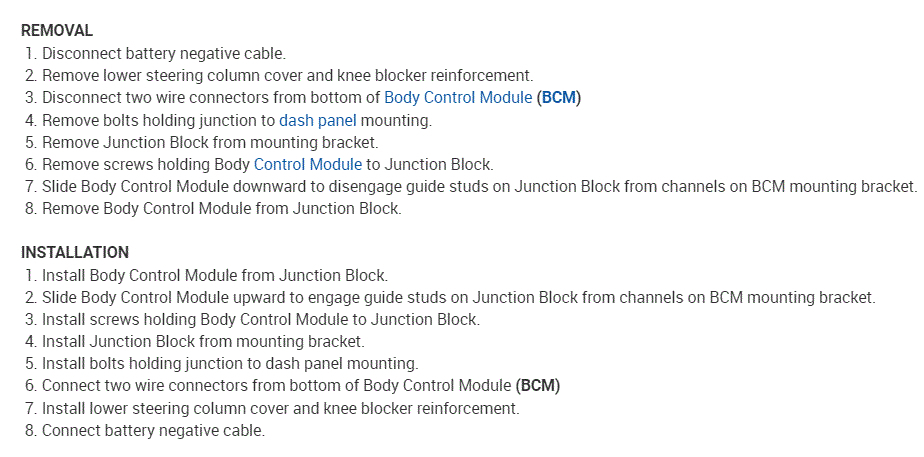

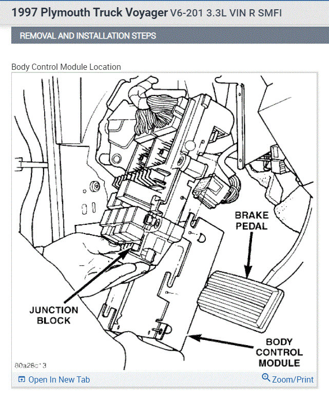

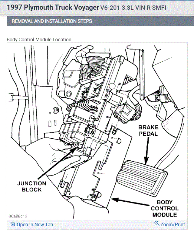

There will be a part number on the BCM. I did some quick research and found only one part number, but I could be wrong. Check out this site. They offer plug-and-play modules.
https://www.fs1inc.com/oem-bcm-body-control-module-plug-play-1997-plymouth-voyager-4686671.html
Please understand, I have absolutely nothing to do with that site, I just came across it. I don't want you to think that I or our site benefits from "selling parts" because we don't. See if you can find one cheaper that is plug-and-play. That way, you only have to remove and install it on your vehicle. The sites usually will ask for specifics such as engine size, VIN, transmission type, and so on.

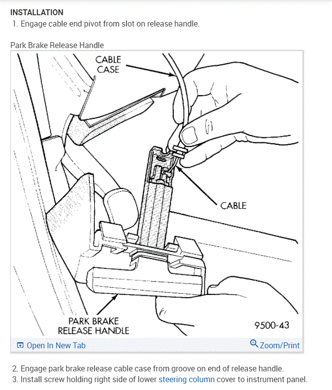

I attached directions below for the removal and installation.
I hope this helps. Let me know.

Okay, so i finally replaced the BCM from that Flagship One site you suggested. They were very good to work with.
